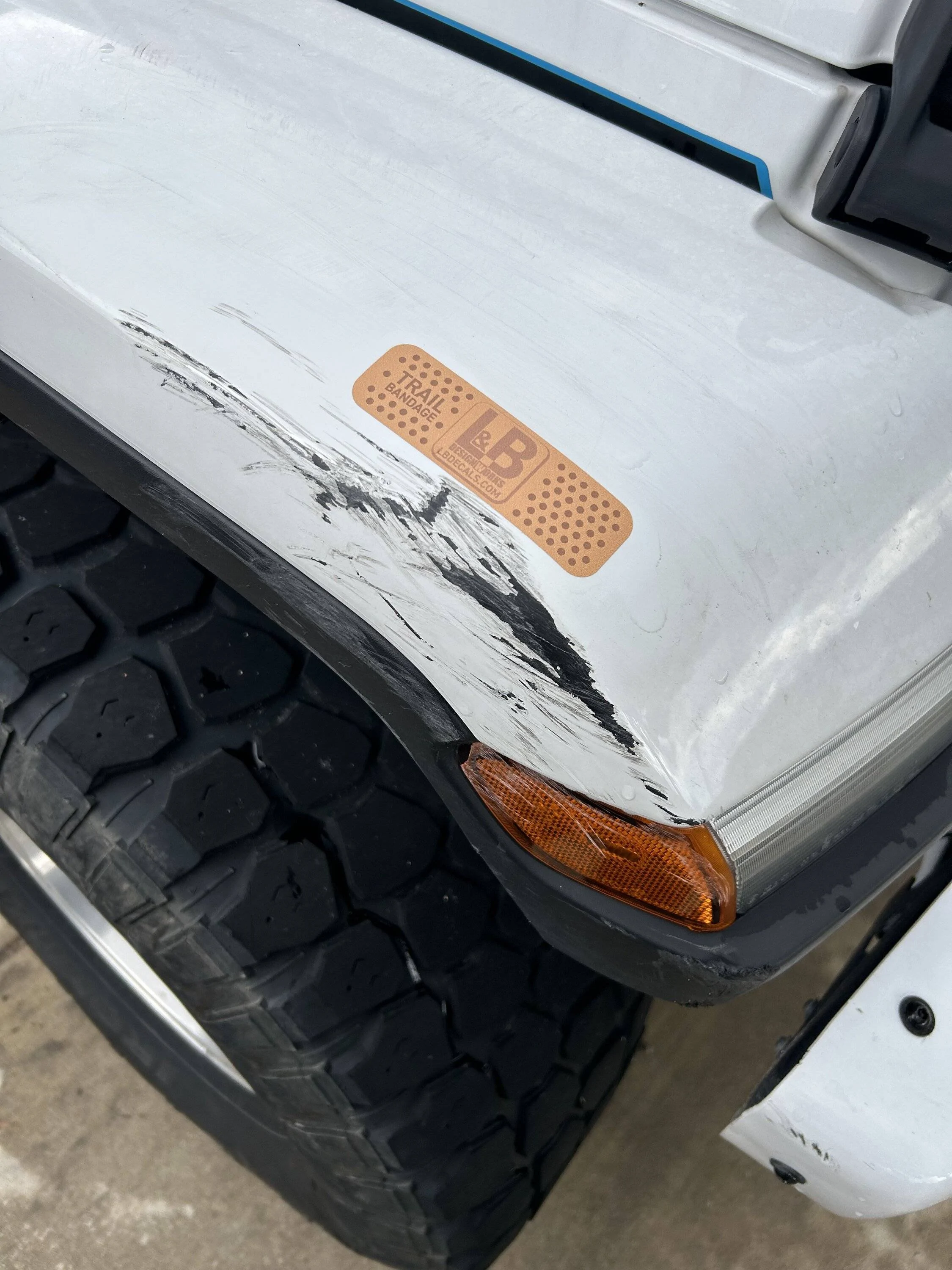

Nope, no debris for me. Just large boulders I can’t get around ?
gawd damn ?. so glad i didn't opt for paint match fender. proof she ain't no pavement princess tho.

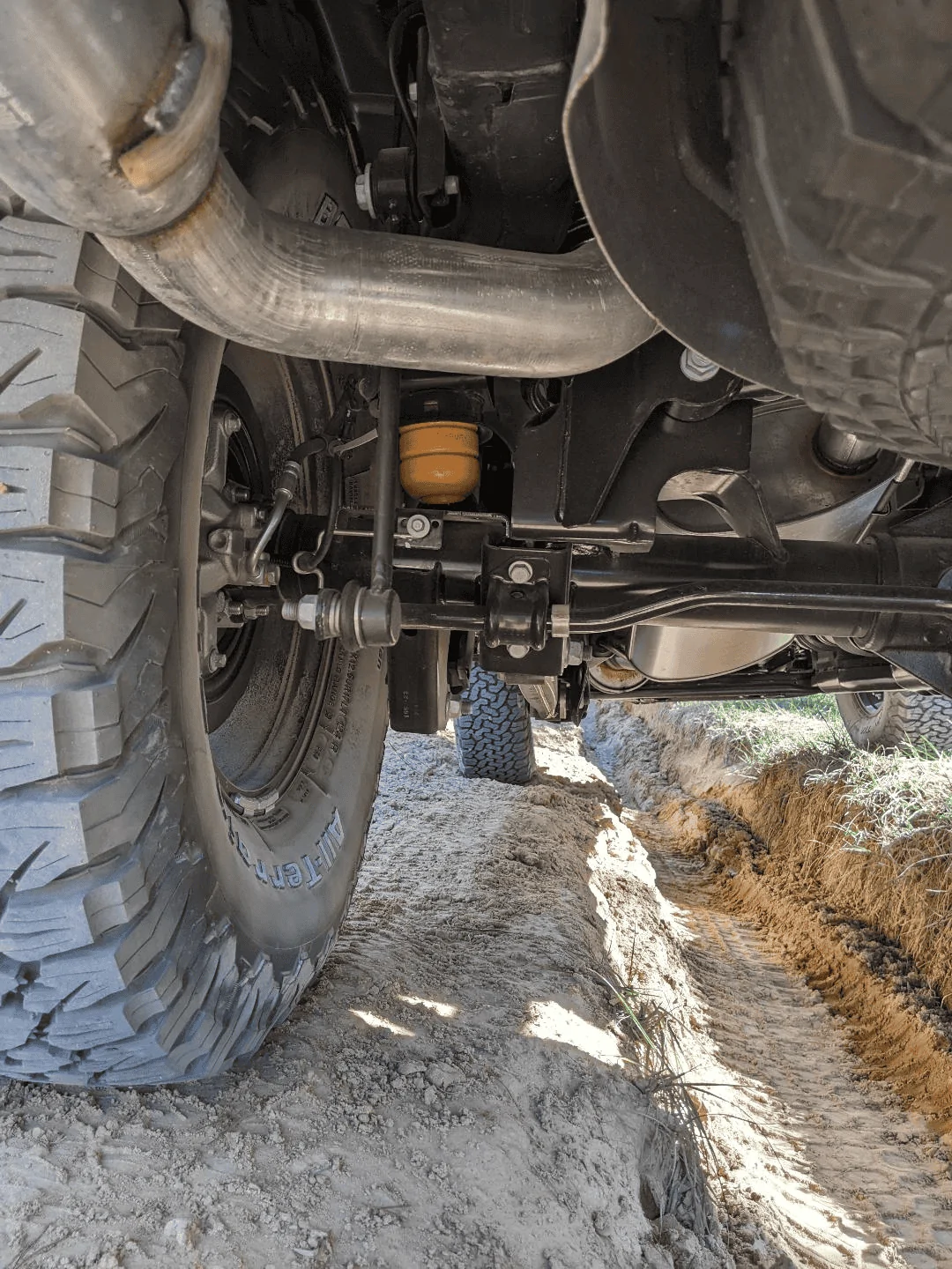

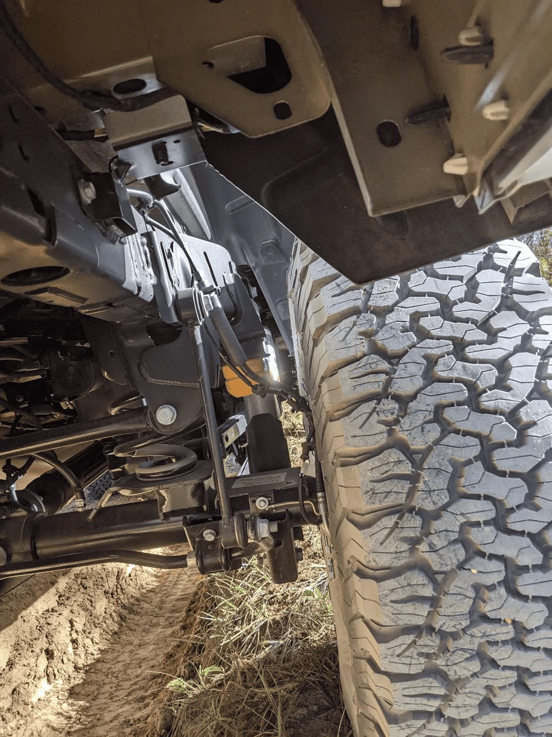

Rear fully stuffed
Jeep Gladiator Anyone else running 37s no lift? 1707843686658
Rear fully flexed
Jeep Gladiator Anyone else running 37s no lift? 1707843722229

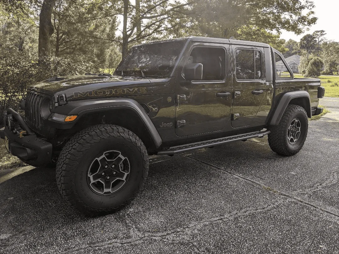

37x12.50x17 BFG KO2 on stock Mojave optional wheels. BFG's run a little small, I think mine measured out to 35-7/8". I don't remember. No lift. No rub. I trimmed the inner fender liner a little and added one washer on each side of the steering stops.

sweet! looks perfect fitment imo. my 37s measure 36.2, don't know if i need to do the washer thing or not. did u run spacer for those wheels? i ended up at 1in for stock sport wheels.

Yeah she does just fine out on the trails that’s for sure. The torque of the diesel in 4lo even without 4:10s and the better transfer case is unmatched. It’s nice having 30 less torque than a 392 in my little baby 3.0 v6 ?

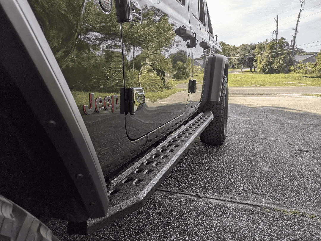

No spacers, everything is stock
