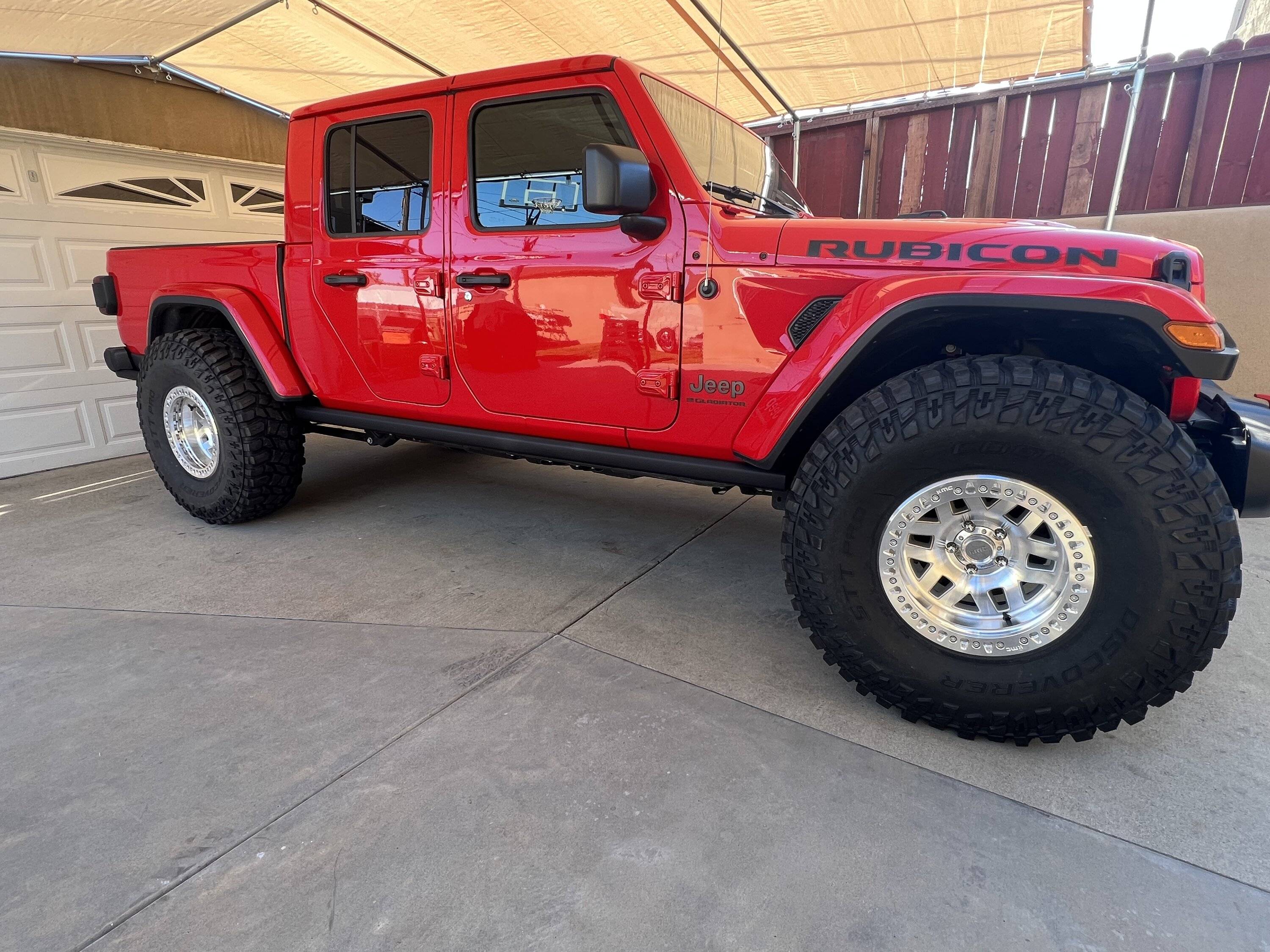

2023 JTR
'23 JTR w/ no lift. AEV Borah's and Kanati Trail Hog 37x12.50-17's. Just a little rubbing with the fender when turning to full lock. I do have the 2" AEV Dualsport lift on order to get a little more clearance in the wheel wells and the couple of inches clearance underneath. Have not regeared, that'll happen later this year.

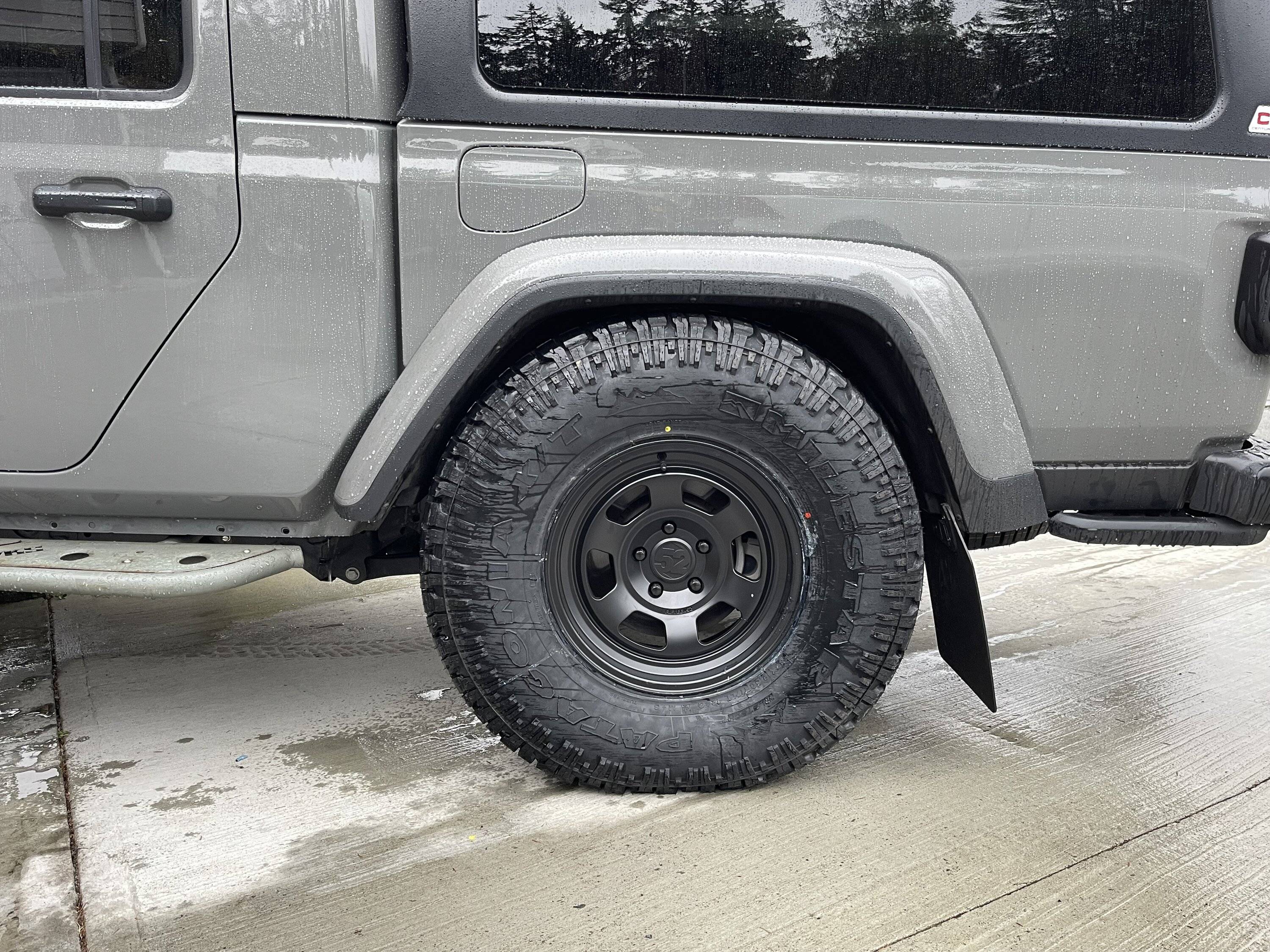

Hitchhiker
Yes they fit with no lift depending on wheel size and BS, but you need to bump so they don't contact the fenders at full stuff. That won't leave much uptravel for a smooth ride over rough terrain though.
This isn’t wrong, but I am going to add there is an exception- Diesel gladiators have longer bump joust tubes up front 1-3/8” longer??? (This is close someone will correct.) and may not need any front bump added. I do say may because tire size is different by every manufacturer and he is correct wheel size and offset/back spacing is critical…
37x12.5 Patagonia XT’s with 17x8.5 et0 will fit, full flex/ disconnected and “kiss” a small section of the inner liner, and the rear inner corner of the liner needs to be heated/bent inboard.
Rear has a kiss to the liners too, but with the amount of flex required, you will be crawling.
But to add to the above and what “can”. Be done with a diesel…. Diesel up travel sucks stock anyways and you can bottom out on pretty much anything…. So adding a leveling kit, or a Mopar lift with leveling kit, just makes the ride that much nicer….. so yeah- order your 37’s :) convince the wife a lift is needed after the fact ???
not finding a full tuck front photo- but here is a rear, stock height…
For reference- when you are “checking” up travel flex with new components and stock bump stops- you should pull the foam joust pads out…. Slowly flex metal to metal in order to guage a full compression hard bottom out…. The foam pads will compress entirely if you hit something hard enough- so check it right. Below is bump pad removed.

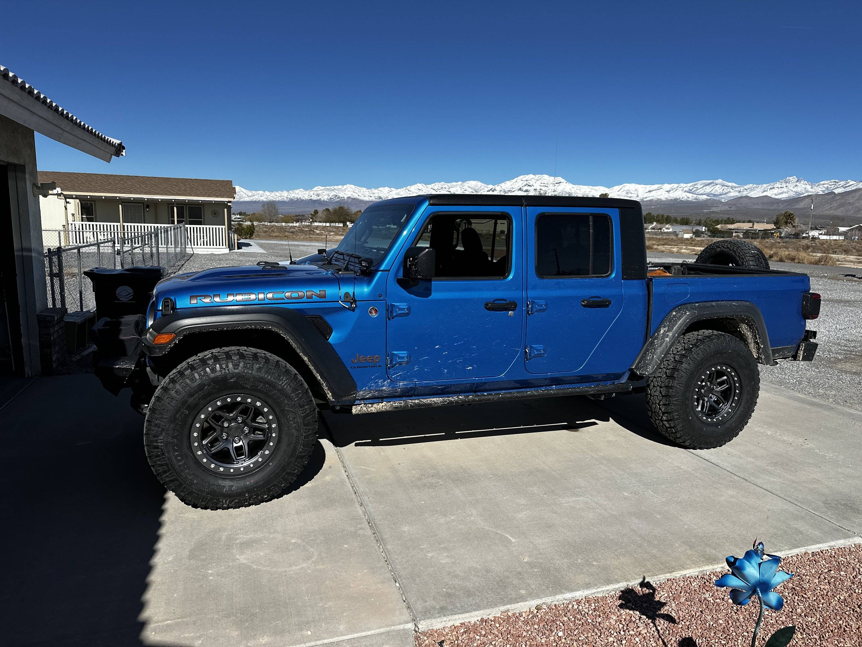

Screw 37’s………… 40’s with no lift…… I don’t need no stinking lift :)
GAWD DAMN BROTHER. stock bumper too?! absolute CHAD. :muscle:
