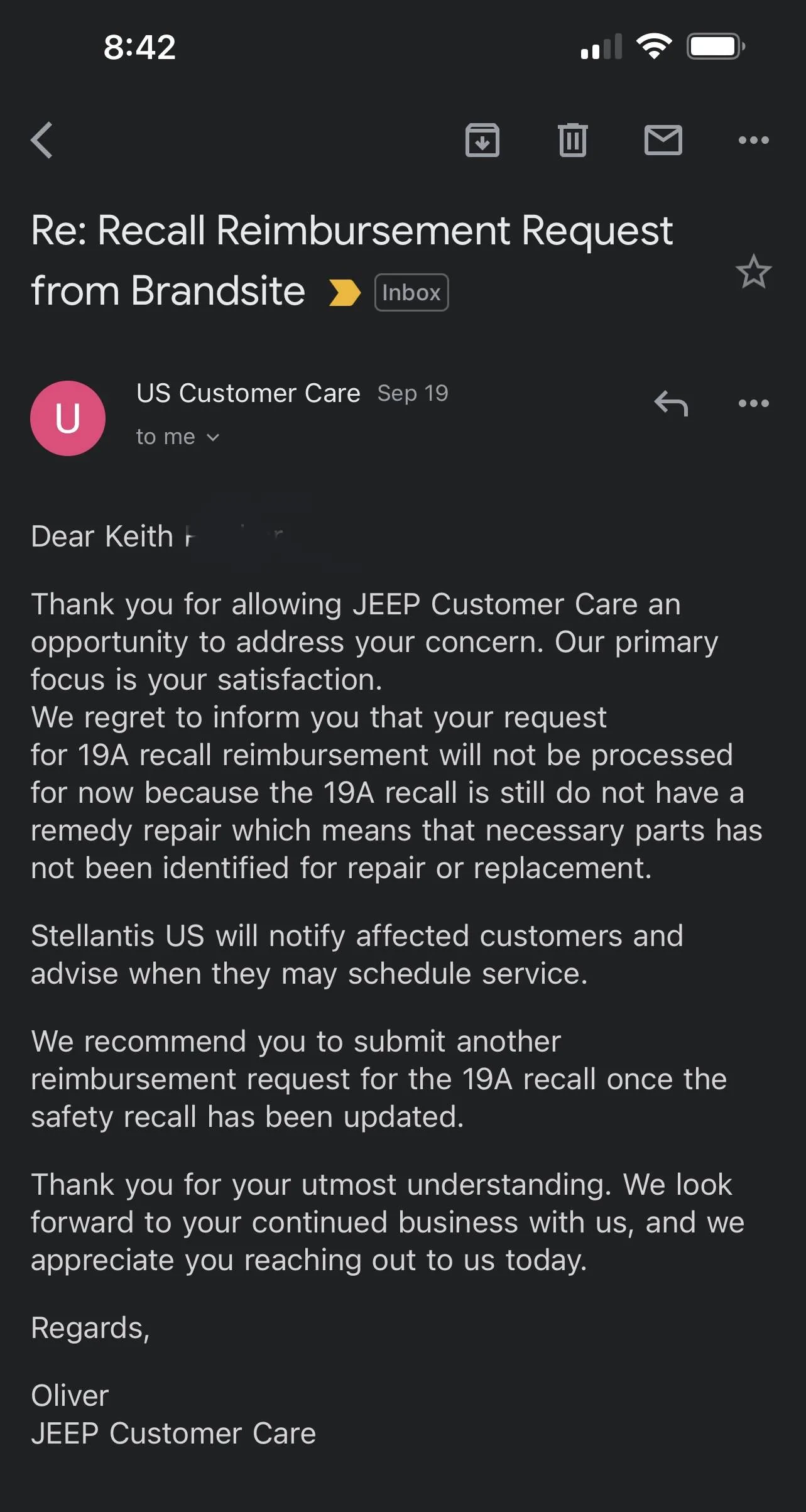

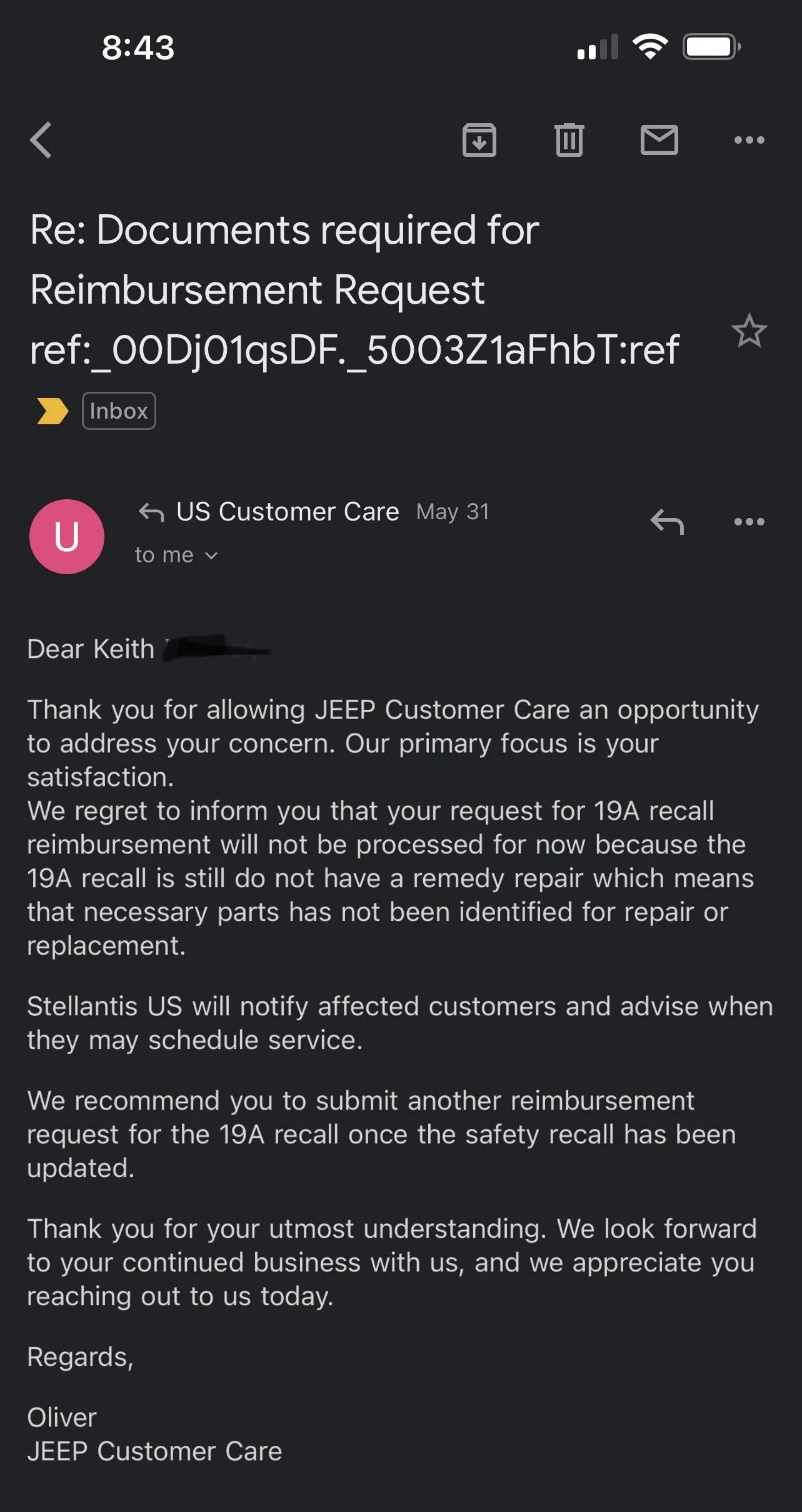

I called the FCA recall center back in May and spoke to a rep there who assured me I would be fully reimbursed for aftermarket parts and labor as long as the clutch replacement was done at a certified Jeep dealership. He also told me that Jeep would have replacement parts on September 5th. So not wanting to wait 4 months, and being told that I would be fully reimbursed, I ordered the ACT clutch and had my local dealer install it. Total cost was just over $3k. When I submitted for reimbursement, I was denied.
I submitted another request for reimbursement last week, and got the same denial email back.
I even have the conversation with the FCA rep in May recorded, but unfortunately @JeepCares does not care and will not take responsibility for what their recall center reps are telling customers. I’ll try again once they officially announce a fix, which I guess hasn’t happened yet?

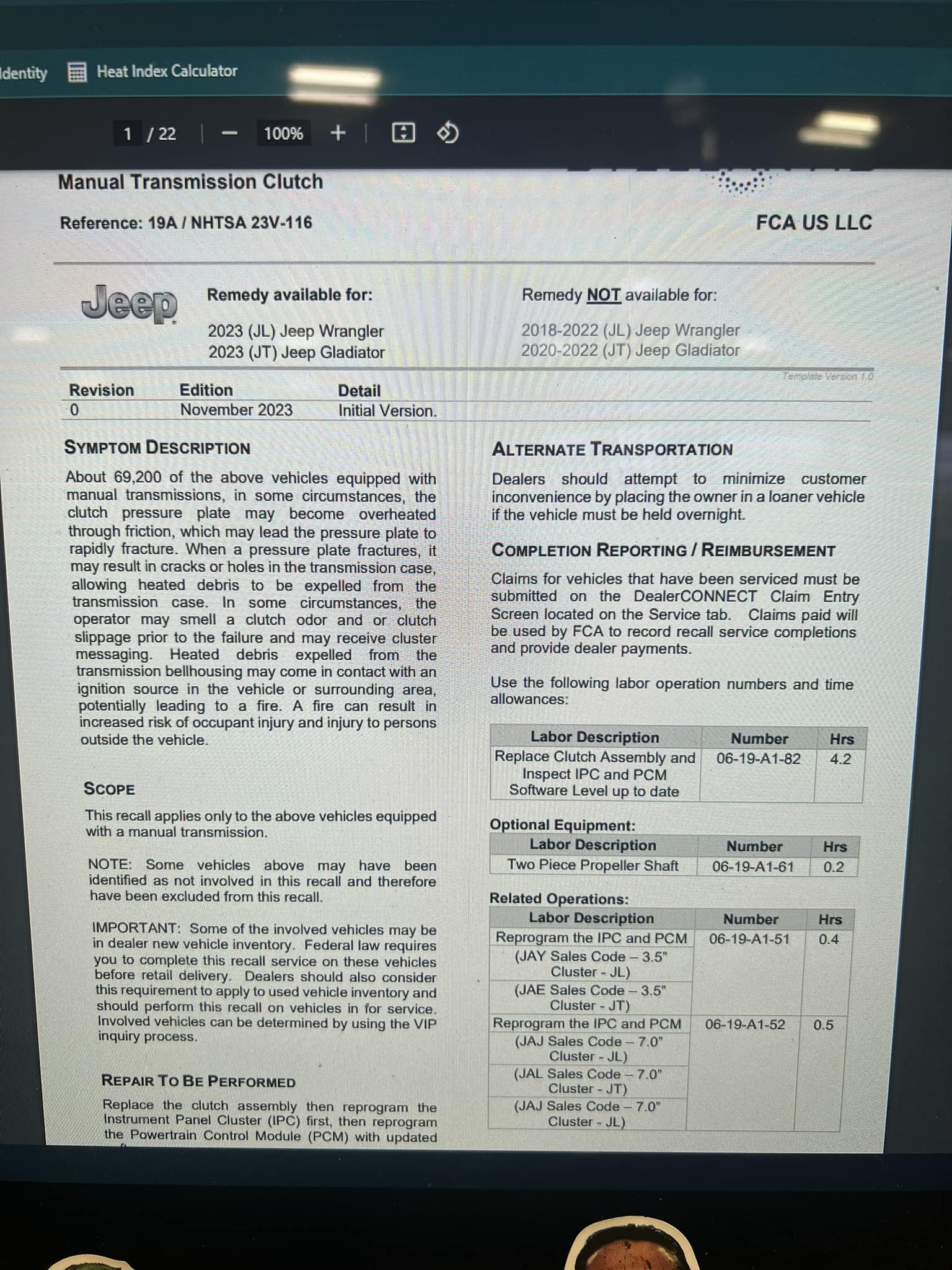

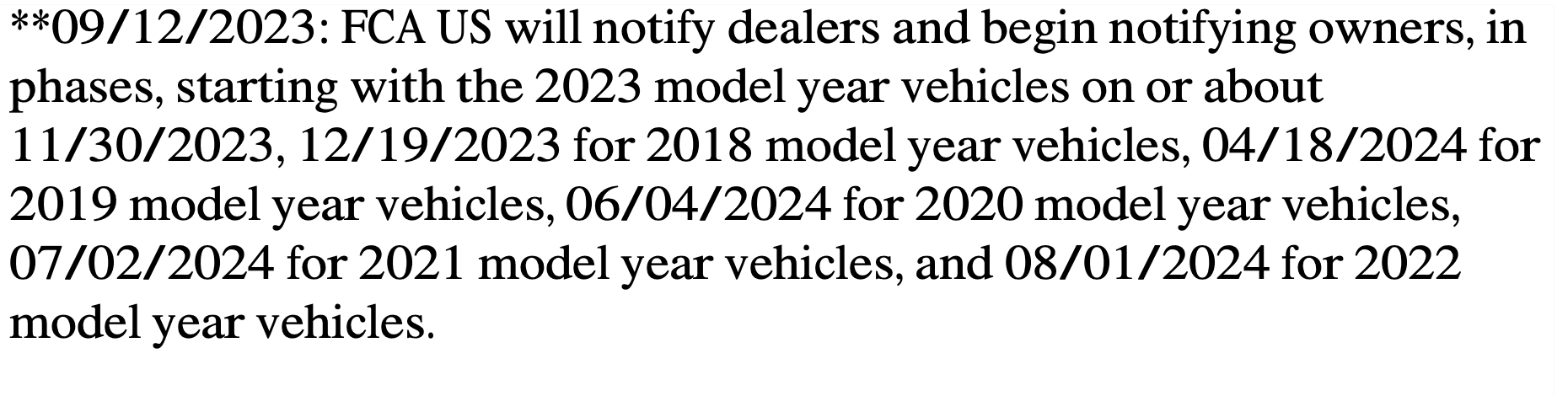

I bet they're trying to 'fix' the '23 MY first to get them off the lots
The fact that they're estimating next August for a '22 solution is insane...
F'n July for '21? Well over a year, Jeep. Do better.
If I could just get them to install my ACT as an actual replacement, I'd consider it a win.

My hope is that enough owners already replaced with Centerforce/ACT etc. so that it speeds up the process. I also want to throw in a Centerforce, but am unsure if I'll get a reimbursement so I'm trying to hold out, but we'll see...
