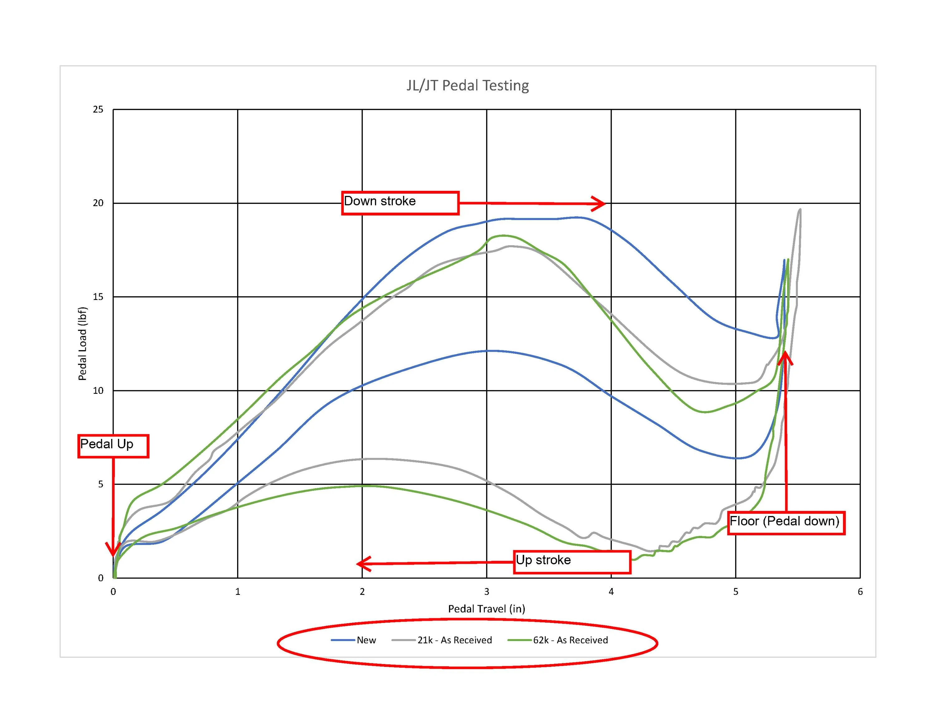

17-19lbs is really light for a clutch pedal, but the return stroke concerns me more. We have measured less than 2 lbs on the return stroke pushing against your foot which is hardly enough to feel. See tests from 3 different Jeeps:
Jeep Gladiator Clutch Recall (2/23/23): Clutch Pressure Plate May Overheat -- Affecting 70,000 Manual Jeep Wranglers and Gladiators JL JT Pedal stock
Ok, but when I'm talking about feel, I'm talking about more than just the clutch itself, but the entire feel you get when you engage it and make the vehicle move. I've had no trouble with precision in tight spaces, on hills, pulling my boat, or whatever. No stalls, no surprises. It's light, but consistent. Maybe I've got a sensitive foot/leg. But friends and family who drive my Jeep seem to have no trouble, either and don't complain about it. My kids, who are beginners and learned on my JK have no trouble with it, either. My 16 y/o girl actually prefers it to the JK.
Clearly it bothers some. I've not driven another. Only mine. Maybe mine somehow was right from the get-go. But I bounce every week from JK to JL to Corvette. No issues going from one to the other and back.
Is the level of consistency between the 3 Jeeps in that graph unusual? Seems to be one that is an outlier, if I read it correctly.

Let me explain the graph a bit more. The blue lines (the outlier) represent testing we did on a brand new Jeep on the showroom floor. The gray and green are after 21K and 62K miles, respectively. Both were fair-weather cars btw. The difference between the down stroke and up stroke is friction. The pedal is always going to be stiffer going down that up since friction adds to the load going down and subtracts from the load going up.
The total amount of friction over time on the JL/JT is not that unusual, but the amount of friction versus load is. The pedal is still very light going down but is in fact over 6 times stiffer going down than returning at the middle to lower part of the pedal travel.
I didn't find the stock JL/JT clutch difficult to manage either. You just have to adjust to referencing pedal travel, and forget about pedal load in order to drive it.
So this is all about the spring force, not the friction material, the wear, the throw out bearing feel or anything else.
