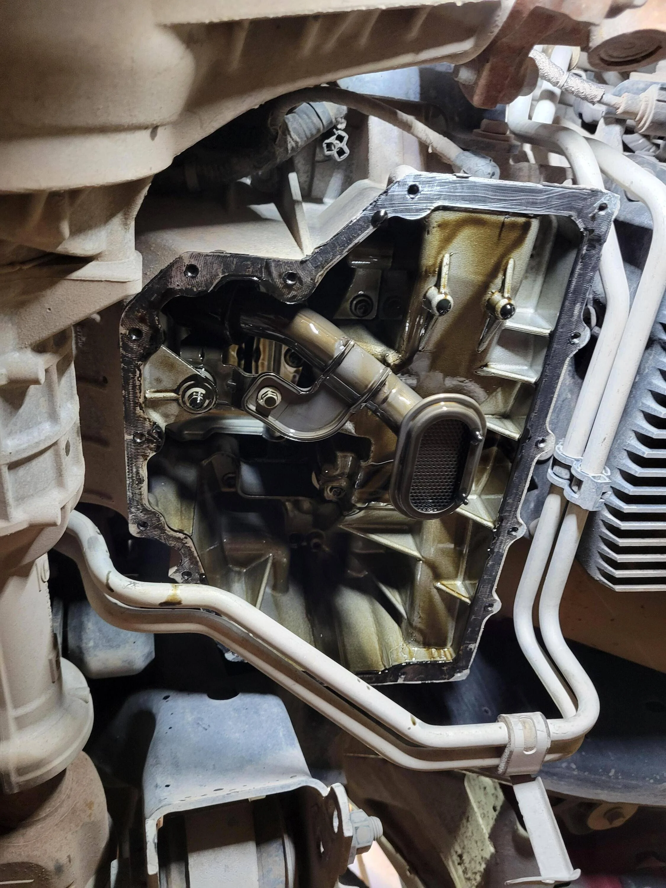

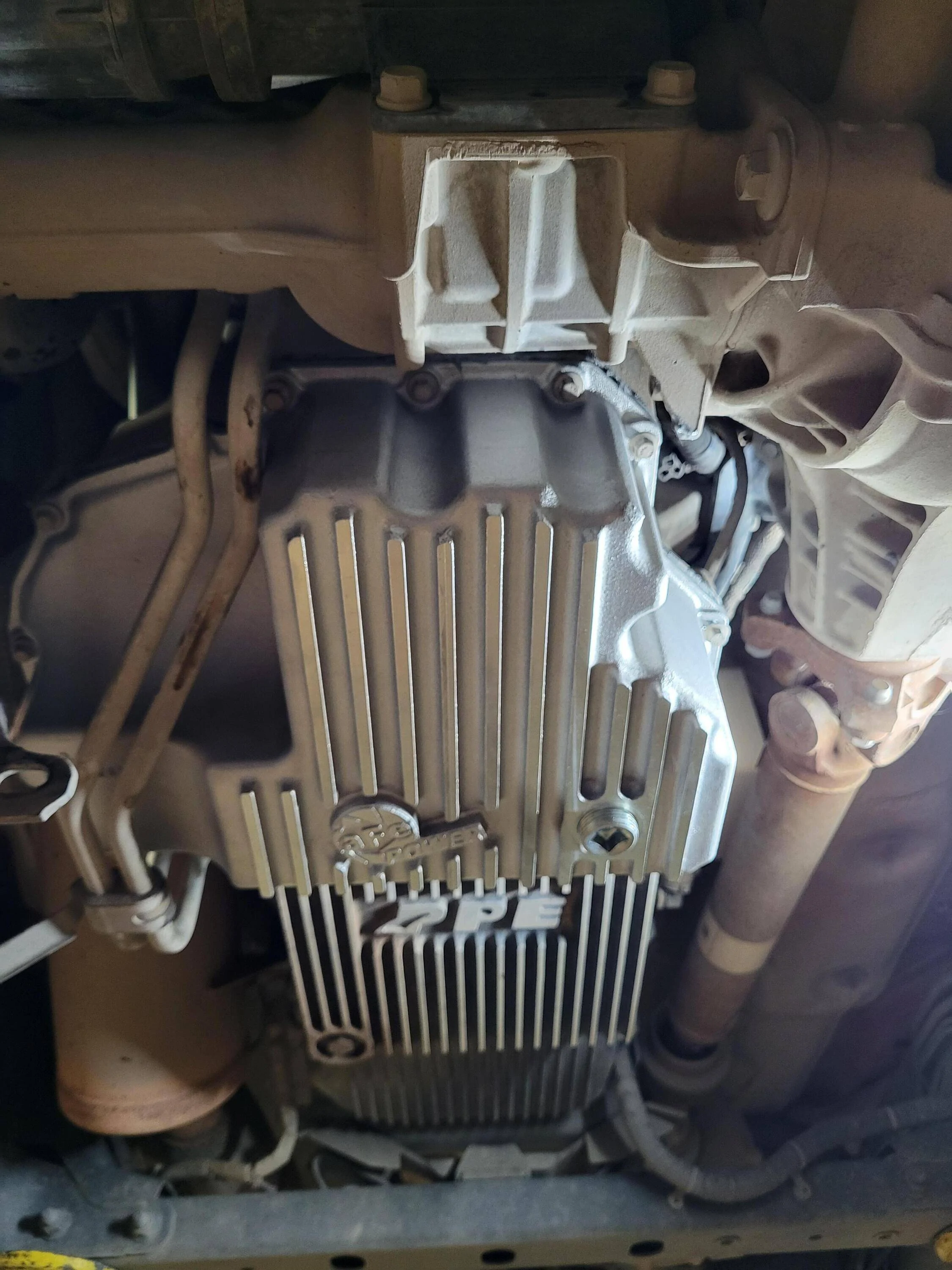

They make bigger oil pans and there was one for sale here , shipped the wrong one for his gasser, look for @KrashEd ….jack
I looked him up, it was a transmission pan … not the engine oil pan … the tranny never gets over 202 degrees.
The deep oil pan is only for the 2014 - 2019 EcoDiesel. I have one on my 2015, which now is a 12-quart capacity.
