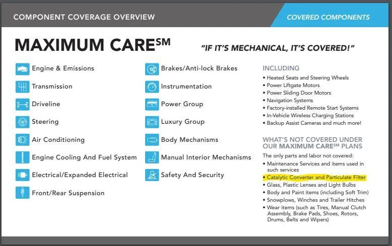

Longer warranty? Powertrain is covered for 5y/100k. They sell a longer one?
You can pay for an extended Powertrain Warranty, but you have to read the fine print. Ram offered me an 8 year/125,000-mile Mopar Max Care Powertrain Warranty but it doesn't cover some diesel parts such as the EGR Cooler and DPF.

part of me is entertaining buying a super long Mopar warranty and GDE tune (I already have the cloned PCM).
You can pay for an extended Powertrain Warranty, but you have to read the fine print. Ram offered me an 8 year or 125,000-mile Mopar Max Care Powertrain Warranty but it doesn't cover some diesel parts such as the EGR Cooler and DPF.
I have a 7 year/100,000-mile bumper to bumper warranty on the 2023 Jeep Gladiator. I'll hit 7 years before I hit 100,000 miles, but at least I've got some protection for 7 years.

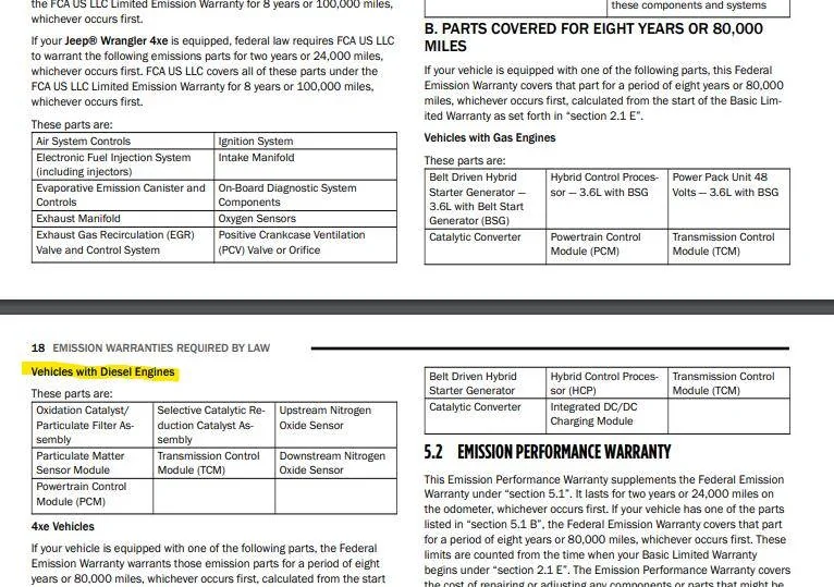

I was looking at the extended warranty just for the emissions coverage but found that it does not cover any of the EGR or DPF equipment and is specifically excluded from it and from the oem powertrain warranty. I tried finding the actual PDF for Maxcare but couldn't locate it but actually list all exclusions.
Jeep Gladiator Diesel cooling options and ideas {filename}
That’s great info for myself and the rest of the readers here … pretty cheesy they exclude it from the maximum care, in my mind maximum care was bumper to bumper. GUESS NOT!
I’d argue that value still, DPF is just one part of this whole emissions stack.
That's correct and what I said in the post you quoted.
The EGR Cooler is covered under the standard 3 year/36,000-mile bumper to bumper warranty, however, the DPF is covered under the 5 year/100,000 mile powertrain warranty.
If you buy the extended bumper-to-bumper warranty, then the EGR Cooler is covered, but only up to 100,000 miles. My 7 year/100,000-mile bumper-to-bumper warranty covers the EGR and DPF for that length of time. It's when you extend your warranty to 115,000 miles or 125,000 miles is when they do not cover the EGR Cooler and DPF.
It gets confusing because there are different types of Max Care warranties.
I could be wrong but I don't think they offer the Bumper to Bumper warranty anymore. They may call it bumper to bumper warranty but it definitely is not as their is always that fine print. We looked at it for my wife's 392 and got it but opted out for my Gladiator as their were a lot of exclusions on what it would not cover on the Diesel's.
There are different types of Max Care, which is where much of the confusion comes in. There's the standard Maximum Care, Added Care Plus, Powertrain Care and Powertrain Care Plus. My dealer uses the bumper-to-bumper language so that I can better understand what he's talking about, but that's not what it's called in the system.
When we bought our Jeep in April, they had a 'bumper-to-bumper' for up to 8 years/100,000 miles. I paid for the 7 year/100,000 mile since it was a fairly hefty jump to add the additional year, or at least I thought so at the time. But I was told that the bumper-to-bumper coverage in the extended warranty stops at 100,000 miles. The diesels can be warrantied up to 125,000 miles, but that's when even more parts are excluded.
I know that Mopar changed some of their warranties back in the summer, but I don't know what those changes are. So perhaps the bumper-to-bumper has been further restricted.
I also have a 5 year/100,000-mile bumper-to-bumper warranty on my 2020 Ram EcoDiesel. The dealer called it a 'wrap'. That's where they take the factory 3 year/36,000-mile bumper-to-bumper and wrap it into the 5 year/100,000-mile warranty.
I also had the same 5 year/100,000-mile bumper-to-bumper on my 2015 EcoDiesel. I had the EGR Cooler replaced at around 40,000 miles, but since I had the extended bumper-to-bumper warranty, it was covered.
Also worth noting, the bumper-to-bumper also covers a rental. And according to my dealer, they are supposed to give me a rental that matches what I'm driving. So, if you can believe this, the first time they got me a 2500 Hemi from Enterprise. The second time, Enterprise didn't have any trucks, so they let me loan out a new 2500 Cummins.

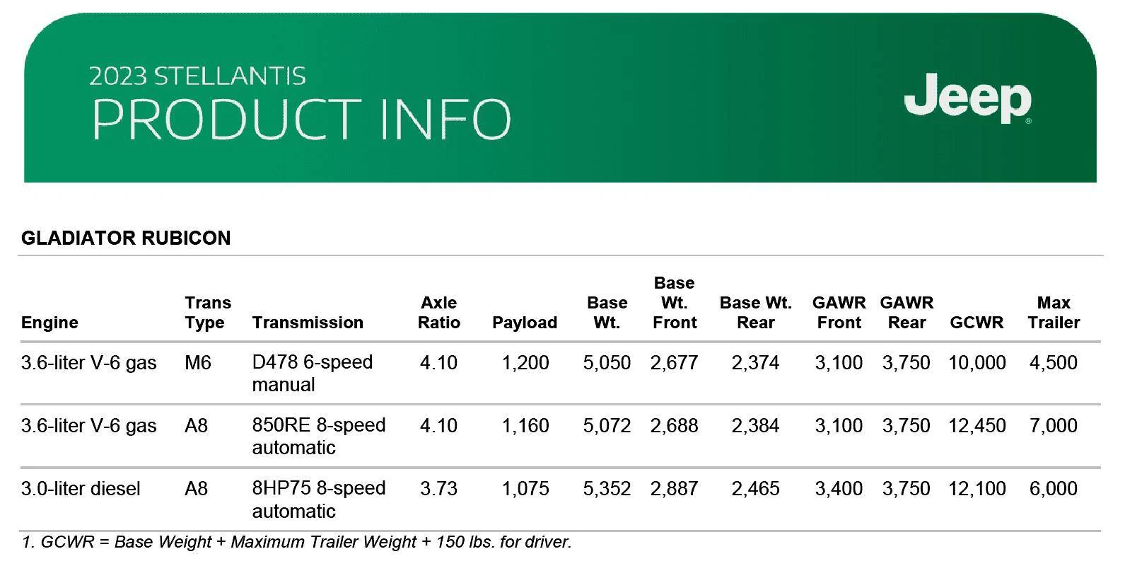

Generally speaking, I encourage people who plan to do a lot of towing to stay within 70% of the maximum rated capacity to ensure a positive towing experience. The 3rd gen EcoDiesel in the Jeep is unique in that the maximum tow rating is limited by cooling rather than the axle, suspension, chassis, etc. It was the same way in the 2014 - 2019 Ram trucks. The Hemi had a higher tow rating than the EcoDiesel simply due to cooling restrictions.
Staying within that 70% capacity is more of a guideline than a rule, but it does give truck buyers a good starting point when choosing trucks and trim levels. For example, my 2023 Rubicon EcoDiesel is rated for 6,000 lbs of towing capacity. If I were to follow the 70% guideline, then I would want to keep my towing loads at 4,200 lbs or under.
I don't want to pick on @steelponycowboy too much, but he claims to only be towing 2,600 lbs. But if you look at his Rubicon, he's running a lift kit with taller (heavier) tires. Both of those deviations from the factory specification are not ideal for towing and running cooler temperatures. He also has some type of camper shell/rooftop apparatus in his profile picture that will further add additional strain to the engine. It would be interesting to know what his payload is when towing.
