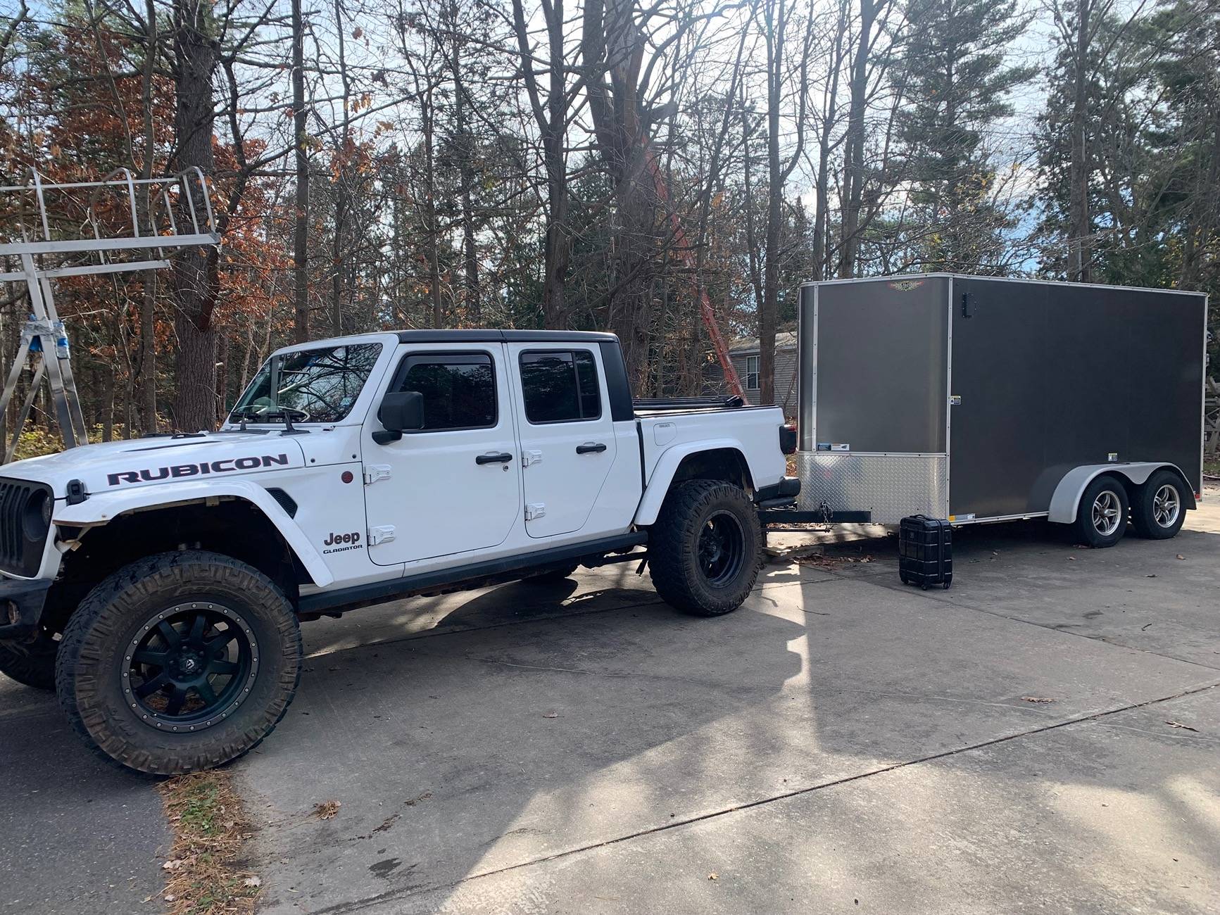

Jul 20, 2016
243
321
MN
2005 LJ Rubicon
Just drove this heavily loaded 16ft enclosed 1700 miles averaging 70/75mph getting roughly 12/13mpg and didn’t even get close to derating(oil temp maybe hit 250 once or twice). No cruise control and had to manually select the gear time to time but no problems.
