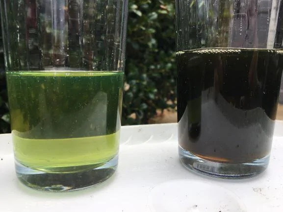

Yes Absolutely, I would not wait that long personally based on the color of the oil droplet on your rag.
You can't judge the quality of fluid based on color, especially when the factory fluid is dark green.
I would not say dark green more light to medium green based on the picture. The black oil is 50k miles.
I am not referring to the quality of the oil but the condition as it relates to these factors that it may be a sign that the fluid hasn’t been changed in a long time, it can become heavily contaminated with dirt, dust, high heat and friction and other pollutants. This can cause the fluid to darken and lose its effectiveness. Over time, the fluid becomes less effective at lubricating and cooling the transmission components, even if it doesn't show immediate problems. Smelling it can also help show if it has been burnt.
