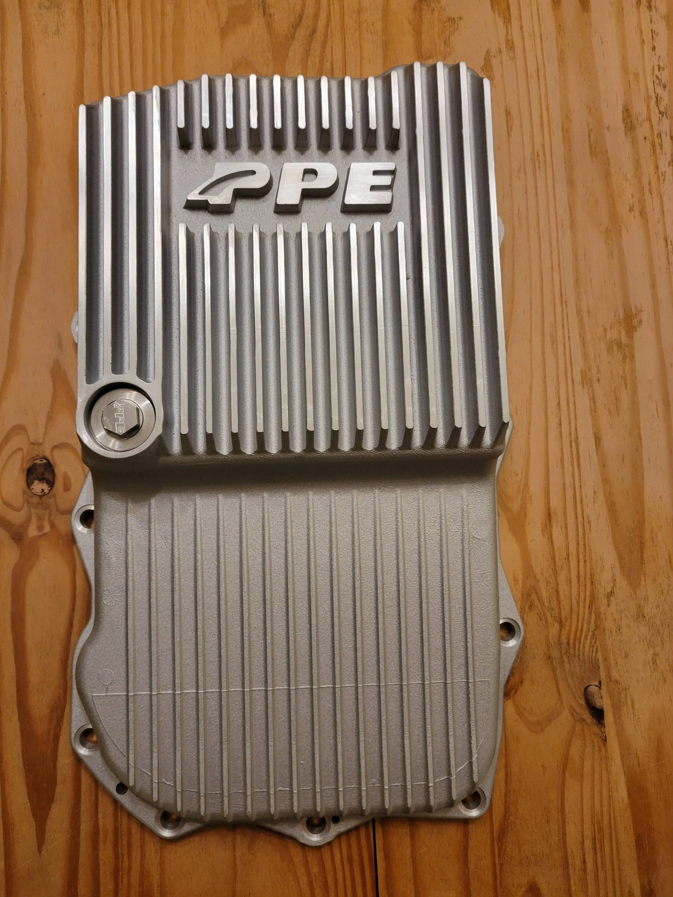

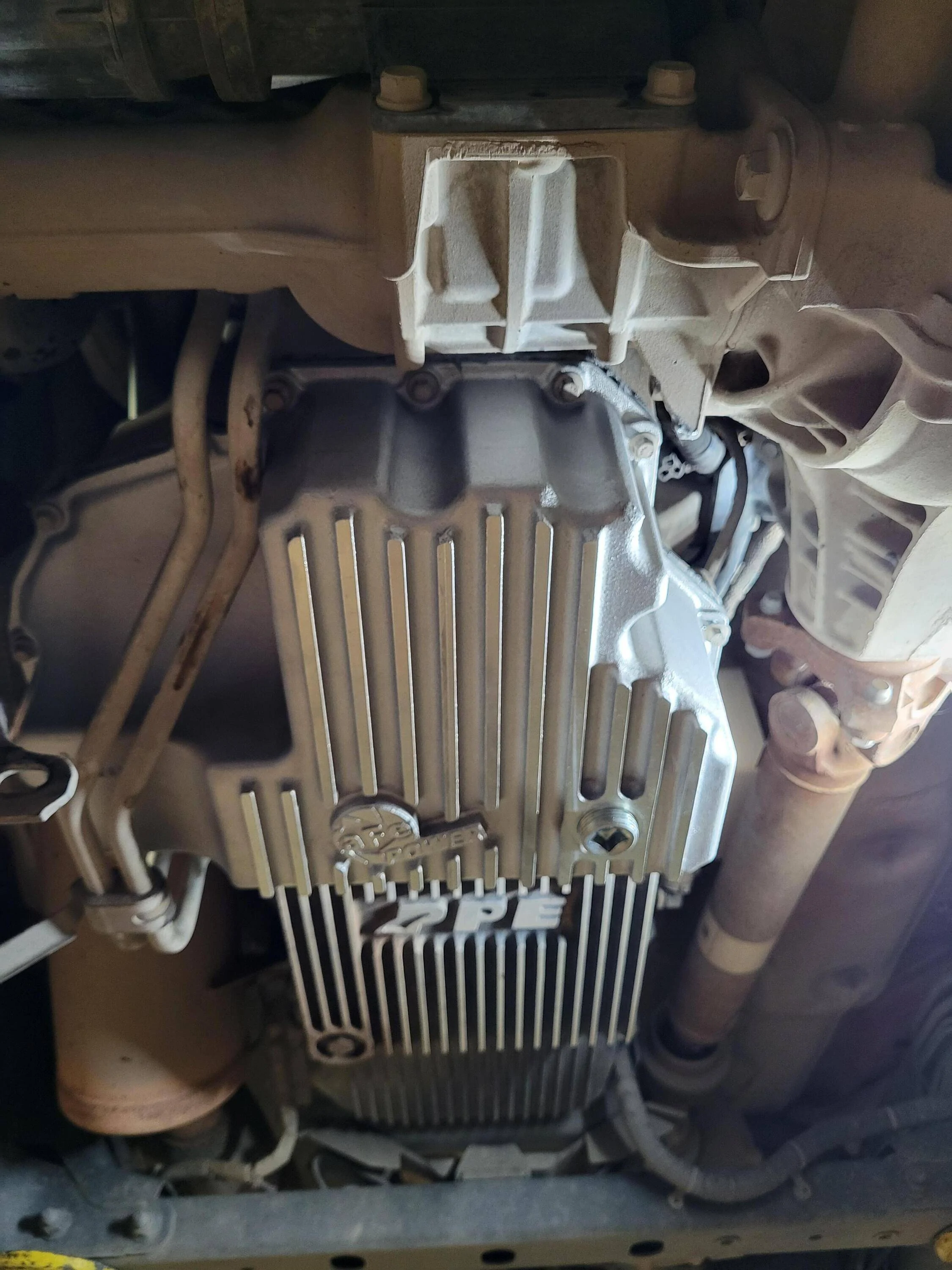

PPE makes a transmission pan for the ZF Transmission. I have one on my 2015 and 2020 Ram EcoDiesel.

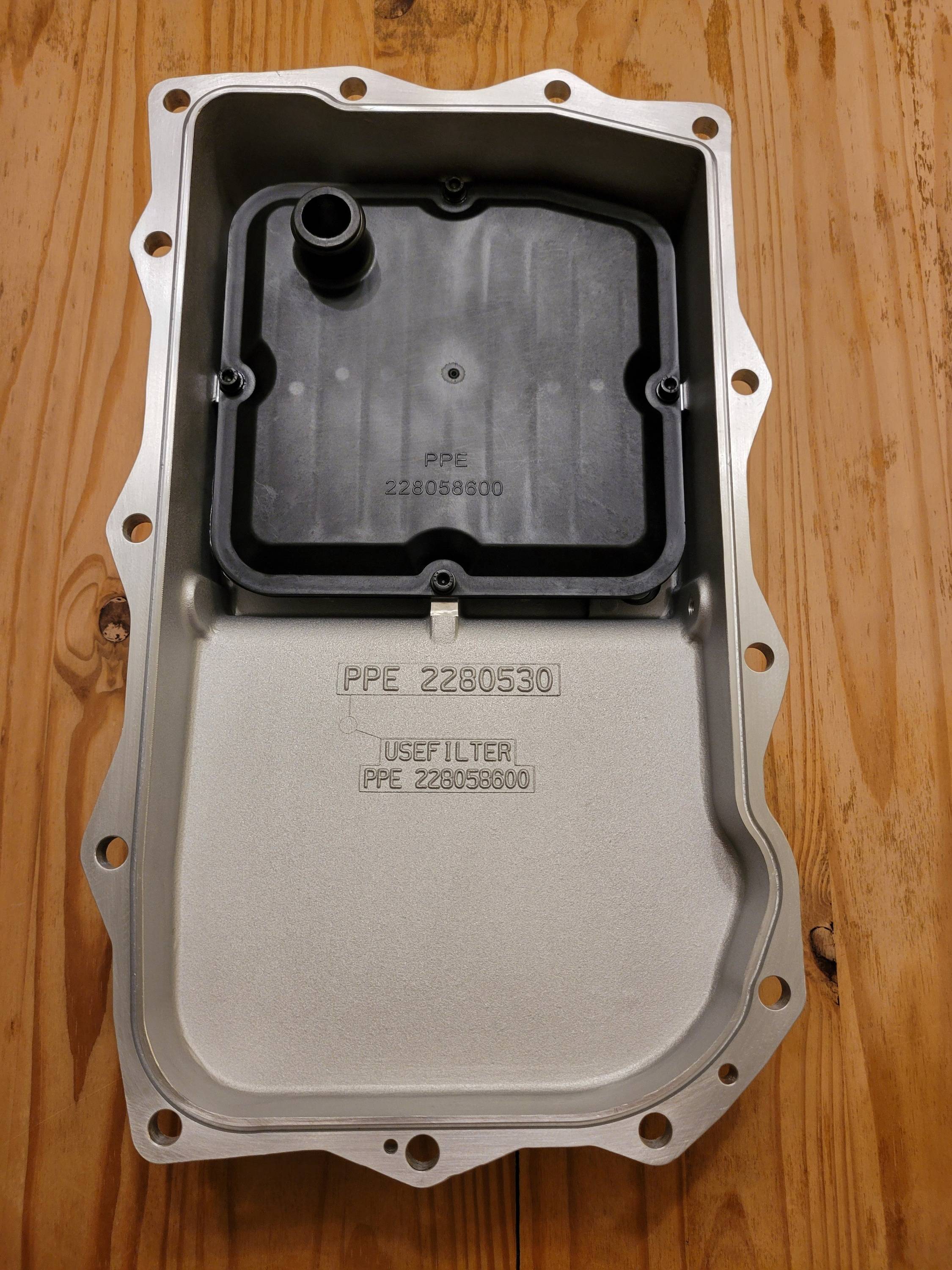

I’m assuming the pan is aluminum and only magnet is the drain plug? Can other magnets sit under the filter and be held in place by the filter?
Do you have to grind the cooling fins for the exhaust pipe?

The stock pan is metal at least and has 2 magnets. The PPE is 1 magnet. The other issue is that it will take longer to heat the trans oil temp. That will make it more inefficient.
On the other hand you get more oil capacity and more cooling. Personally, I would only run this if temps are more then 205f with using the mishimoto trans cooler first. The oil it self can take more heat but the trans internals I fear get damage when you run much over optimal.
Yes.
Yes, you can epoxy magnets to the bottom of the pan. The pan is deeper than the factory pan and holds an additional 2 quarts.
No grinding. These pans fit the Ram 1500, Jeep Wrangler, and Jeep Gladiator.
The other benefit is the ability to perform drain and fills without having to drop or replace the pan. This makes maintenance much easier, quicker, and more cost effective.
You still need to drop the pan to change the filter. But the drain plug would make it less messy.
Personally I wouldn't change fluids without changing filter.
I perform a drain and fill every 45,000 miles, but only change the filter every 90,000 miles.

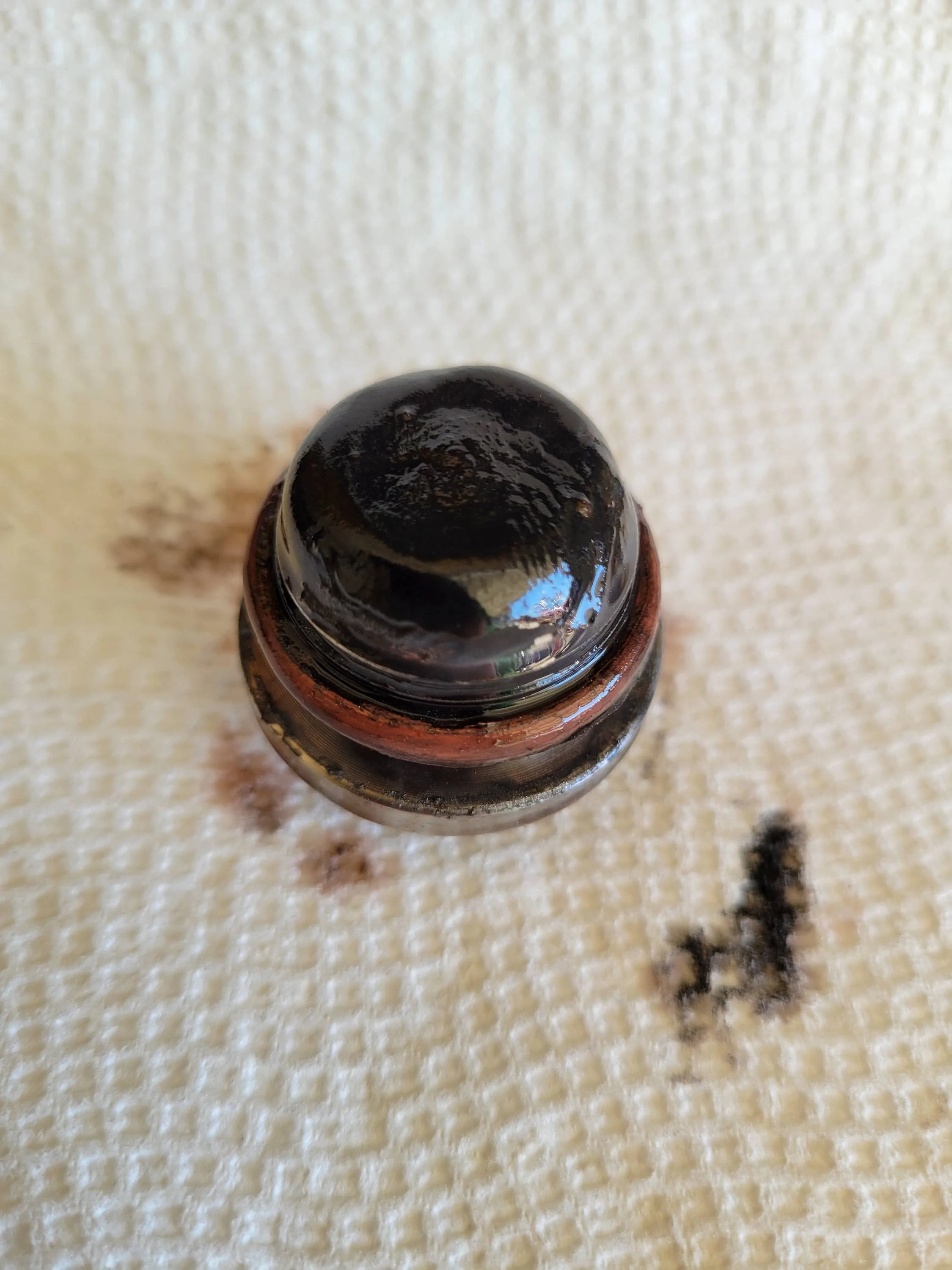

I just had the transmission fluid changed on my 2015 and 2020 Ram EcoDiesel yesterday. Here's what the PPE magnetic drain plug looked like. That's a fair amount of metal sludge.

I just had the transmission fluid changed in my 2015 and 2020 Ram EcoDiesel yesterday. Here's what the PPE magnetic drain plug looked like. That's a fair amount of metal sludge.
Your waiting to long. I would say change sooner and keep a nice color on the fluid.
Adding Another magnet would be a good idea.
