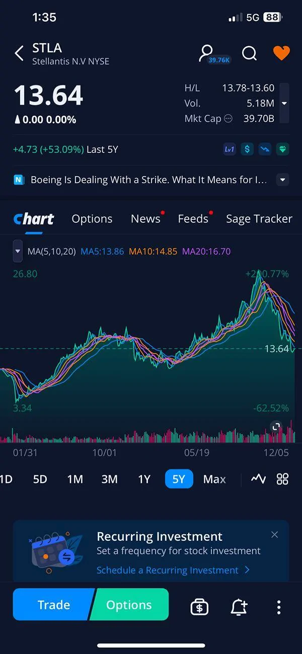

I have nearly 50K in adds but am now pursuing a federal lemon law action against Jeep which won't require a buy back but will result in a cash settlement
Good luck…. My understanding is their financial position is currently rejecting all buy backs, period, a cash settlement isn’t looking much better….
Stock price isn’t the lowest it’s ever been, but uhhh, yeah ;)
