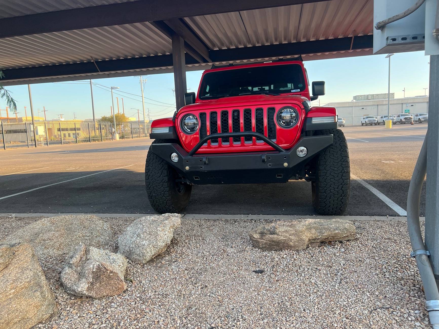

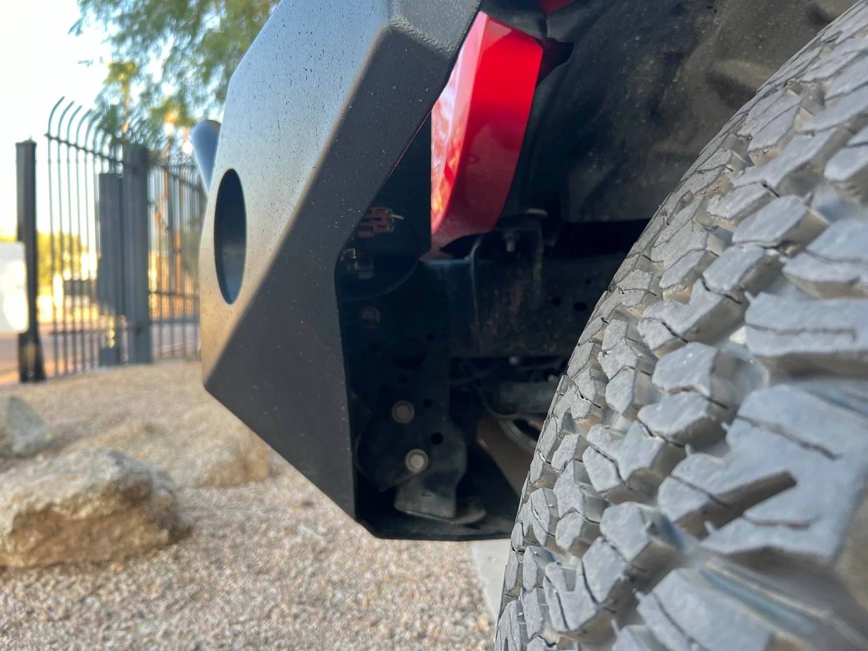

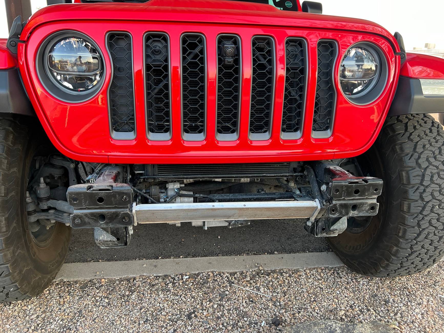

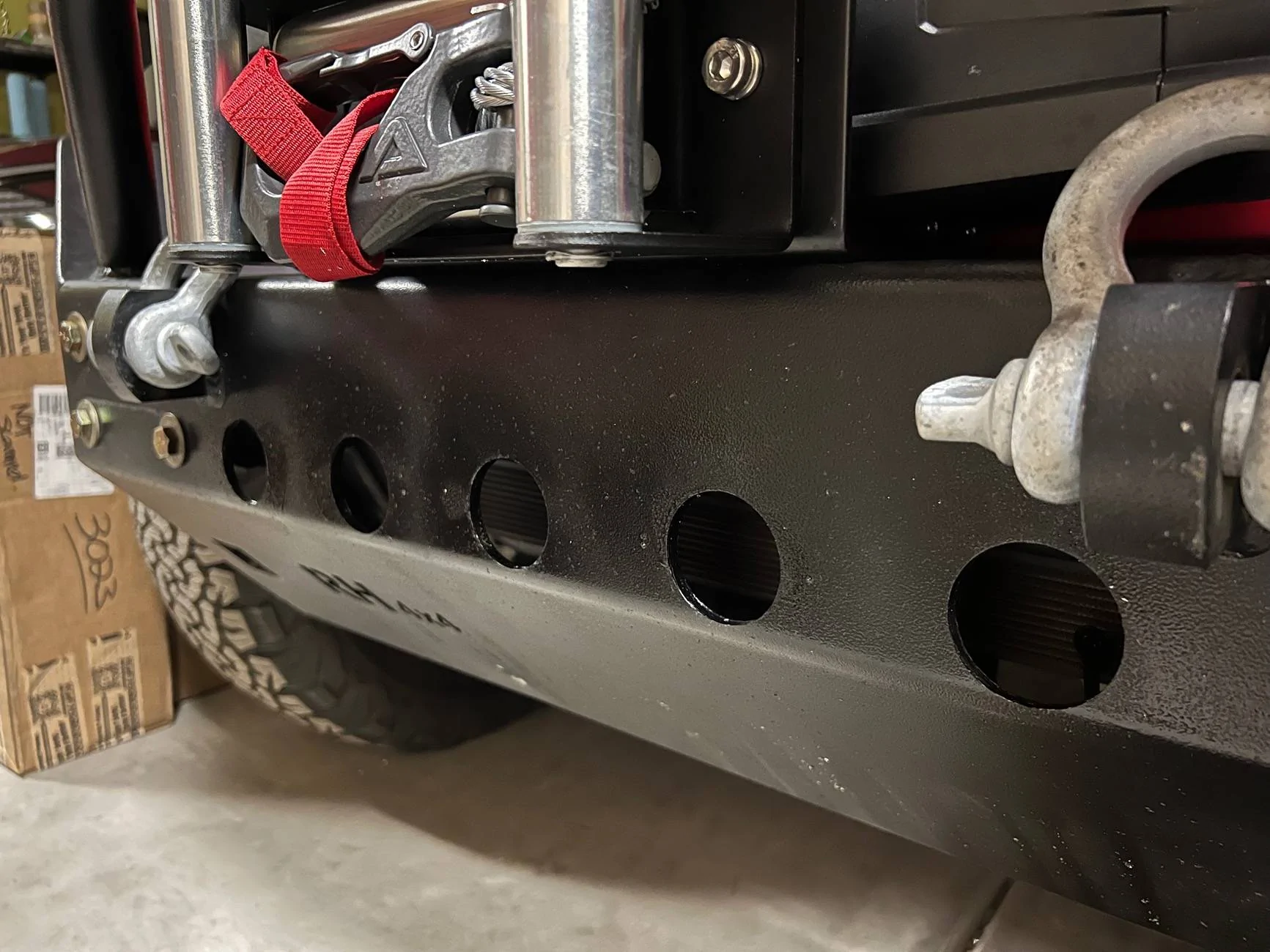

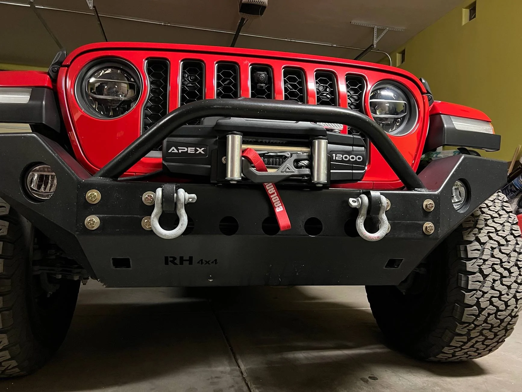

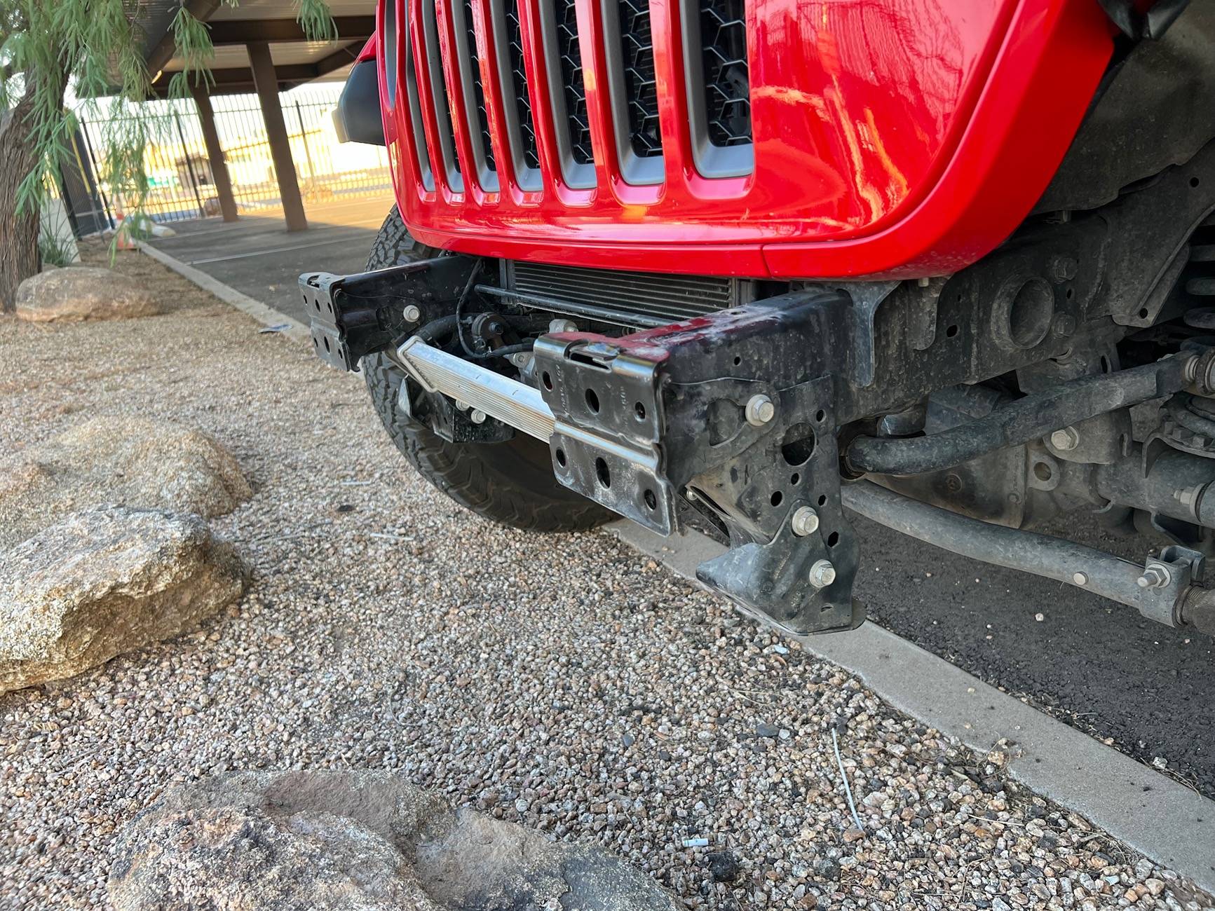

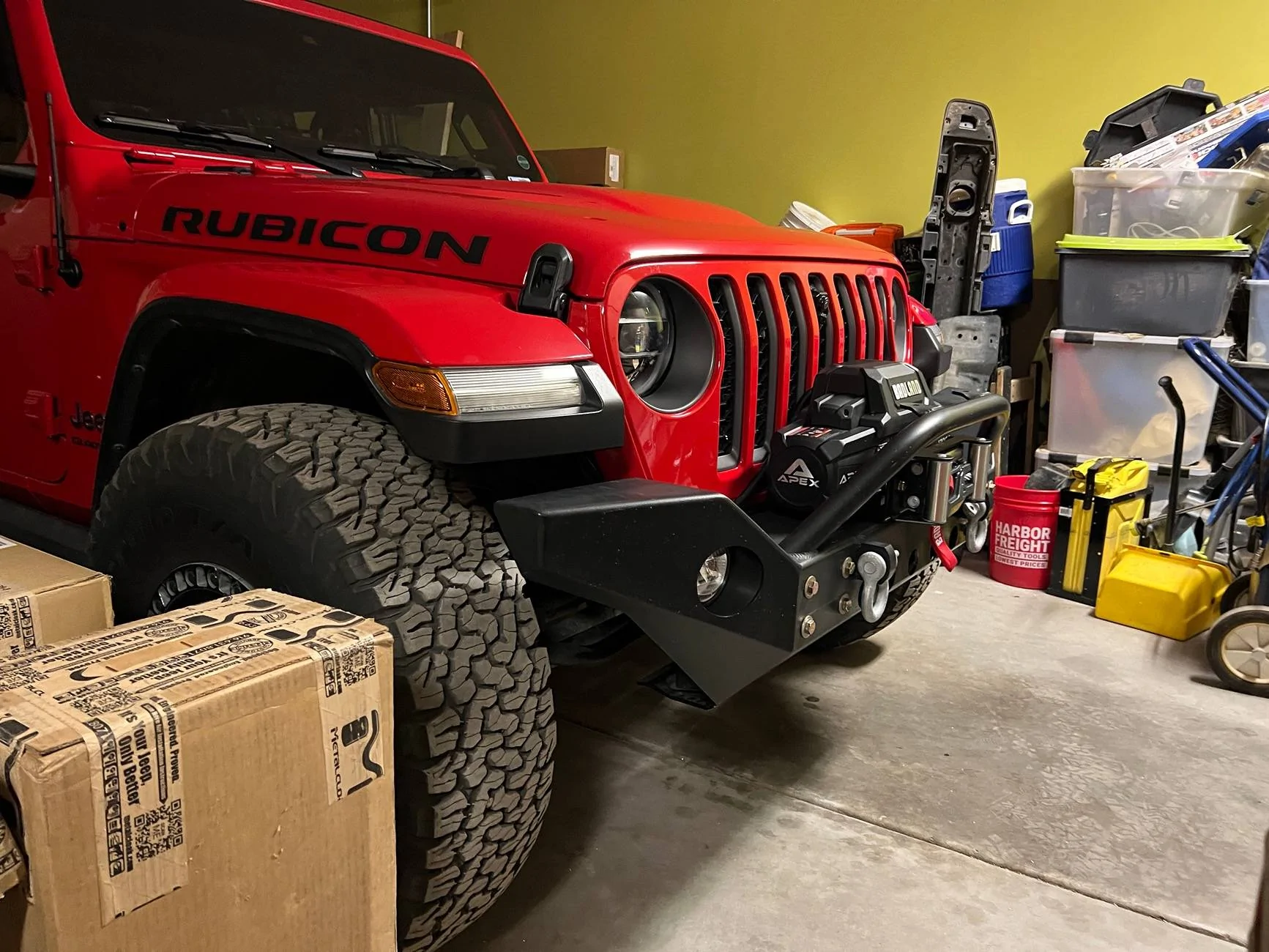

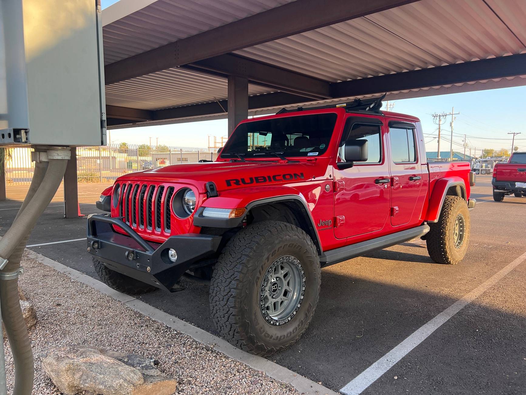

When I installed the Bullet Proof Diesel Aux cooler, I still had the stock plastic bumper. I have been wanting to add a winch, but needed a new bumper for installation. However many new bumpers either have the winch mounted inside the bumper, or have braces to support a winch; both of these setups interfere with the location of the BPD Aux cooler.
My solution is the aluminum version of Rock Hard 4x4 bumper. Winch is mounted on top, no braces in the way of the BPD Aux cooler. Only issue was the design of the bumper plus the addition of the winch prevented air flow to the BPD Aux cooler and obstructed some of the normal air flow via the grill; coolant/oil temps were high again and perhaps worse than stock with no aux cooler. My solution was drilling five 2” holes in the front of the bumper to allow air flow to the BPD Aux cooler and the bottom of the radiator stack that sticks out below the grill. Result is coolant/oil temps back to BPD Aux cooler with stock plastic bumper. I have attached photos for reference (for those interested) of what the BPD Aux cooler looks like when installed with no bumper, the Aluminum Rock Hard 4x4 bumper test fit, and finally the full bumper setup with holes drilled out.

All well and good and creative on your part BUT you've not only compromised the strength of the bumper but also voided any warranty on it at the same time. I appreciate Bulletproof Diesel coming up with the fix which I brought to their attention as a problem early in 2021 when they went over my JT taking pics and measurements then buying their own diesel to experiment on. I was not able to take advantage of their findings and had to pass being the first JT with their.cooler as I have an aftermarket bumper with a 12K winch.. I was not willing to mount a winch above to restrict the already deficient cooling system so I passed. Since then I realized what Jeep already knew and why they stopped selling it, the 3.0 is a total.POS. with now looks like 130 days total in the shop with now over $50k in warranty repairs ALL diesel related. I have written documentation from 2 dealers stating the issues that Jeep knows about but has kept from the public and will soon be seeing them under the Federal Lemon Law. Warning once you have a warranty claim on a part, they will do their best to deny future claims for BS reasons. I think a Class Action suit is in order for those of us that have had serious issues with our 3.0s, something my attorney suggested. End of story......

Five 2" holes will have almost no impact on the integrity of a bumper made of 3/16" steel, especially that between the press-brake bend where the lower section is adding strength and the winch plate above the holes. The frame will already be bending by the time enough force is put on that to deform it.

Excuse me thought you said it was aluminum. However of it helps cooling then why didn't rock-hard add them from the factory. Next time I see James the owner I'll ask him. It's my understanding and maybe you are a structural engineer, I'm not that holes do affect integrity when they are just holes.....

My bad, it is aluminum, but depending on the alloy that's even better. Some alloys are more ductile than steel, and with the right alloy and material thickness it will be just as strong. The big thing is the triangulation and reinforcement behind that plate.
