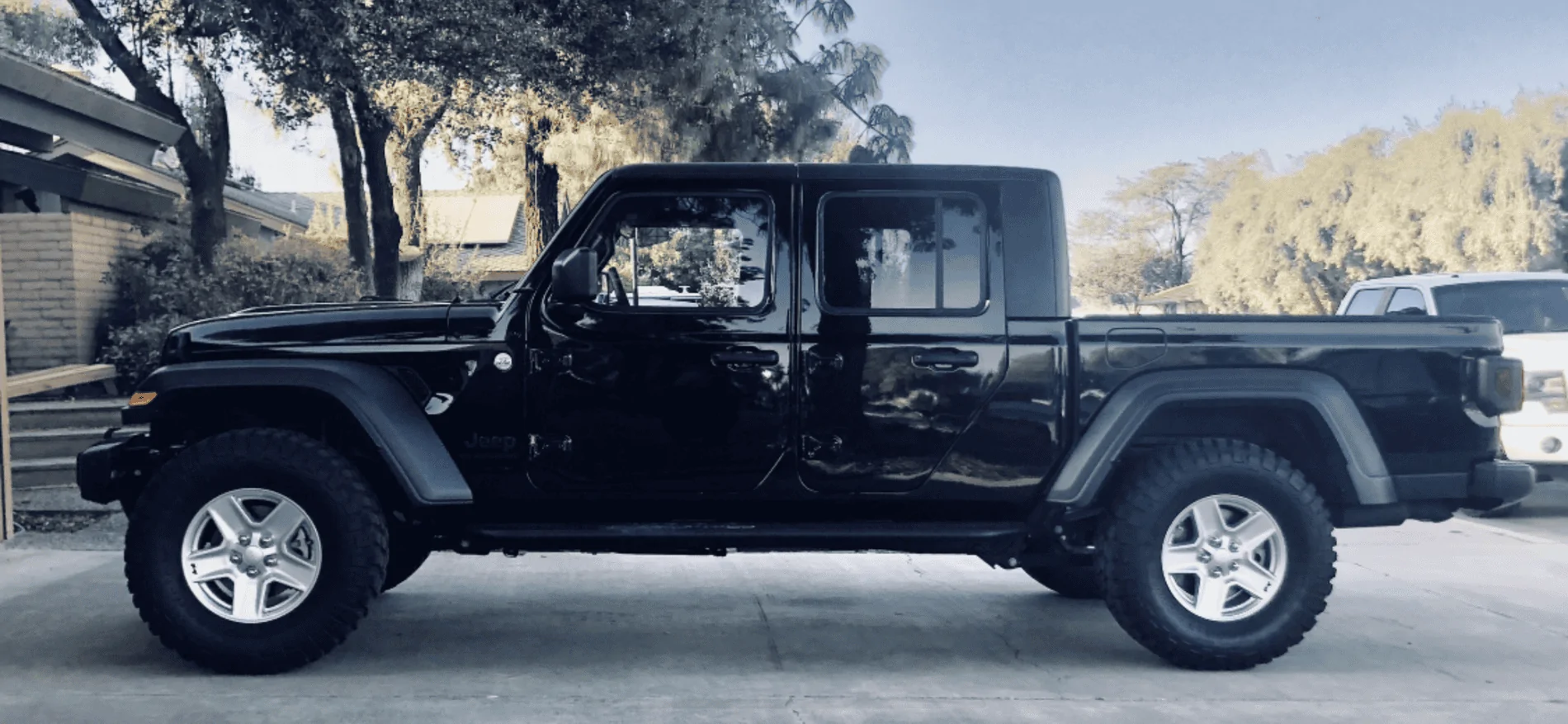

Bfg MT 35 x 12.50s on stock sport 17 x7.5 wheels. 2” leveling chop, air dams removed, max tow fenders, no rubbing while flexing but may if sway bars are disconnected.

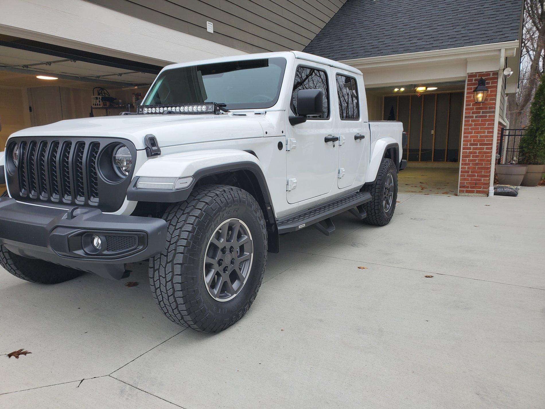

Here is my Overland with 17's from a JL, ended up this way as I already had the Falken AT3W's in 285/75r17, dealer exchanged the 4 overland rims for 5 of these, mounted and installed them no charge. Had I not already had these tires with only 500 miles on them I would have gone with my preferred 285/75r18... Not quite at full stuff here, sway bar disconnected, with a JKS 3.5 inch lift, the lift runs either a 2 or 3 inch front bump stop.. i am confident that 35's will rub quite a bit with no extension to bump stops with the sway bar disconnected. but.... all those 285/75r18's are looking great!!

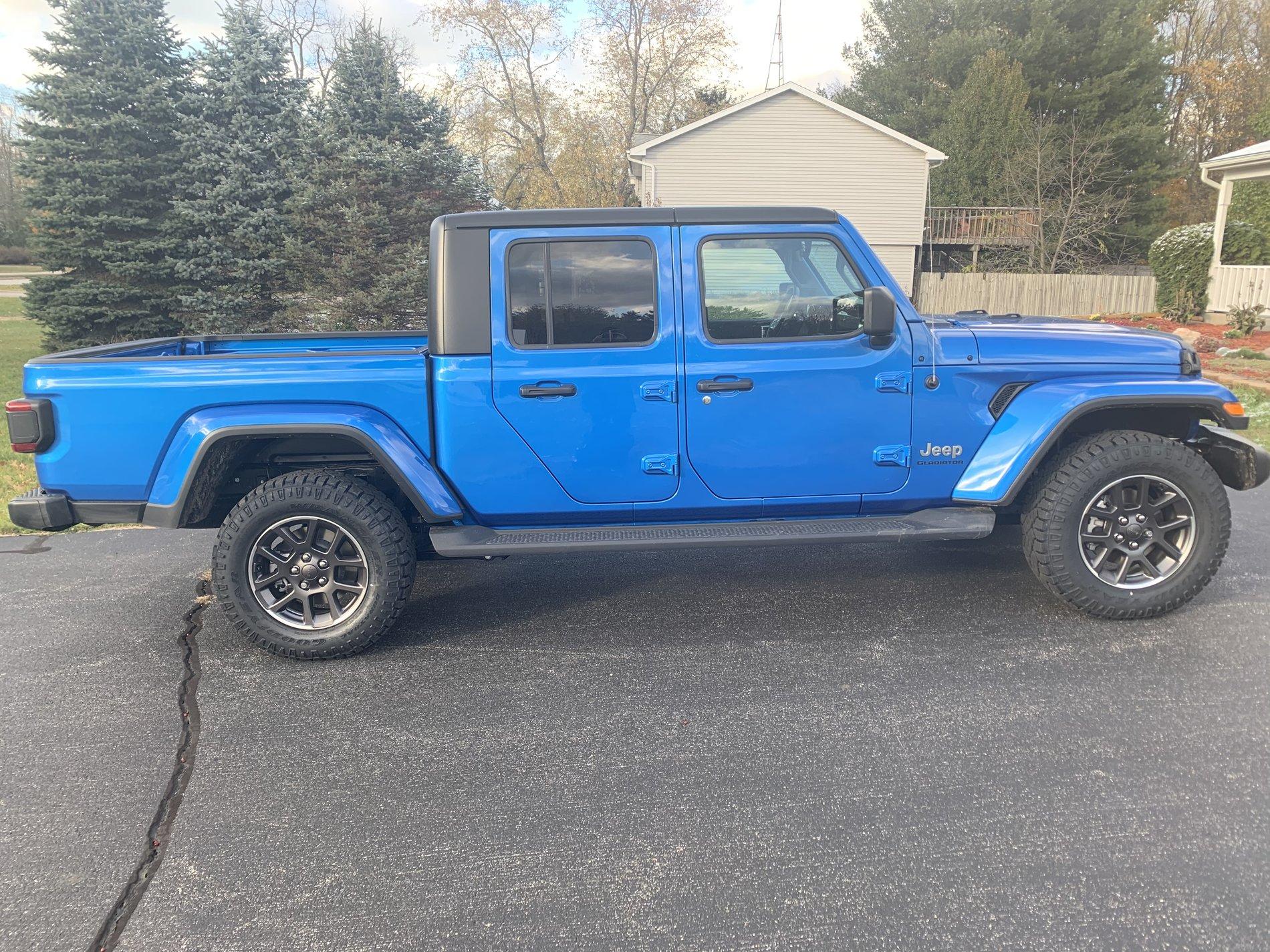

Went with duratracs in a 275/65/18, just a bit wider than stock per the recommendation of others on forum.
the duratracs get great ratings, haven’t had any issues in snow or ice as of yet
was able to get $300 on Facebook marketplace for the original tires with 400 miles on them. Took a little dent out of the $1000 I spent on the wranglers
Tires look great on it.
What kind of difference did you notice on ride and noise?

rides a tiny bit rougher than the stock overland tires, but not bad. Lost 1-2 mpg. Haven’t noticed much difference in noise but I usually have radio blaring

Thanks for the response and feedback.
They certainly make the vehicle look better and I was guessing in the ride and noise. Didn't even think about the gas mileage impact...

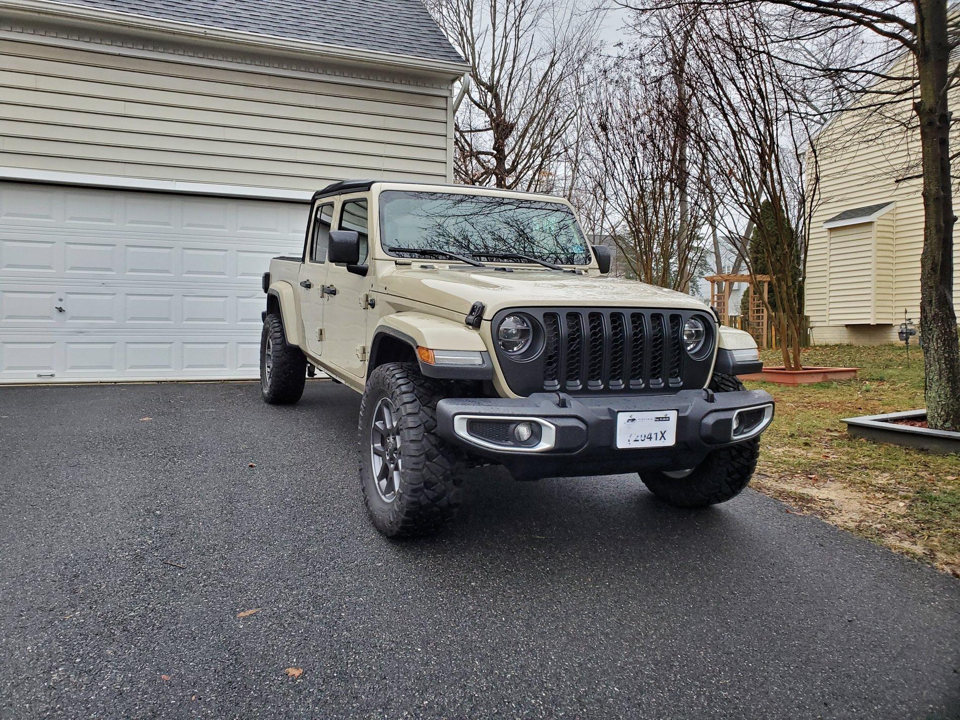

There's a few threads floating around here, but here's mine 285/70 Cooper's. I was in the same boat I liked the factory wheels just wanted a more aggressive tire.
I like that black grill. I assume you swapped that out? I thought about doing the same to my gator green JT.

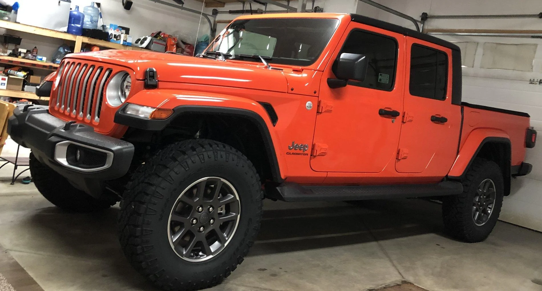

First thing I did was replace tires. Nitto Ridge Grapplers 33 12.50 18 size
no problems fitting those on the stock Overland wheels? I was looking at those tires, but TireSize.com says they need a minimum 8.5” wheel, and I think the stock Overland wheels are 7.5”.

NTB recommended and installed. They are the worst tires I've owned so far and maybe that is why. Maybe not the worst, but no near as good as the terra grapplers I had on my Tacoma. Maybe that's why. Do you know what problems would happen from putting them on too narrow a wheel?
