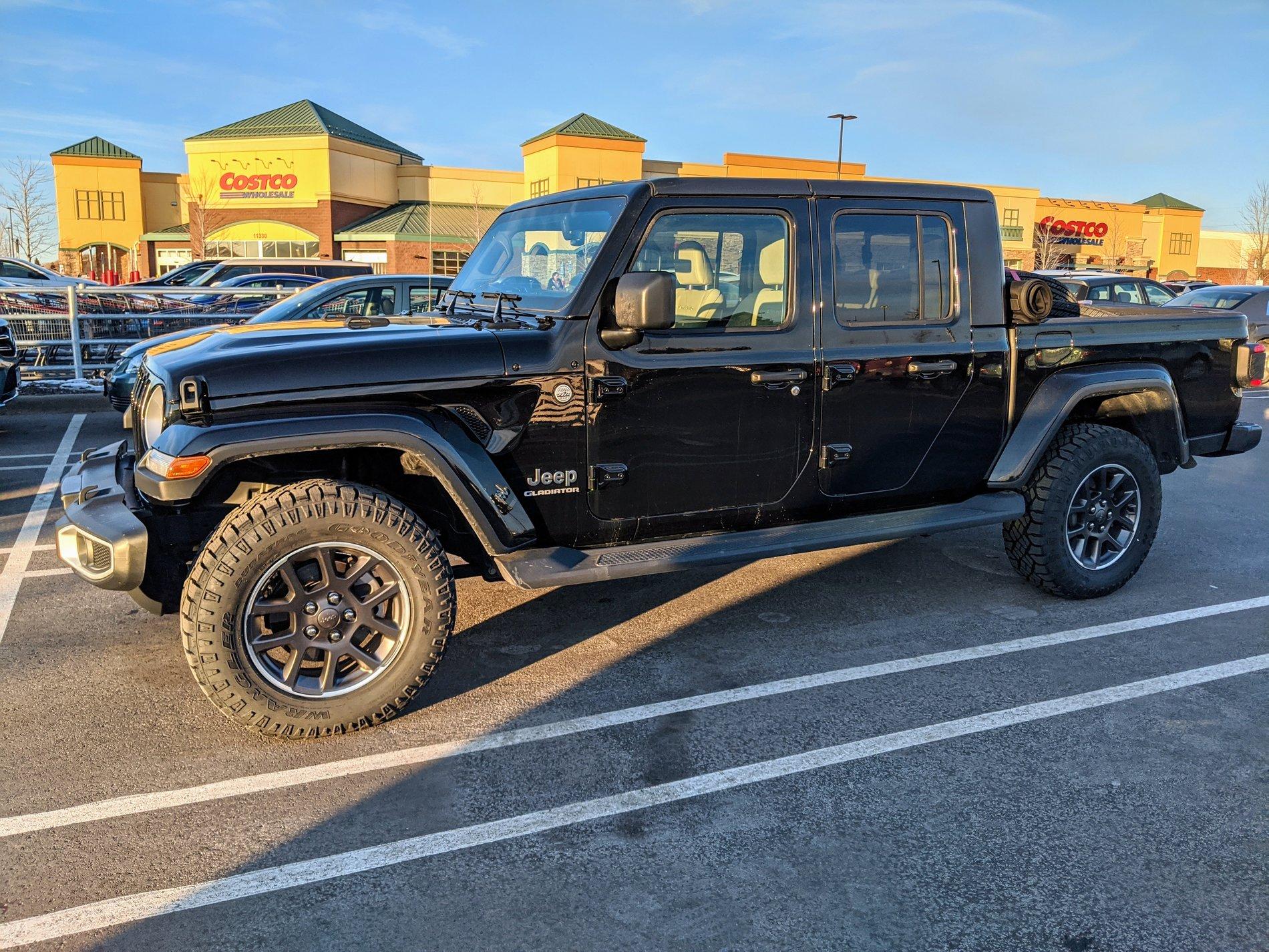

There's a few threads floating around here, but here's mine 285/70 Cooper's. I was in the same boat I liked the factory wheels just wanted a more aggressive tire.

Yokohama Geolander X-AT 285 70R18 on stock rims. I love the rims on the Overlander too! No lift, no issues.
Same color as my JT. Those look awesome btw. I talked to a tire dealer today and he's giving me a good price for Falken WildPeaks. I was planning on going with Cooper AT3 but he doesnt have them in stock.

Exactly what I'm planning to do on my Overland, I have the max tow package and they are the same axles that come stock on a Rubicon. Any off road issues with rubbing?
Haven't been off road at all, but it hasn't rubbed during the course of normal driving.

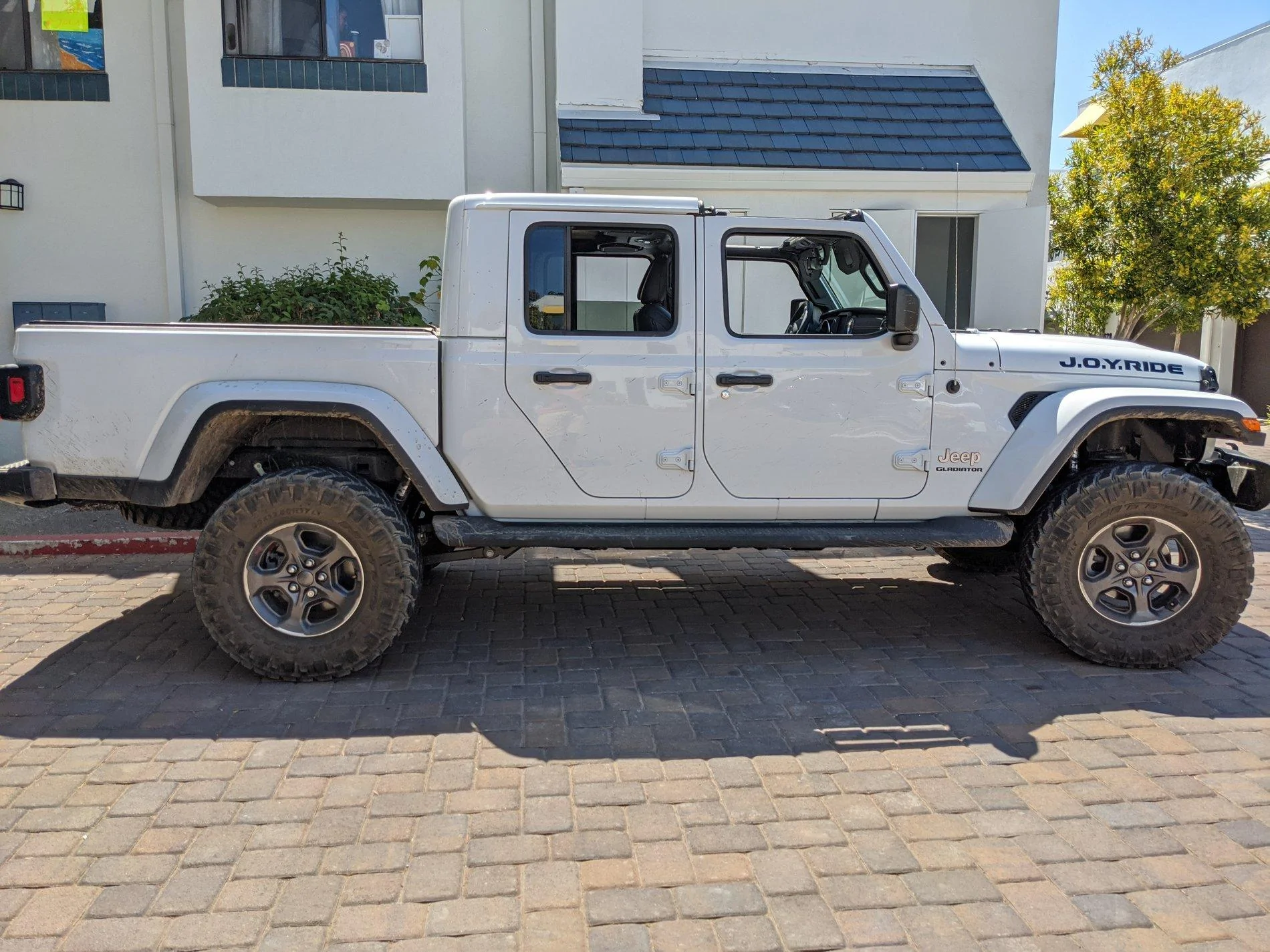

I also went with 275/65/18 Duratracs...rides just as nice as stock so far. Been told to rotate in a timely fashion to avoid the hummmmmmmm.
Jeep Gladiator Overland Owners:  anyone running aftermarket tires on stock wheels? IMG_20200204_164459
