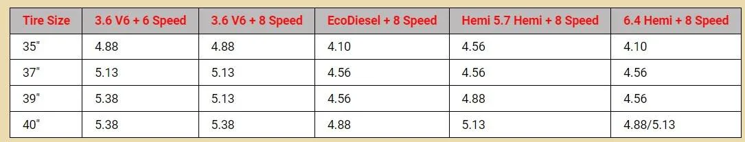

I was just at the local dealership talking with a Finance Manager and he told me that there are some new engine options coming out for the Gladiator but wouldn't say what they are. I'll believe it when I see it. I did a 3000 mile round trip drive on my ecodiesel and had some major issues with the DPF on it. Driving around town it works fine no issues but after about 5 hours on the highway it seems to start having issues no longer clears and the DPF doesn't activate and it fills up and goes into limp mode and you have to do a manual regen to clear it out. Makes for a very long trip when it happens every few hours after that. I was reading that it could possible be due to my build being on 42s with 4.88 gears it can't get hot enough and I need to run the trans in manual mode in a lower gear.
42s are way too high for 4:88s. I run 37s on 4:88s. You could maybe run 40s but I wouldn’t recommend even that, let alone 42s.
While I appreciate your input I don't think you actually read my entire post or you would have noticed that I have the diesel engine which has different gearing than the 3.6 that you have. The 4.88s are about right for the 42s with a diesel. I might be able to go up to 5.13 just like you might be better off on 5:13 as well but to each their own.
