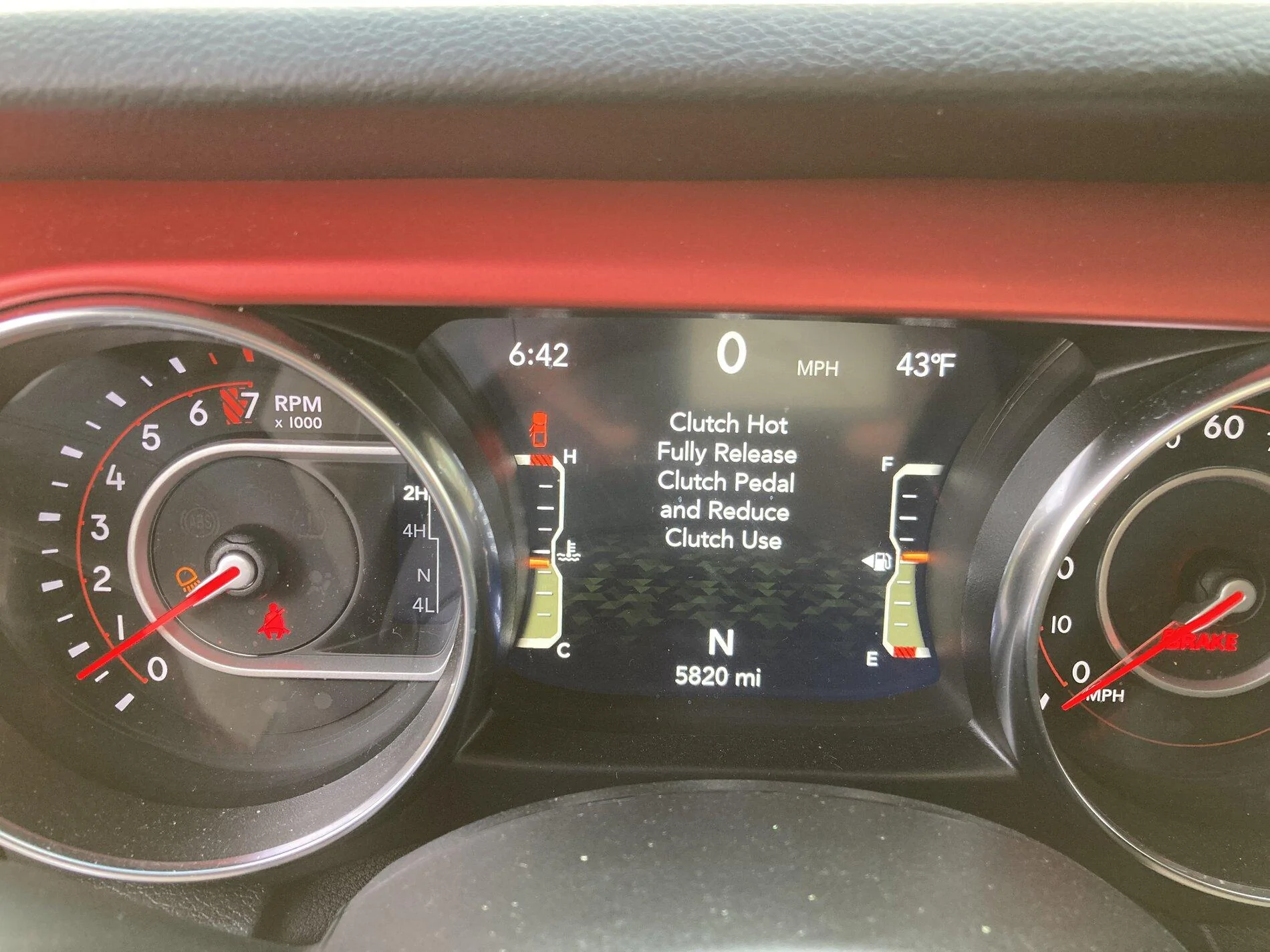

Hi,
If the temperature threshold is reached or exceeded, the launch RPM is limited. The engine output torque is initially reduced slightly only when the threshold is met. If the clutch temperature continues to rise, the software follows a table to determine how much to reduce the engine output torque. Clutch temperature is calculated based on clutch slippage and time. Hope this information help and for more technical information please speak to your dealer.
Rob
Jeep Cares
This lines up with my experience noted above. I got was feathering the clutch a bit too much backing up a trailer on a slight incline. I smelled hot clutch and got a warning message but experienced NO noticeable change in power. I must have done enough abuse to generate the warning but not enough to trigger any power reduction. Moreover, after parking for 10 mins when I restarted there was no warning and I appeared to continue to have full power.
For those of you bemoaning the recall - I can understand and am equally frustrated that I face the possibility of an exploding clutch. But I appreciate the early warning, and I appreciate that power cutting is not triggered when the warning first comes up. So for me (and for most normal drivers) I suspect we will never get to the power cut threshold. That means we a warning system designed to save our clutches before they burn up. To me that is a good thing at the end of the day and I am happy with the fix. Oh and the gear light indicator is helpful especially on those 6-4 downshifts...
I agree. I think this will wind up being a great feature that should be on every manual transmission made.
