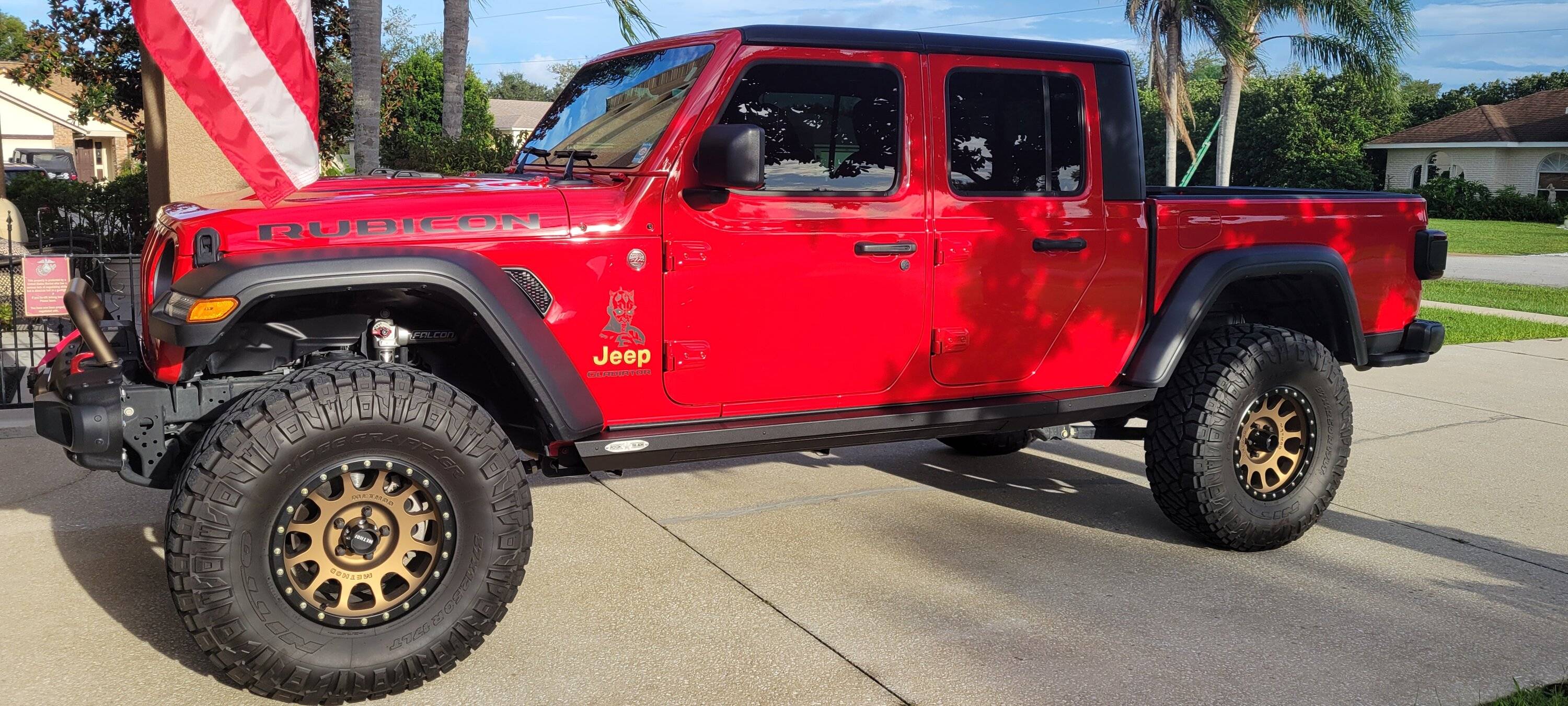

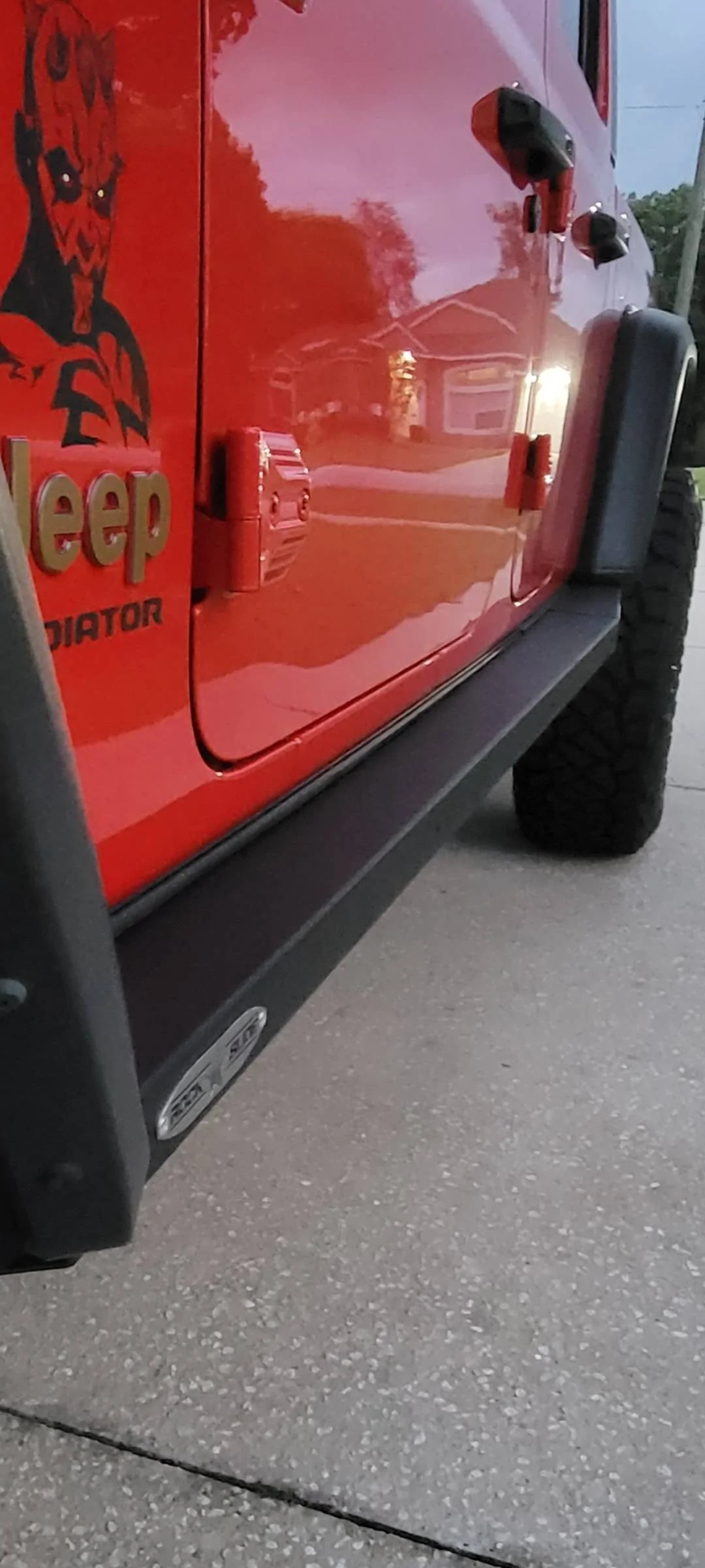

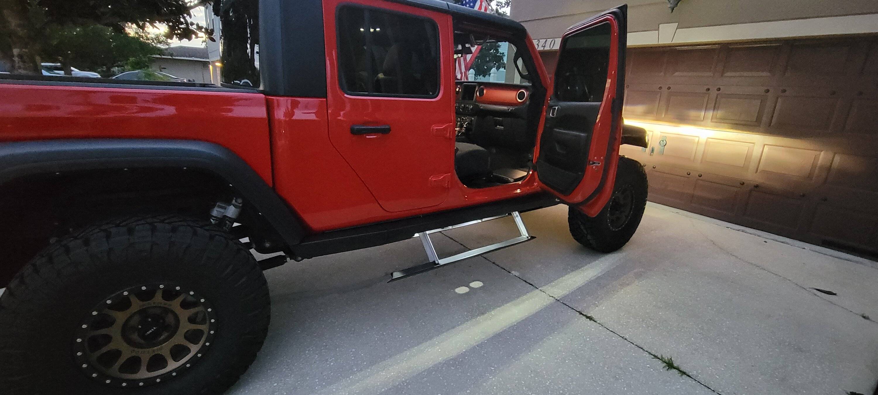

i haven't "abused" mine like @WILDHOBO has so can't speak to toughness in the rocks, but so far, I've observed or seen no complaints. And the units even without the rock shields or guards are built like tanks, very strong and well designed housing.
To this day my wife comments on what a help they are and thanks me for getting them installed.
Love the pics, especially with the flag. Fitting.
The install was the easiest yet! It's the first mod in decades I actually had a shop do lol. Best thing right now is the wife is super happy.
