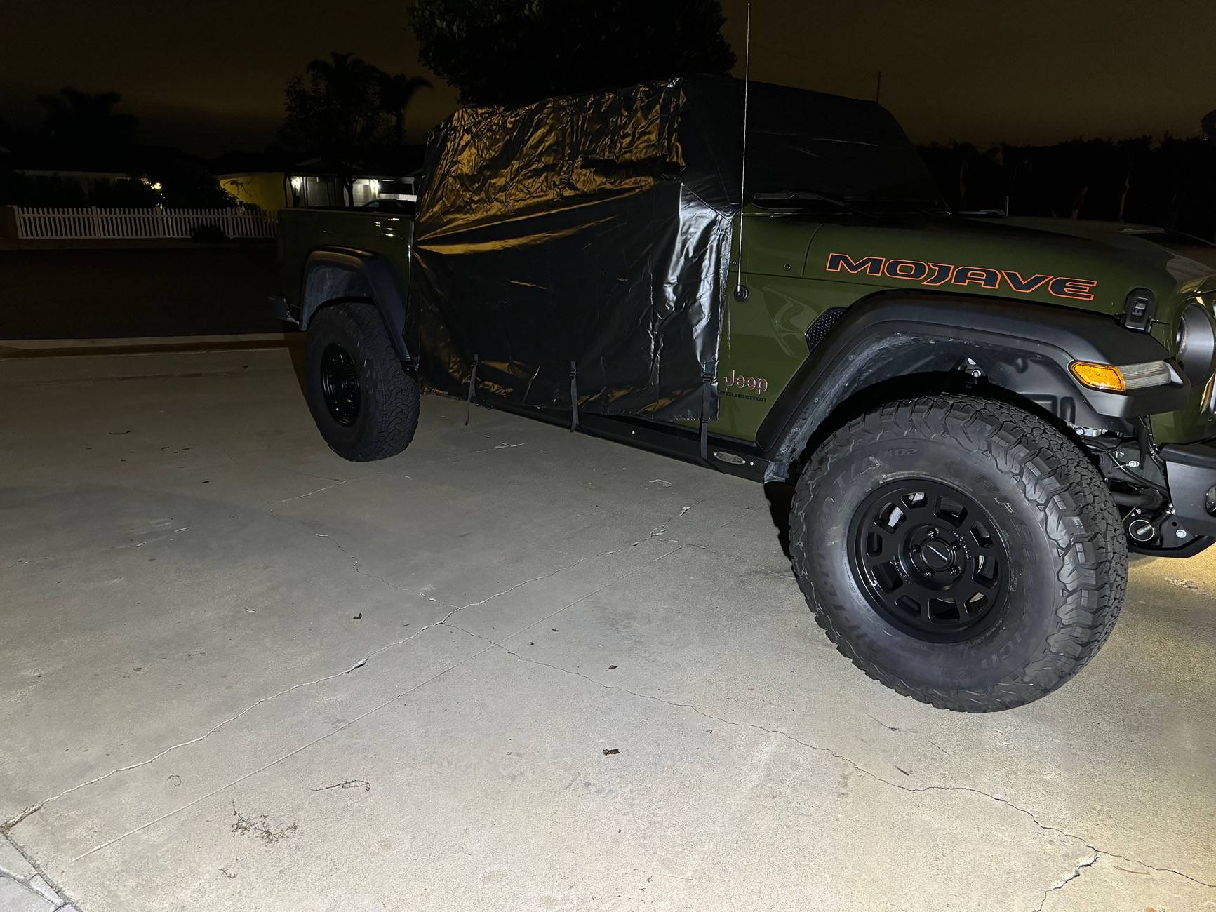

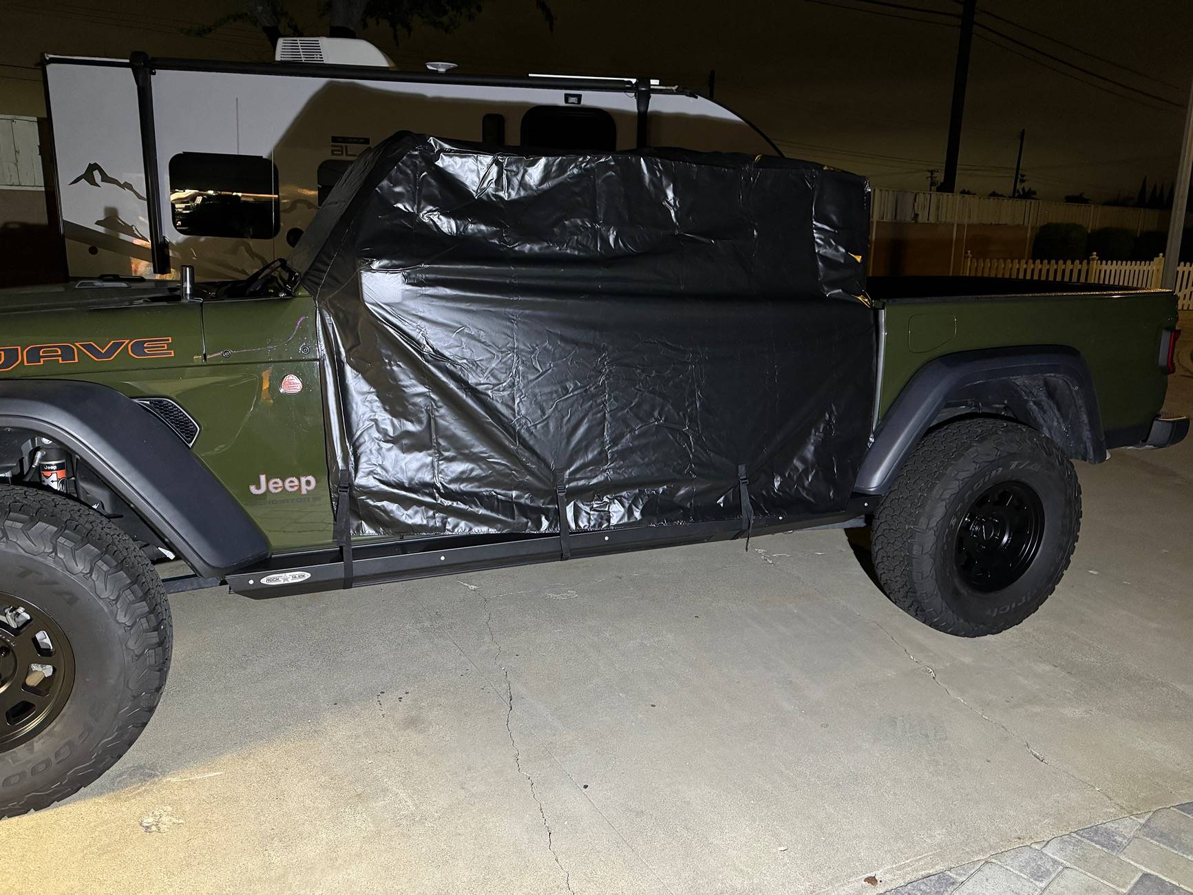

Hoooooooly cow I finally got them installed! Grabbed a used set, had everything there but one small washer! Not bad.
Getting them on the Jeep at midnight alone, THAT was bad, lol... but got them on! Not wired up yet, I really just wanted them out of the garage.
Used the Hot Rod induction heater from Amazon, $180 well spent. Heated up the bolts in 15 seconds (three sets of 5 sec) and the body bolts came loose without any issues! Worth it, IMO. I was afraid of the snapped body bolt stories...
I'll throw up some better pics later!

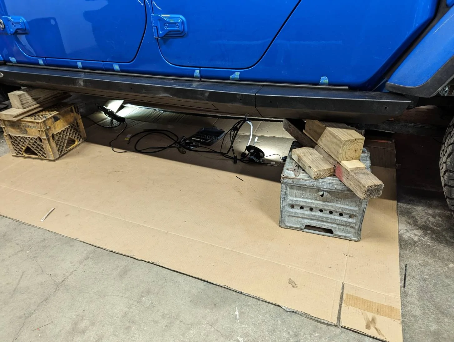

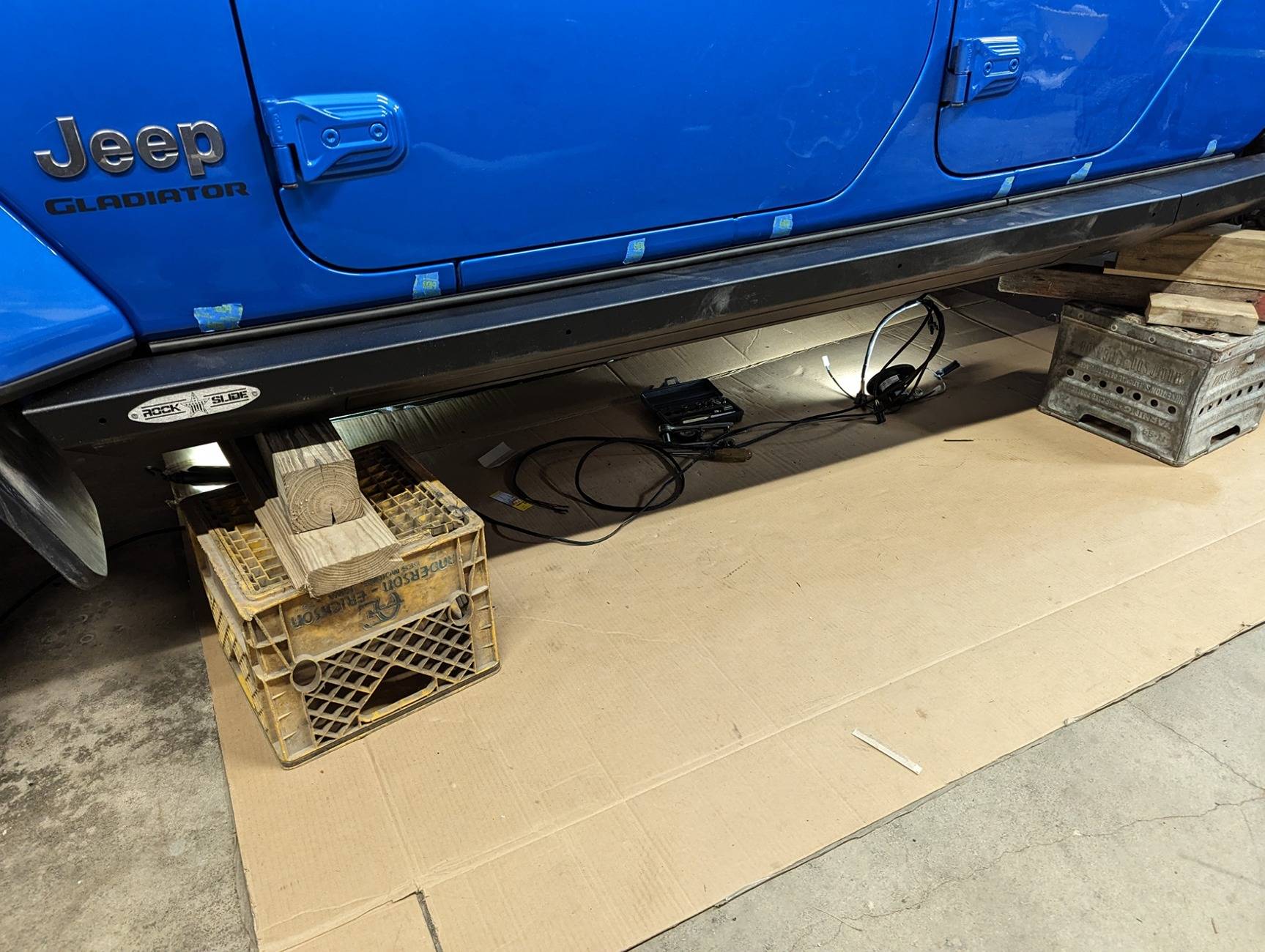

Here's one way to install them by yourself when you are old and arthritic with a back suffering from decades of abuse - figure the height needed, and slide them directly into place, no risk of scratching or messing anything up. You lift each one just one time, onto stands of some sort so you can slide them right into place.
Other members have used small jack stands and planks, for example.
More than a year later, my wife is still thanking me for getting these installed on both her and my Jeeps, and praising them each time we go anywhere.
That was what I did as well and yes old and arthritic. Still found the instructions horrible at least for me. Where they tell you to remove the floor plug for the wiring well my Jeep had the rear plug covered over with a rubber tape and painted so I thought for sure they must mean the plug is in the front. Got all the wiring pulled into place and couldn’t make it make any sense. Frustrating but they’re on now. Theyre ok. Pretty overpriced IMO especially if you add the armor ETC. Hopefully they hold up to use and abuse.
