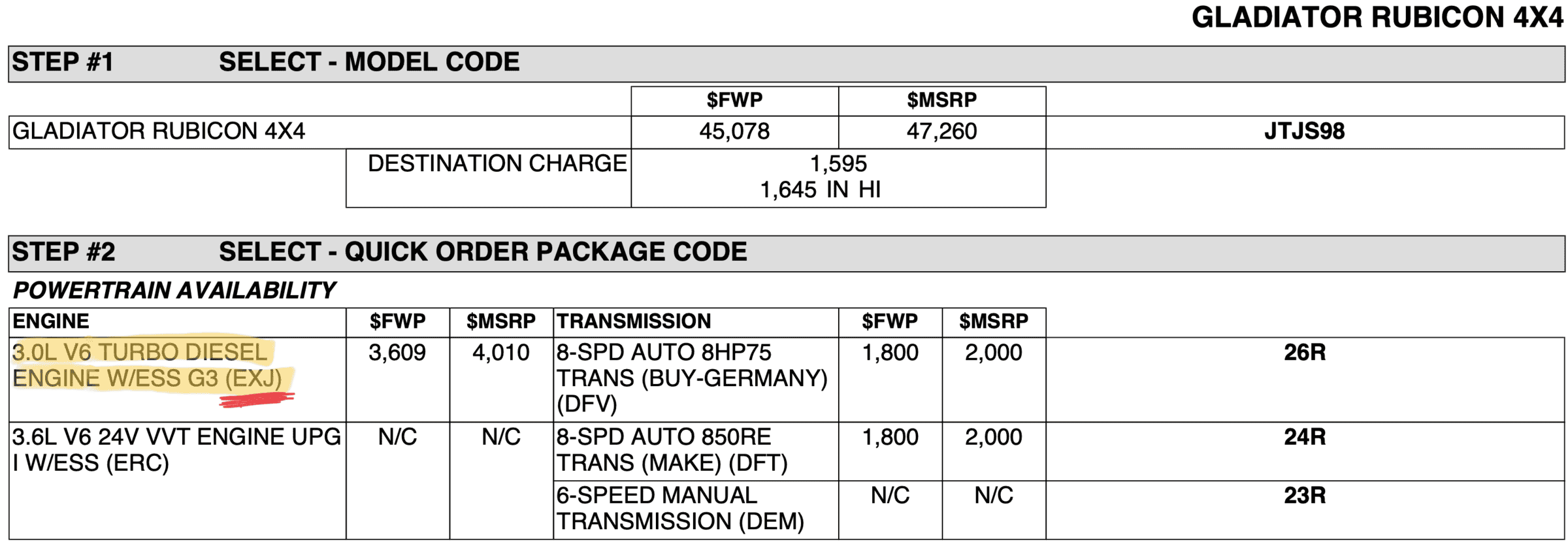

I'm not seeing EXJ package noted anywhere. What is that? I have a '21 JTRD. 26R clearly spelled out. thanks.
I checked my sticker and it has does state the diesel engine and 26R but no EXJ.
As I just noted above, EXJ is the diesel. You won't see EXJ on anything other than the order guide, it's just the sales code for that motor. If you have a Diesel and it's a Rubicon you're all set.
