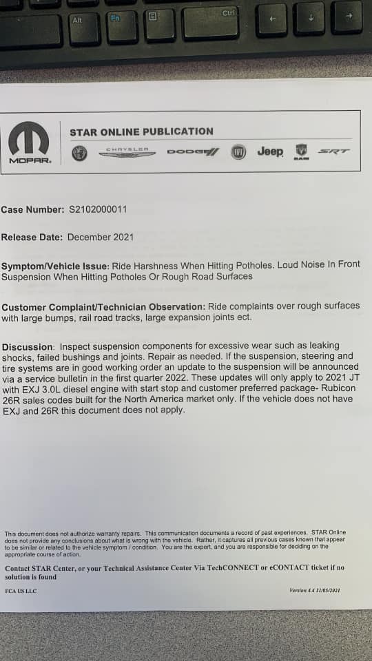

Is this just for rubicons?
Jeep Gladiator Updated - Gladiator EcoDiesel Bottoming Out Poll 2 - Spring Part Numbers 263979151_10223652315430679_8838722580458775264_n

It’s says EXJ and 26R. Is your non-rubicon an an EXJ pkg? Check your window sticker.
https://www.jeep.com/hostd/windowsticker/getWindowStickerPdf.do?vin=TypeTourVINhere
Yes, the bottom line literally says EXJ (diesel) AND 26R (rubicon package). So you much have the diesel motor and be a Rubicon Trim.
Doesn't matter, the STAR case is specifically for Rubicons with the diesel motor only.

@JeepCares Kate, I documented this with my dealer last month. I ordered a lift this month. Can you check with the engineers on whether the AC part numbers never lift is going to need a part swap/modification for the 26R Rubicon diesel? I have not installed this lift yet.

Where did you pull this document from?
Must be an employee, or has already been to the dealership. I wasn't aware of a way we could access STAR publications like we can for something like TSBs.
Well then they need to address that for all the other submodels.
Yeah not sure why it's specific to rubicons only, curious to see what the fix is. It might shed more light on why it's only rubi specific.

I'm not seeing EXJ package noted anywhere. What is that? I have a '21 JTRD. 26R clearly spelled out. thanks.
