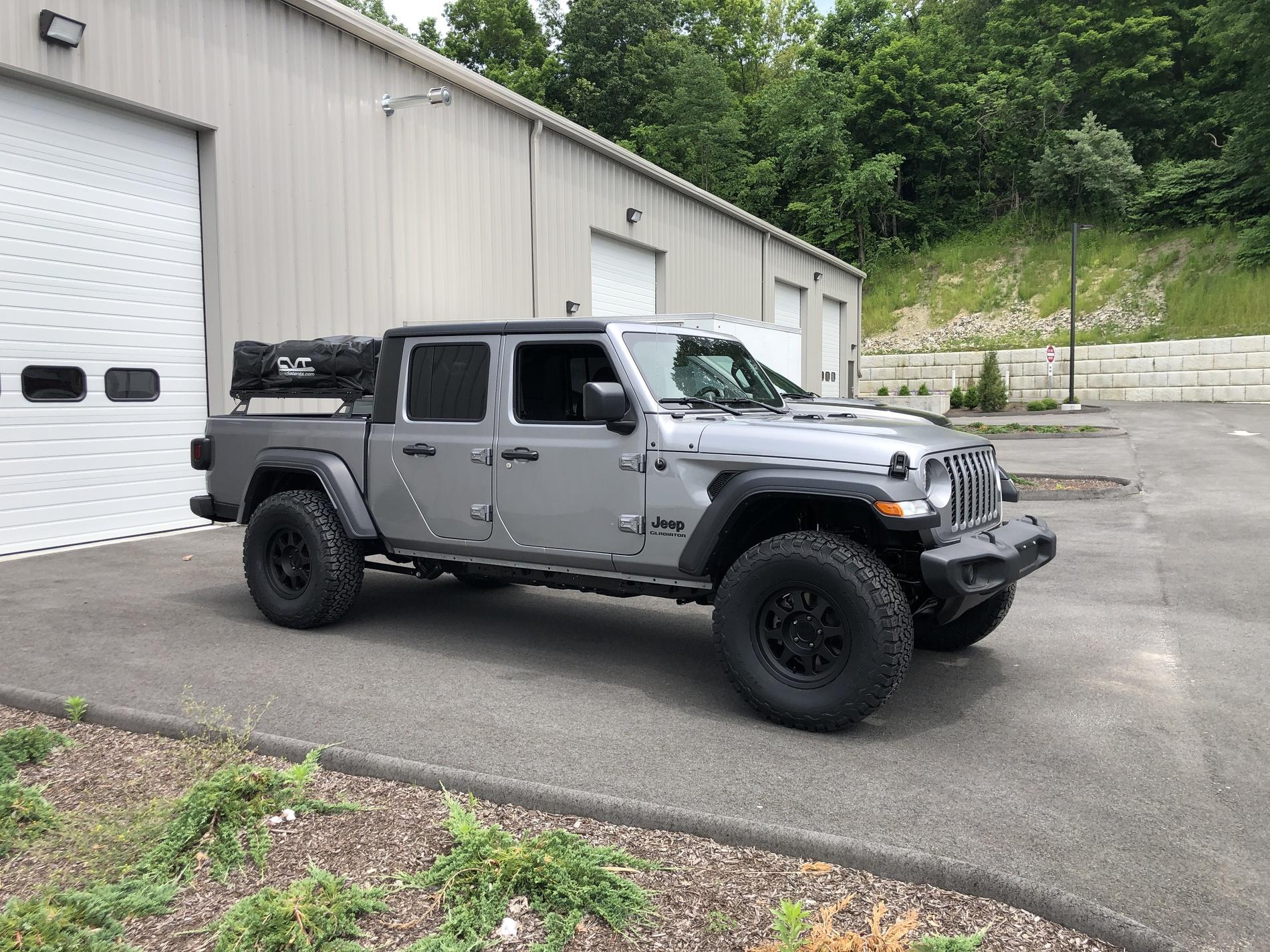

Did you go with a lift or stock? How do the tires fit? Any rub if stock? I ask because have a sport s in order and am thinking 35s. Have 33x12.5 on my YJ, no lift, and get a lil rub at max turn both sides.
I don't remember if I posted a pic, but I did a 2.5" rough country leveling kit in the front. Down the road, I'll do a 'real' lift, but I want to wait and see what some of the other aftermarket companies bring to market before committing. The 35's fit perfectly with the 17x8.5 wheels I'm running.
what rack system are you using for your tent?
