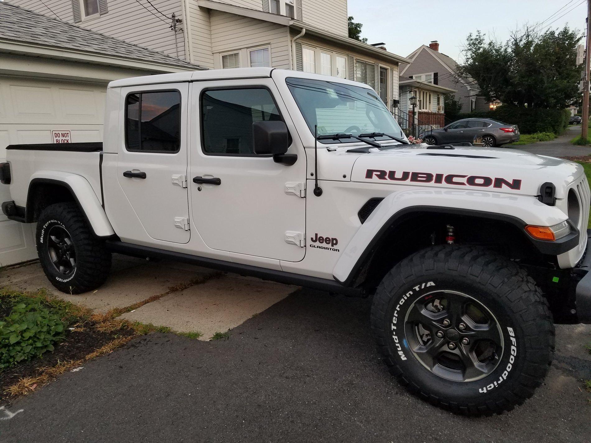

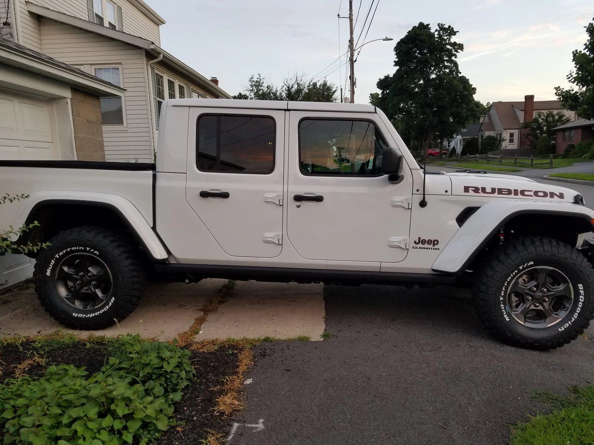

IMO 315/70R17 is the perfect combo. Jeep recommends additional equipment when installing 37’s. If you’re not wheeling weekly and it’s your daily driver I’d stick with 35’s. 37’s unequivocally put a great strain on the drive tran components. Premature wear is a matter of when not if. 37’s also require more upkeep. 0.02
For reference:
BFG KO2 315/70R17: actual diameter is 34.4 @ 64.5lbs each
BFG KO2 35x12.50R17: actual diameter is 34.5 @ 66.3lbs each
BFG KO2 37x12.50R17: actual diameter is 36.5 @ 69.5lbs each
I did the 315/70R17 option. It looks great without a lift or changing the engineered geometry of the drive tran. No bro dozer look. It’s only .1 smaller than a 35x12.50R17 and weighs a little less. Maybe I’m cautious but I daily drive and do moderate wheeling. I will get everywhere anyone else is running on a trail. Driver input is everything. 37’s are out of the question for me, not worth the extra wear and tear or $$. Full disclosure, I may have opened a controversial can of worms.:idea:
