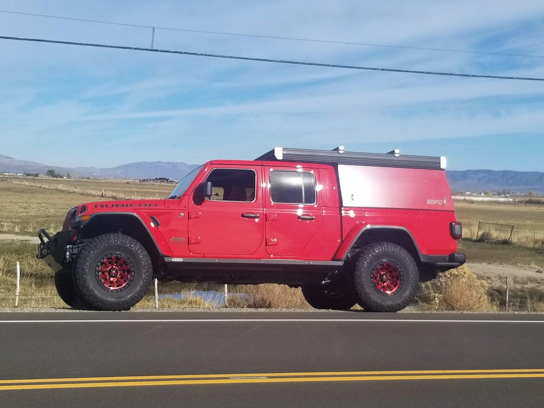

OMG. my Diesel Gladiator dives like a dream on 37's. get the falcon 2 steering stabilizer. Because of the Diesel, factory 3.73 works. the factory axles on the max tow and Rubicon are made to handle the big tires. you need to upgrade the steering components. I use Smart Steer and a steering box stabilizer. handles in the rough stuff like a Cadillac. if you are planning rock crawling, upgraded axels are recomended.
