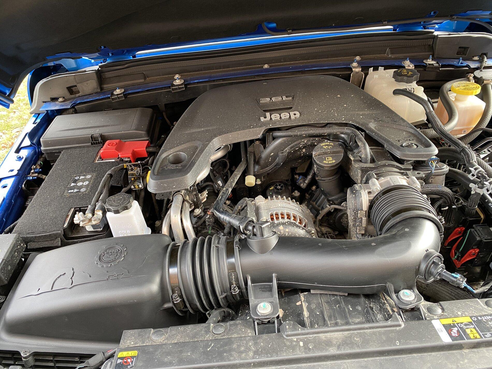

mopar intake with afe pro guard 7. with this and the pulsar, Im getting better than stock mpg now, with 37’s. Gears and exhaust next.

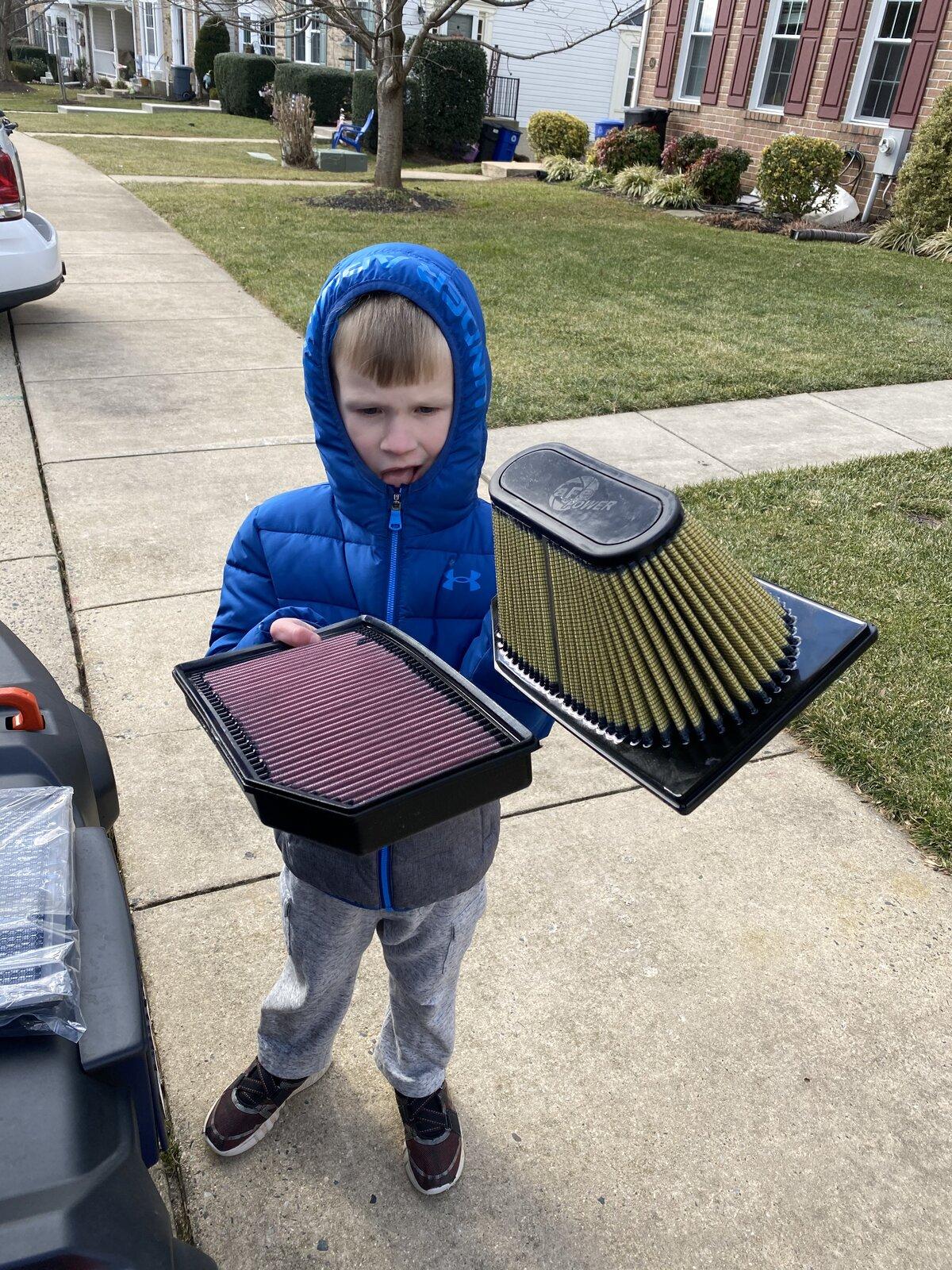

Any noted difference in sound or throttle response going to the AFE dry cone filter?
Yes to more growl; no to any noticed change in throttle response/power
i did notice a throttle response improvement between stock and mopar intake, however. the Progaurd 7 is actually oiled. Its like a mix of the dry filter element and a KN all in one 7 layer filter. Its intended to filter really well over every last hp.
my thought process was that it should filter as well as paper and the size of the cone make up the difference in flow.
the intake growls more at lower rev and less throttle than with the KN panel. I have not noticed any perceptible change in power up or down between the change, which is right where I wanted to be. More filtration and maintain power.
i may swap back and forth between the Blue 5r for the street/commuting and the 7 for wheeling trips. I plan on doing an oil analysis on a 5k interval on the Pro Guard 7 and posting results.

Awesome. Keep us posted. Ability to put the paper filter in was my number one reason for choosing the mopar. In looking at the Holley, i think it probably would make the most power back to back on a dyno of any on the market. The SB is proven to lose power. I think the mopar is the best compromise of all advantages, with no disadvantages.
it comes with a dry panel filter, looks similar to what the AFE grey dry filter is. I have not used that one. I had a KN in my stock airbox i used; then the afe. the grey material mopar filter is definitely thicker than the red material KN uses; but id imagine its still flowing fine.
it definitely works. This intake, combined with the Pulsar, im now getting better mpg on 37’s than i did stock.

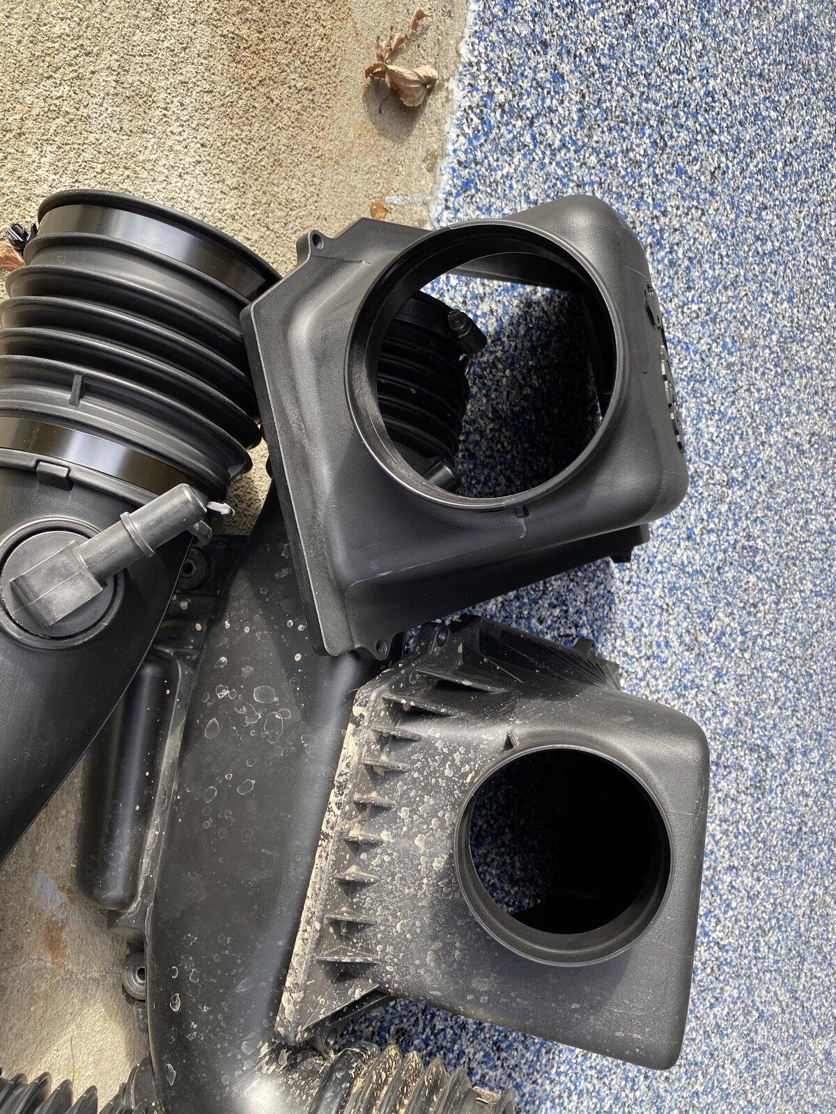

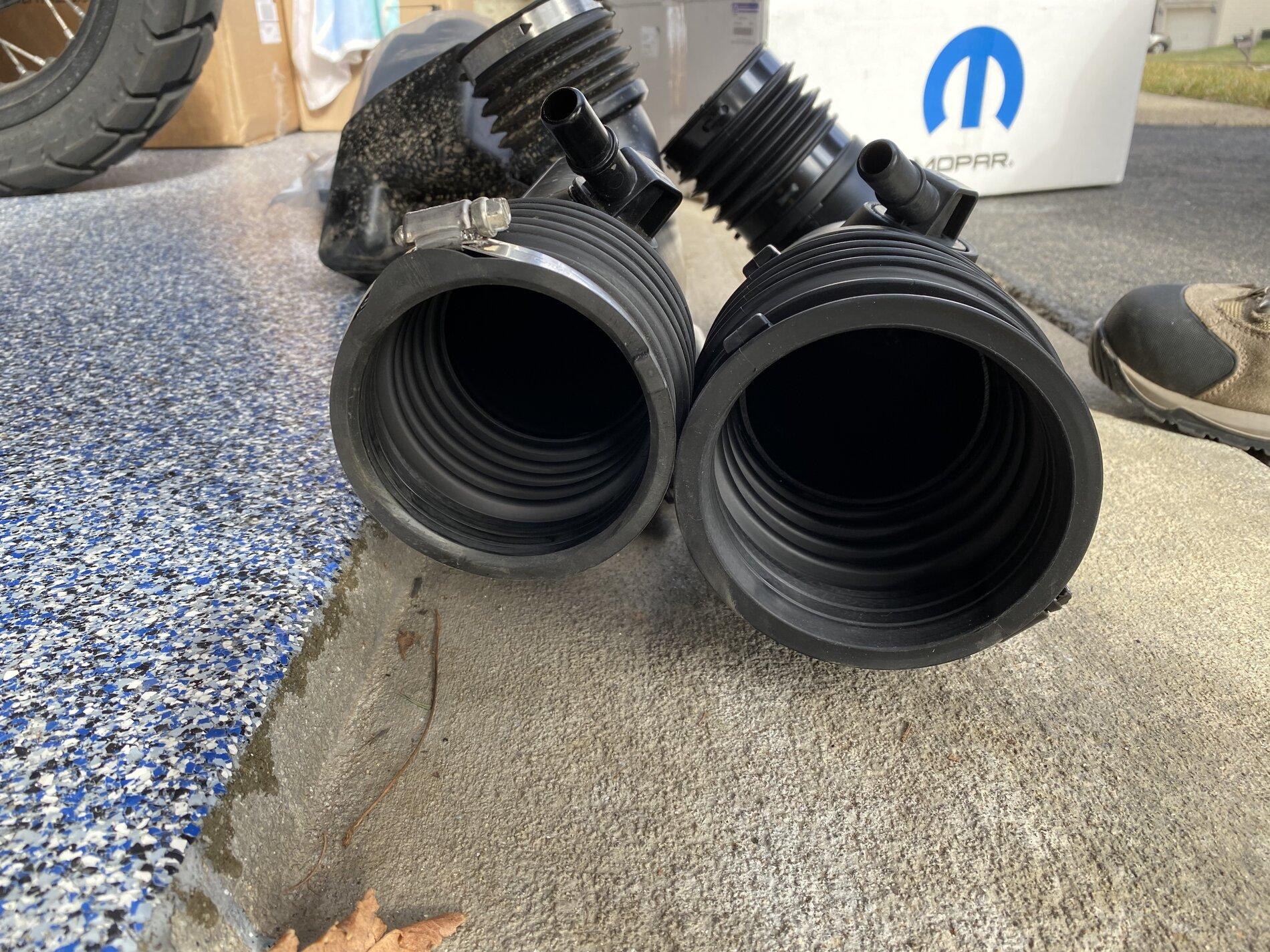

OH WOW...
The outlet on the MOPAR airbox is significantly bigger.
KurtP
Kurt
Oct 9, 2020
68
2,310
2,995
VA
S/C Mojave
Only Fans Content Creator
OH WOW...
i was shocked, frankly. The pipe diameter is larger as well, and the resonator chambers are removed. As you look, you can see the actual airbox is larger too
i decided to get the mopar intake after seeing how much larger the airbox and outlet were on my woman’s GC3.6.
you’ll hear a lot about Mopar engineers making the stock intake. It casually leaves out that Mopar engineers also designed this one....only this time there were no NVH restrictions.
