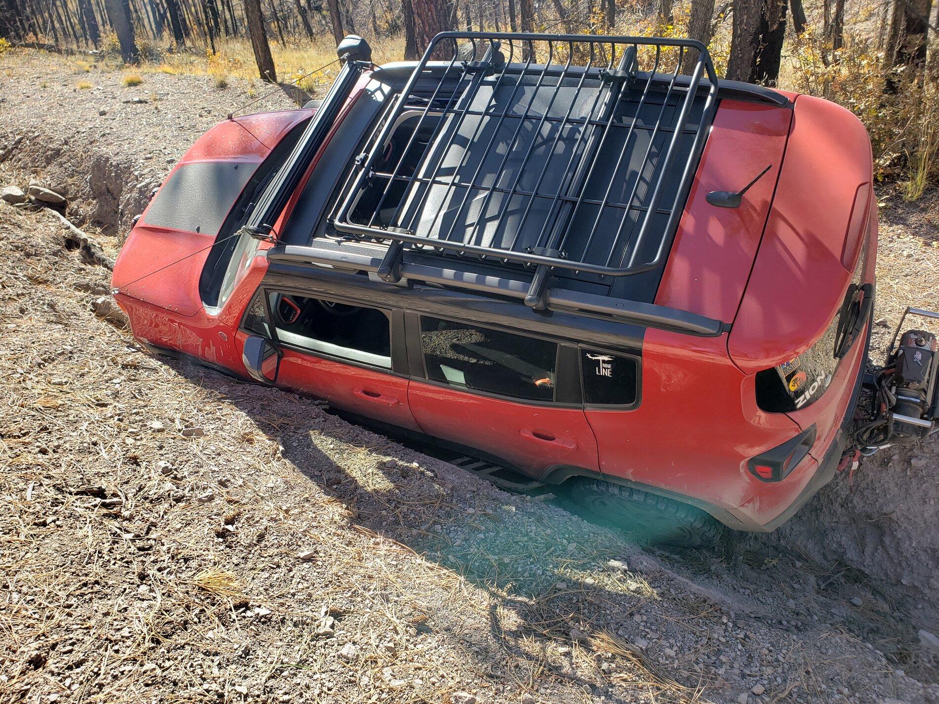

My son and I got turtled on this shark fin rock last weekend. Dented the muffler, bent skid a plate, and knocked weights off the rear drive shaft. It took 3 hours and a lot of help from passersby to get us off that rock!
So, as a noobie JT owner (and first off-road vehicle), I am wondering should I take it to the dealership to have it checked out, estimated for damage, and repaired? Or should I take it to my local 4W/off-road shop?
Again, I can’t thank the Jeep community enough for all the help!

Usually you feel a constant vibration, could be speed related or if it’s bad enough it is constantly vibrating.
Even if you can’t feel it that shaft will be out of balance and is worth checking.
You also should check the CV under boot at the front, the carrier bearing for the two piece shaft in the rear, all u-joints as well; ball joints, Trac-bar for looseness and bends, tie-rod ends.
Definitely worth an experienced shop or a trusted dealer to look it over.
I was advised to drive it in 4H on the way home - about an hour on state roads. There was a chirping sound like crickets. No noticeable vibration. I kept the speed to 45 MPH.

Have the DS checked. Others are battle scars with stories to tell.

Depends. If that's on a public road of some sorts his insurance might cover the cost
Insurance will indeed pay for it, even if it's not on a public road. Progressive paid to fix this...

I would only worry about the drive shaft personally.
See my thread on checking your insurance. In KY none of the big carriers would commit to saying they would cover any damage done "off roading". My carrier covers damage while on a "public road" so county roads that look like that should be covered. Different states have different rules for what automobile insurance does or does not cover. A young man I met was driving down what USED to be a county road when the "road" washed out from under him and his 4Runner went almost into a creek. Insurance would not cover it (based on talks I can recall with the man's father who was the policy holder
Someone told you to drive it home on paved roads in 4H?
LostWoods
Mar 13, 2020
2,027
2,421
Gilbert, AZ
2024 4Runner / 1995 YJ
That's what you do when you FUBAR the rear driveshaft and pull it (turns it into FWD) but with it still attached, that noise was probably all the tension in the transfer case.
Thinking that was not good advice. You do that when you remove the rear and use the front to get you home.
