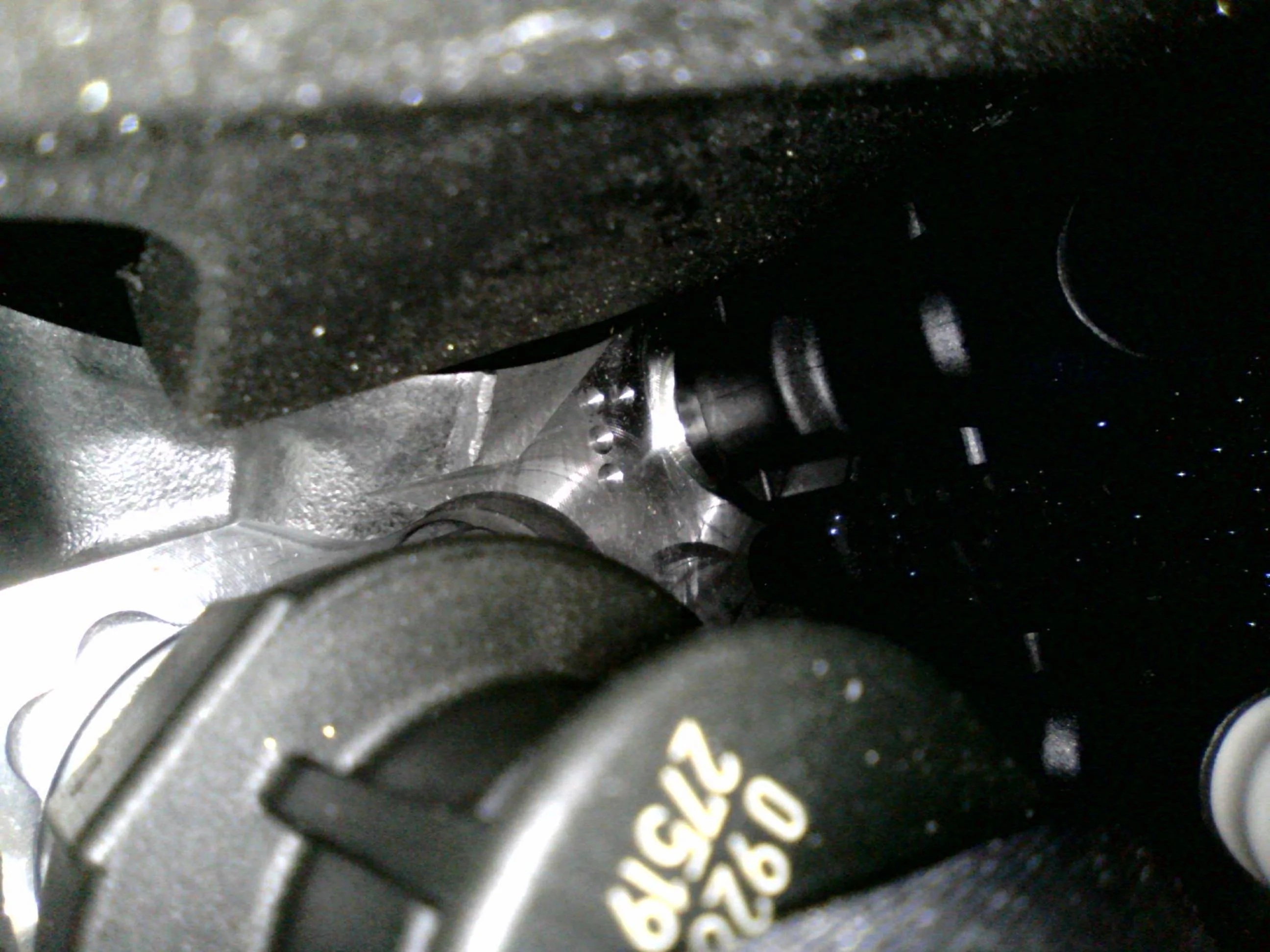

Someone can correct me if I’m wrong. But ALL eco-diesels in JL/JTs run CP4s. None run CP3s. And since its a V6 and not an I6 its alot harder to just throw in a single pump compared to a dual pump due to timing. The pump would have to run at a different speed unlike in the Y78 recall for the cummins

You can remove the engine cover and maybe use an inspection mirror to see behind that pump cover. That cover does looks like CP3 under it though.
Looks like CP4.2 to me with two fuel lines coming in on the top. If I recall correctly from last week, the top of one pump will be visible in the cutout on the left. Seeing the top of the one pump is all you need to know to tell it is not a CP3.
I'm out of town on business for the week. I do have a bore snake camera, and will sneak it in to get a better look when I get back next weekend.

I played around with my bore camera and it does look like a CP4 pump. I was able to get a shot of the dimple pattern. 3 in one row and one in the other:
Interesting, different dimple count than the original dimple post.

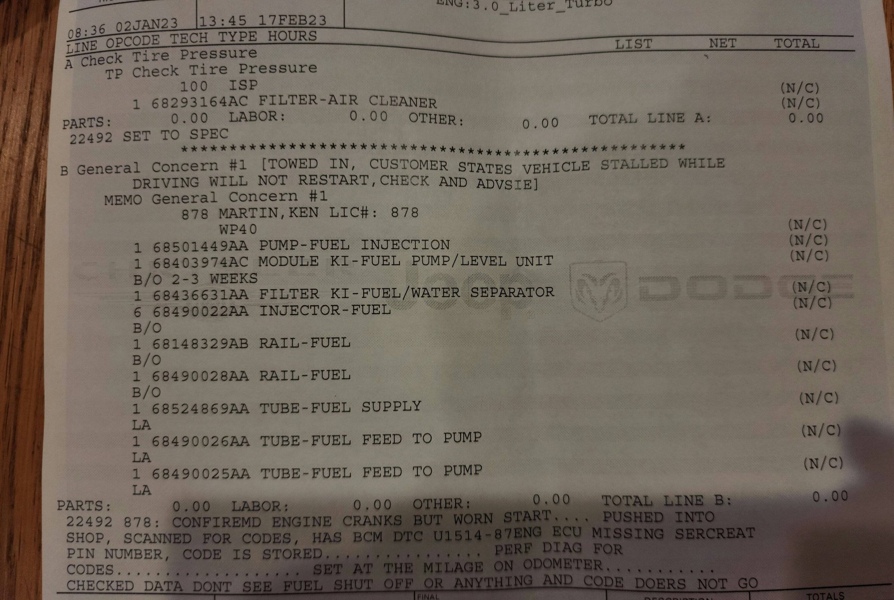

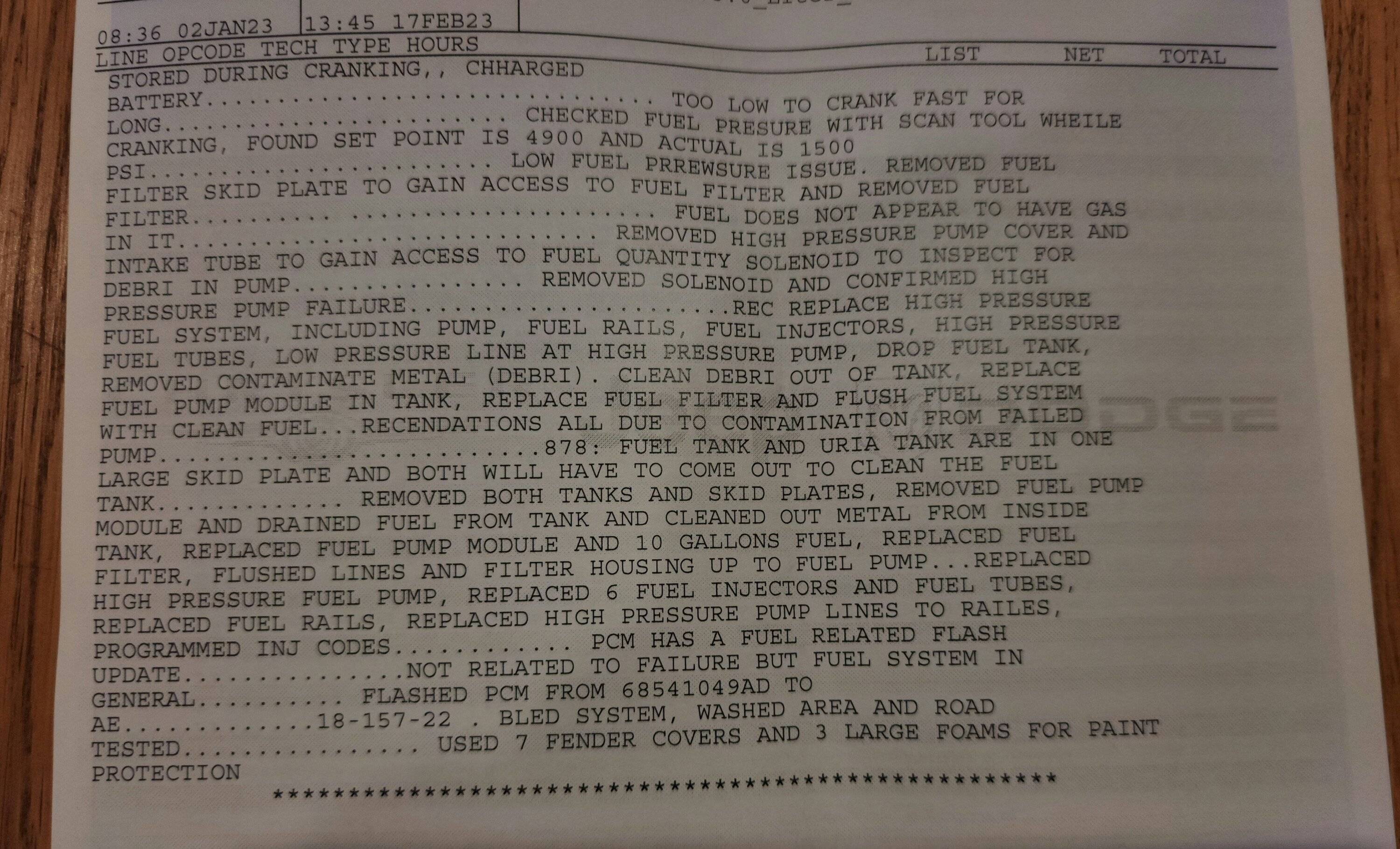

My jeep was in the dealer since Dec 31, 2022 for a blown CP4 pump. My Vin doesn't show up under the recall but the dealer confirmed that the CP4 went out and shot metal debris through the entire fuel system. The dealer finally got all the parts for the fuel system, including the replacement pump which was another CP4. Picked it up on Friday after about 45 days at the dealer and Saturday morning came back home from driving to the store to find my jeep pissing diesel all the engine and driveway. So it was towed back to the dealer and is supposed to be looked/fixed again first thing Monday. And apparently the dealer had their "master master tech" working on it. He even forgot to put the engine cover back after he approved it was completed and ready to be released.
Here is the write up if anyone is interested.
