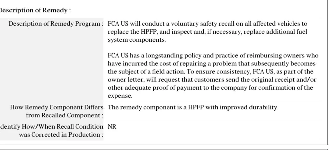

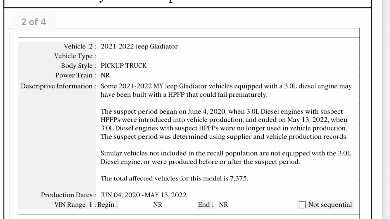

Production dates June 4, 2020 to May 13, 2022 effecting 7,375 units per the recall report attached to this post.
Bottom of the report states “The remedy component is a HPFP with improved durability.”

Why is it I have a feeling we were all hoping the remedy would be a cp3 retrofit…… reality is probably another cp4 :(
now here comes the roll the dice- do I trust the dealer enough to swap this out without dorking up more that it started with…..
Voluntary. Read sign this waiver signing away liability. Nope….
