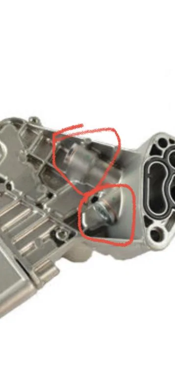

To summarize the last 12 pages : ).. It does not sound like a thermostat is going to fix this issue. 260+ oil temps and 245+ coolant temps is beyond where a thermostat would be fully open. Under low load the thermostat would lower the temps but while towing these engines are WAY past that at are 20-40 above fully open.
I agree an oil pump inline oil cooler would be great. Have someone cut a 1" block with all the o-ring groves to mate between the engine block and the factory housing. I attached a picture and you can see it would need some bypass ports. nothing too fancy. A few lines that come out to its own radiator and it would probably lower the coolant temps also. I have CAD and machine shop sources to do it but it would take more time than I can put into it. I'm not even sure if you spaces it off 1" there would be room.
Jeep Gladiator Diesel cooling options and ideas 692AC196-C431-4199-BB3A-16C5805EC616
I’m curious if we don’t already have access for an in-line oil cooler
