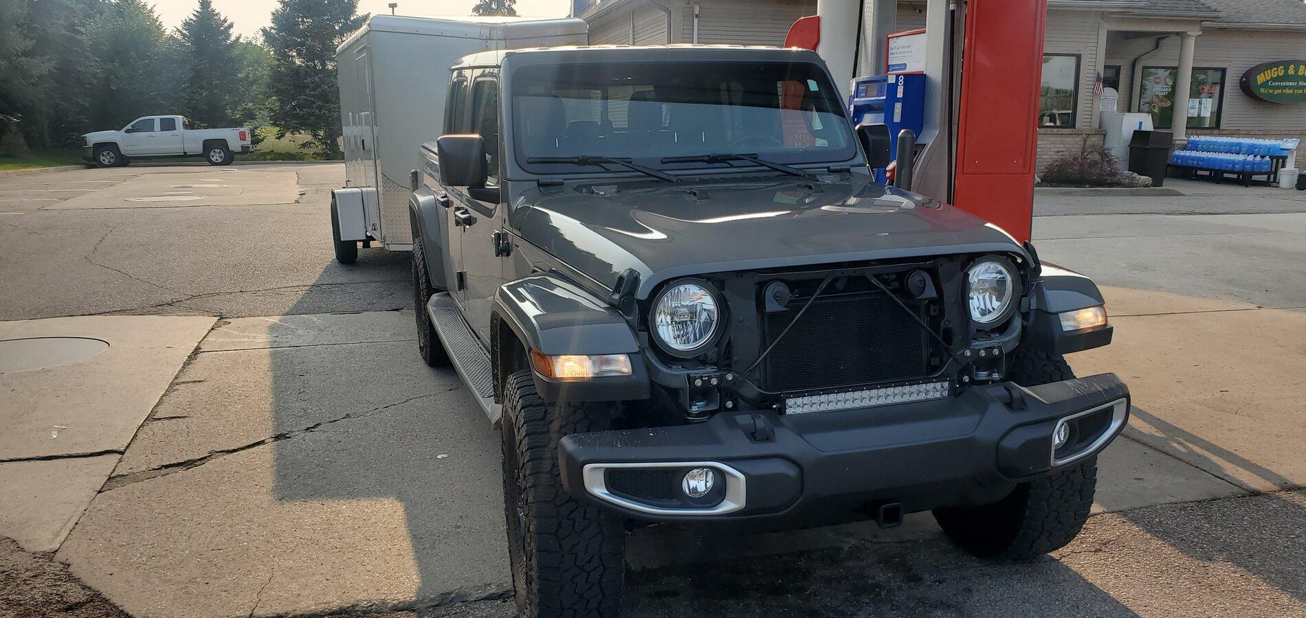

It finally got to 83 degrees today and I ran a 10 mile loop with my 6x12 cargo trailer, 3 times at 75 mph, temps were stable for over 5 minutes......
Stock setup/baseline engine oil temp was 240f. Normally I would only see 225 ish so I know it was working it a bit...... Sport grill with no bezels was 238 or 239 so not significant..... I removed the grill completely and got 232f.
An 8 degree drop while loaded is something to note but probably won't save you climbing a mountain, IMO.
I plan to do more test soon, Lol and remove the light bar.

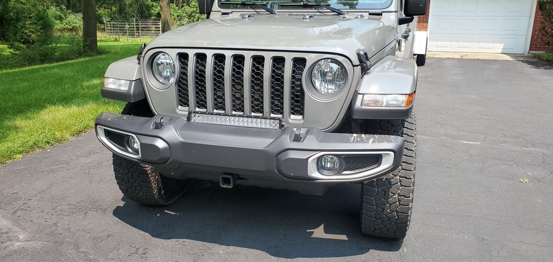

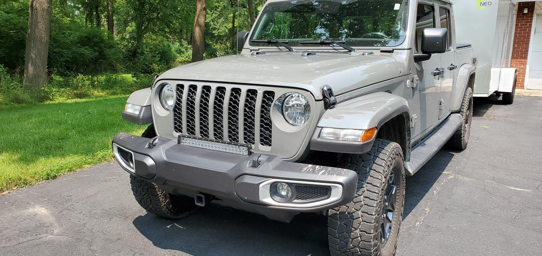

Well I just got back from driving several hours in 102 degree heat sadly I don't think the s&b scoops do anything and I even took the grill off to see if that made a difference and if it did it was very little,so my advice is save your money grills and hood scoops are not the answer
There is going to be a minimum temp the engine is designed run at. My experience says 225 engine oil, 210 coolant, and 195 trans. If you are not "working it" or well above those then the extra flow will not do much to lower temps. Do you remember where any temps were?

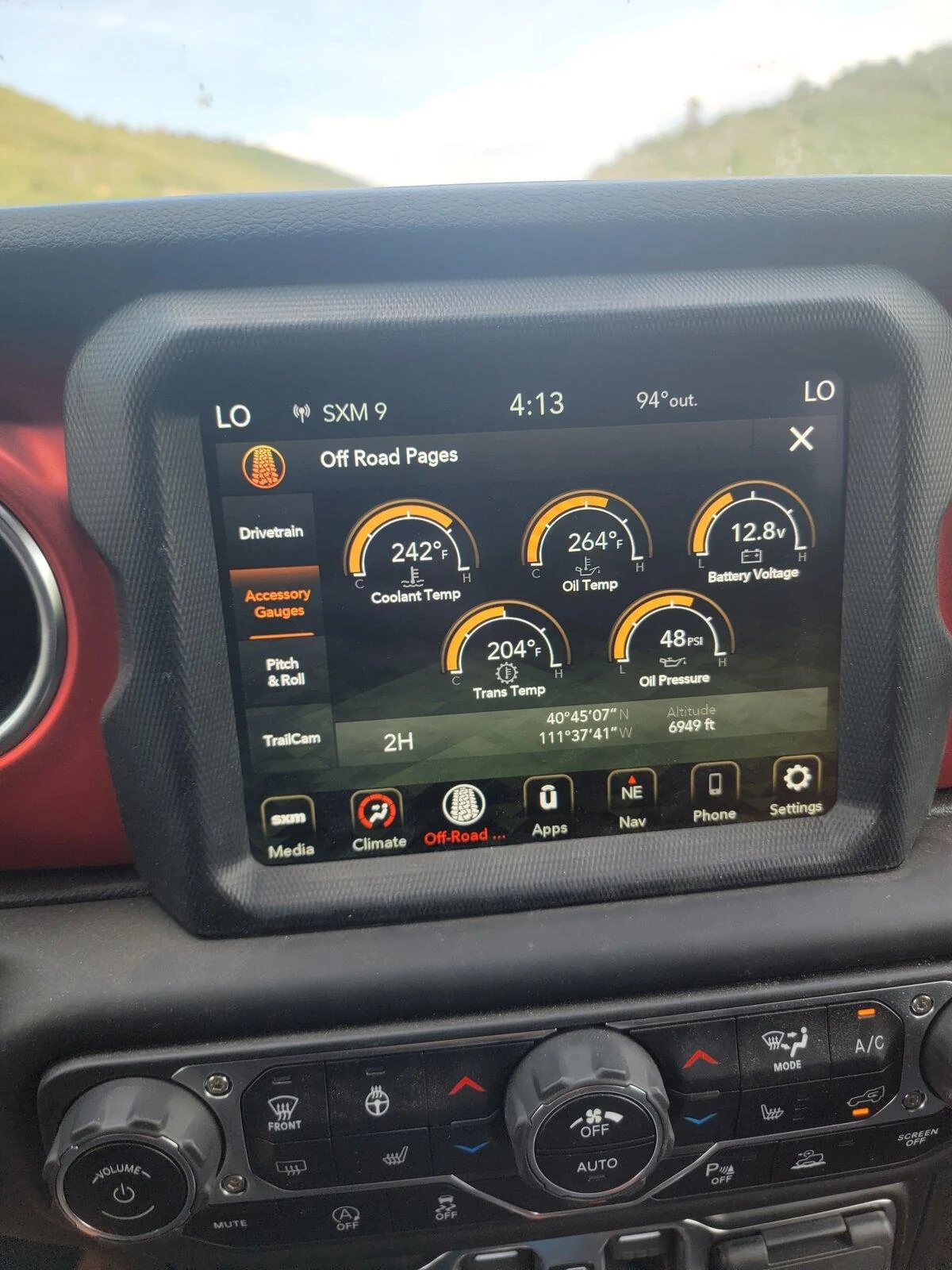

I did another run today during the hottest part of the day, 102 in Salt Lake City and I headed back up Parleys canyon.This time I pulled the steep grade with the Rubivon vents doing 75mph with AC full blast. I didn't get a load in the bed or haul a trailer like I had hoped. Parleys is a 6% grade for several miles.

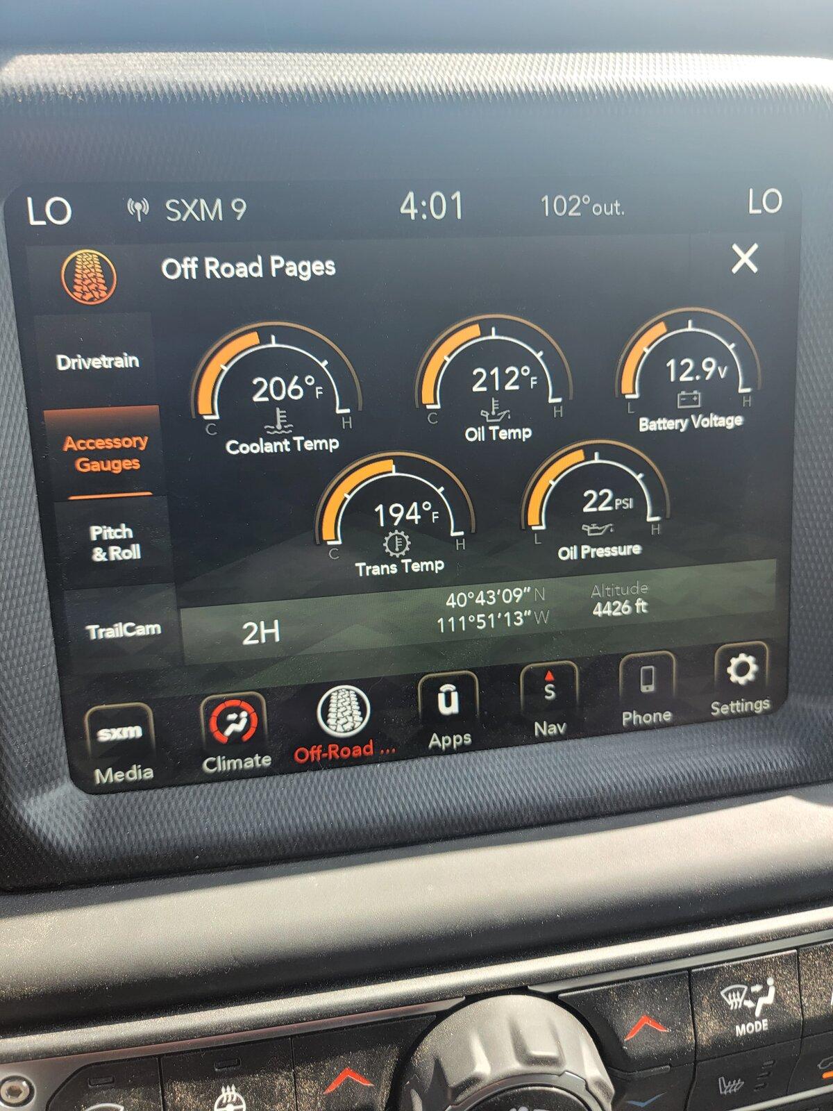

This is just hitting the freeway.
Jeep Gladiator Diesel cooling options and ideas 20210718_160159

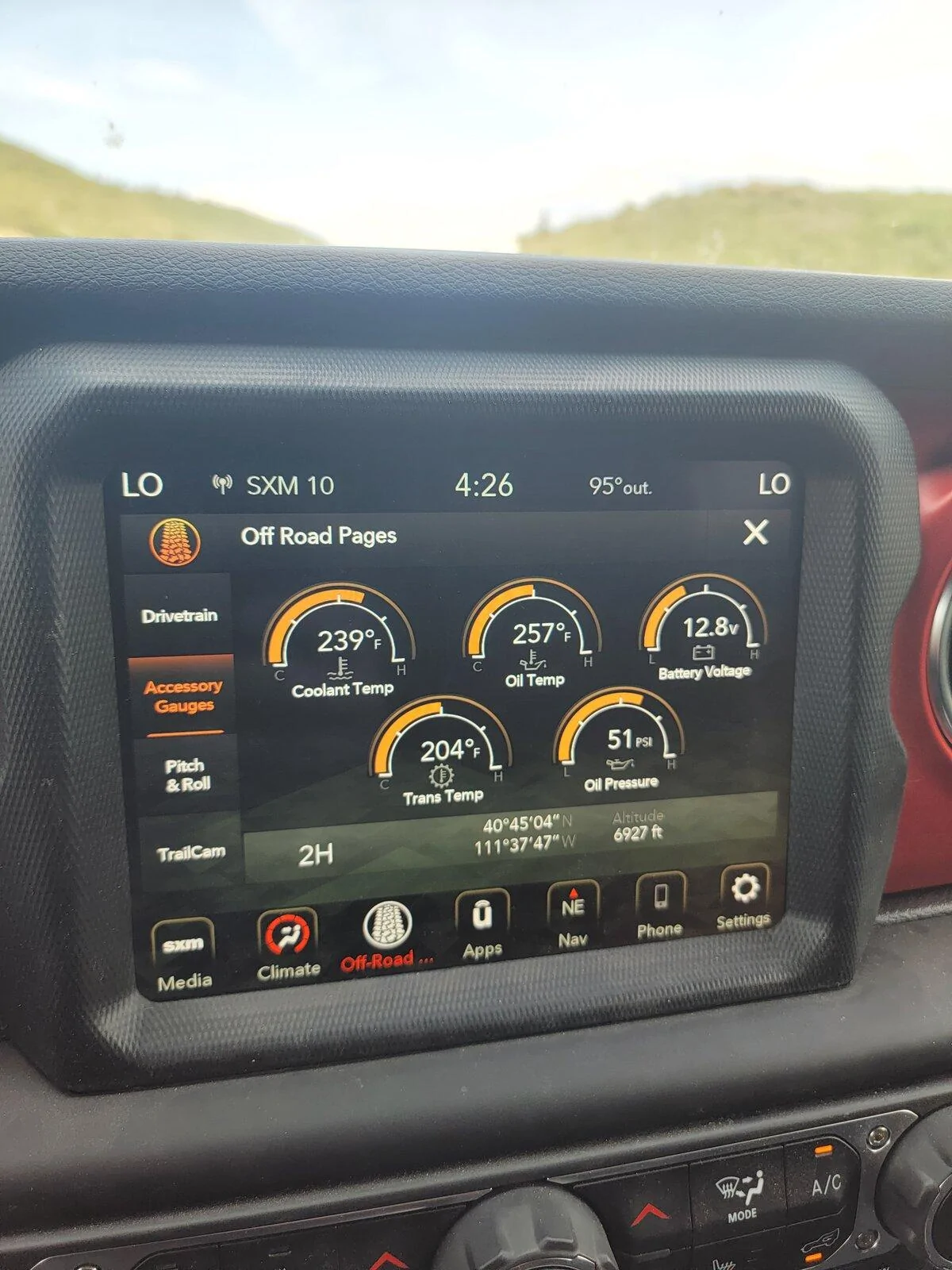

This was at the summit of Parleys canyon with Rubicon vents in but the hood blanket removed. Doing 75mph.
Jeep Gladiator Diesel cooling options and ideas 20210718_161353
This is the Rubicon vents completely removed. Doing 75mph at the summit again.
Jeep Gladiator Diesel cooling options and ideas 20210718_162622
Only 3 degrees difference, what is interesting is the oil temp had the biggest drop of 7 degrees and Trans temp stayed the same. I guess I won't be opening the vents and as others have said on scoops no big gains.
