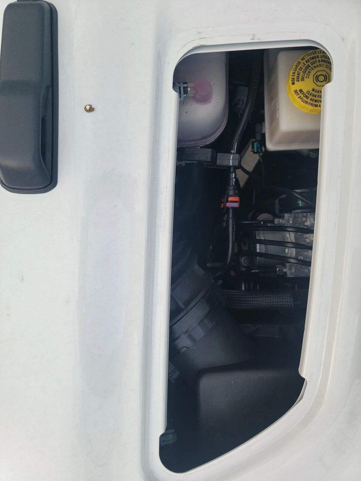

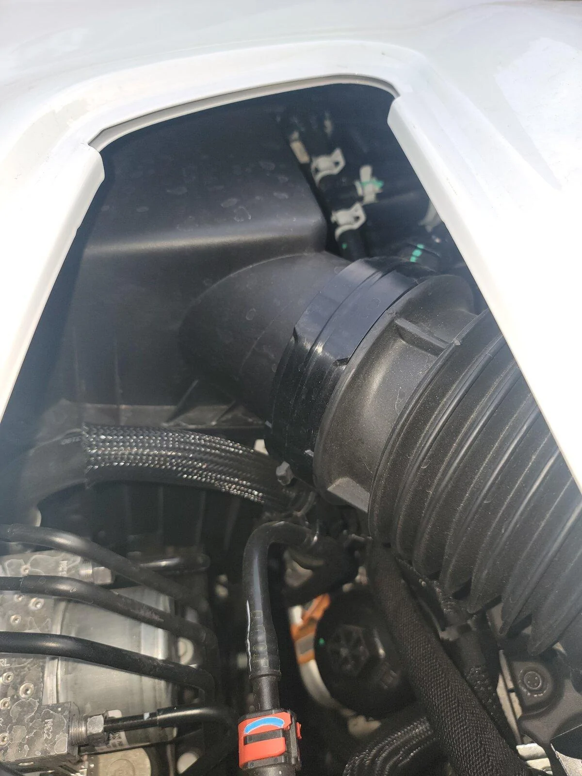

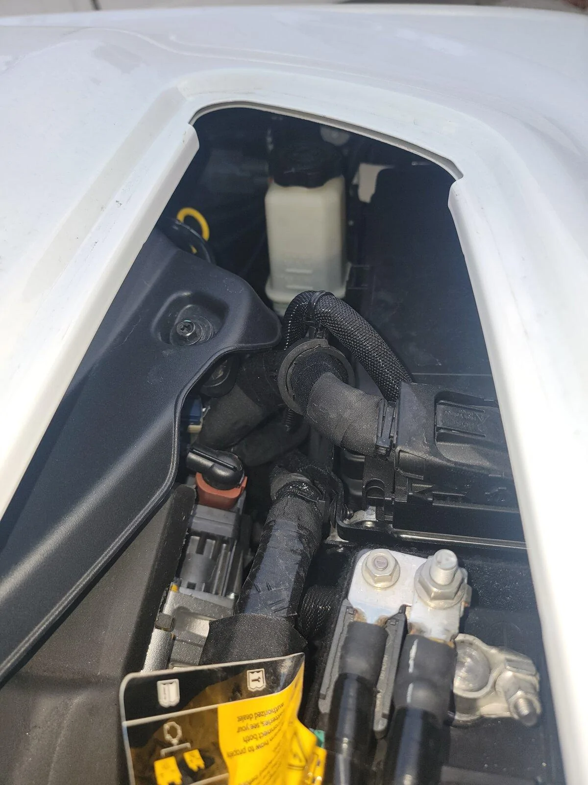

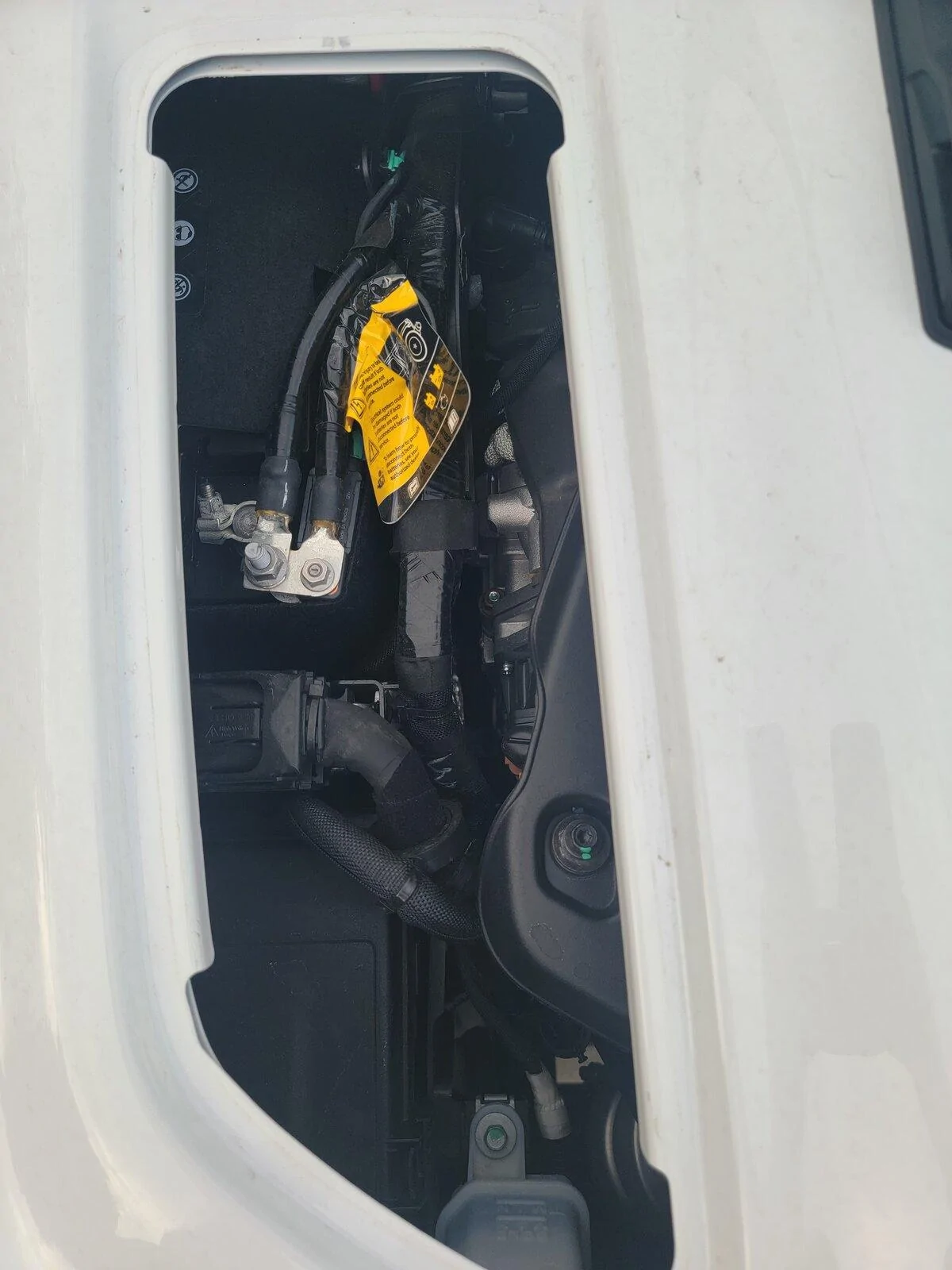

I took the insulating blanket out of the hood and the Rubicon vents and drove up Parleys canyon from my house in SLC to Lambs Canyon last night. Ambient temps were around 85 and I pushed it empty up the canyon from 70- 80mph as much as I could with traffic. I noticed about 5-7 degree difference and when I stopped or headed back down the canyon it cooled off much quicker. The major uphill grade is from Lambs to the summit. I ran out of time.
I want to run this test in the middle of the day and load up my bed with camping gear to put a load on the truck.
I am thinking of cutting the bottoms off the Rubicon vents if it will help. I noticed that the passenger side has a lot of electronics/ battery and I may leave that vent alone or add one s&b scoop to that side. The Drivers side has much more air flow and I noticed at idle that a lot of heat was escaping out the open vent.
