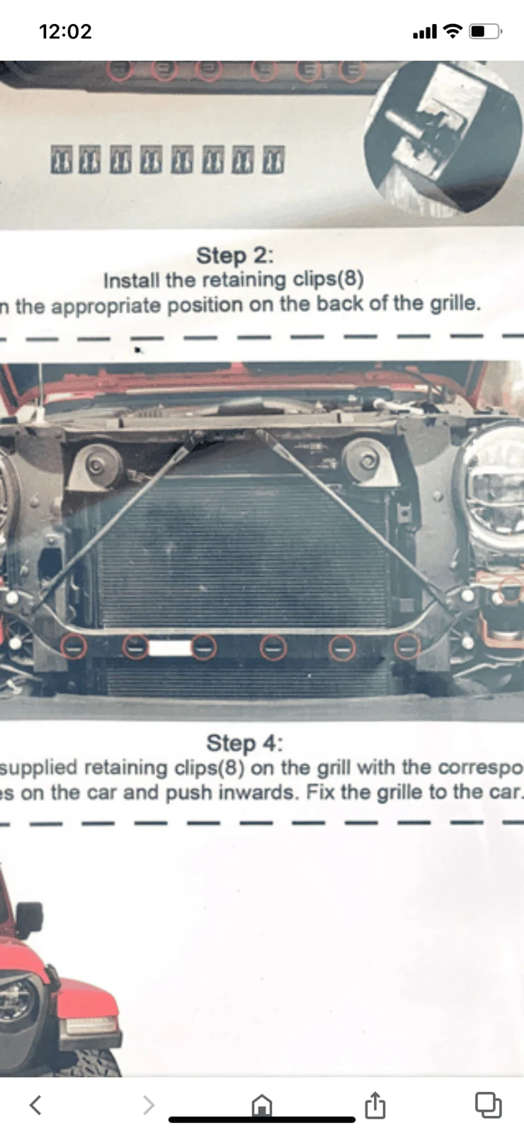

I am still not sure about the horns, do you have a picture?
Not a great picture but it will give you an idea.
The horns cover a little over a third of the trans cooler and then the portion of the radiator behind it.

Wow, the actual horns :facepalm:, my bad. I thought it was the metal support bar with the red circles.

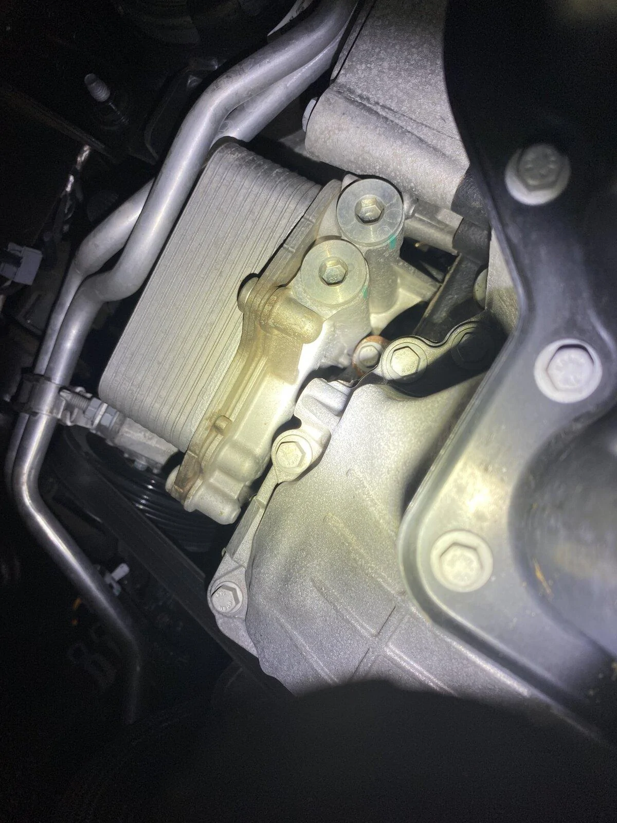

I believe, the bypass filter/ports to it is what controls the amount of oil flow. I suspect the ports into the bypass filter housing are smaller reducing the flow amount forcing the bulk of the oil to stay it's designed course.
Basically if you tapped into the oil pressure switch you would get as much flow as the oil pressure switch port size allows, which is likely more then 10%. The challenge lies in balancing flow enough to not starve other parts of the oil circulation system.

Two other port at the base of the oil cooler, May be possible access for a remote cooler
