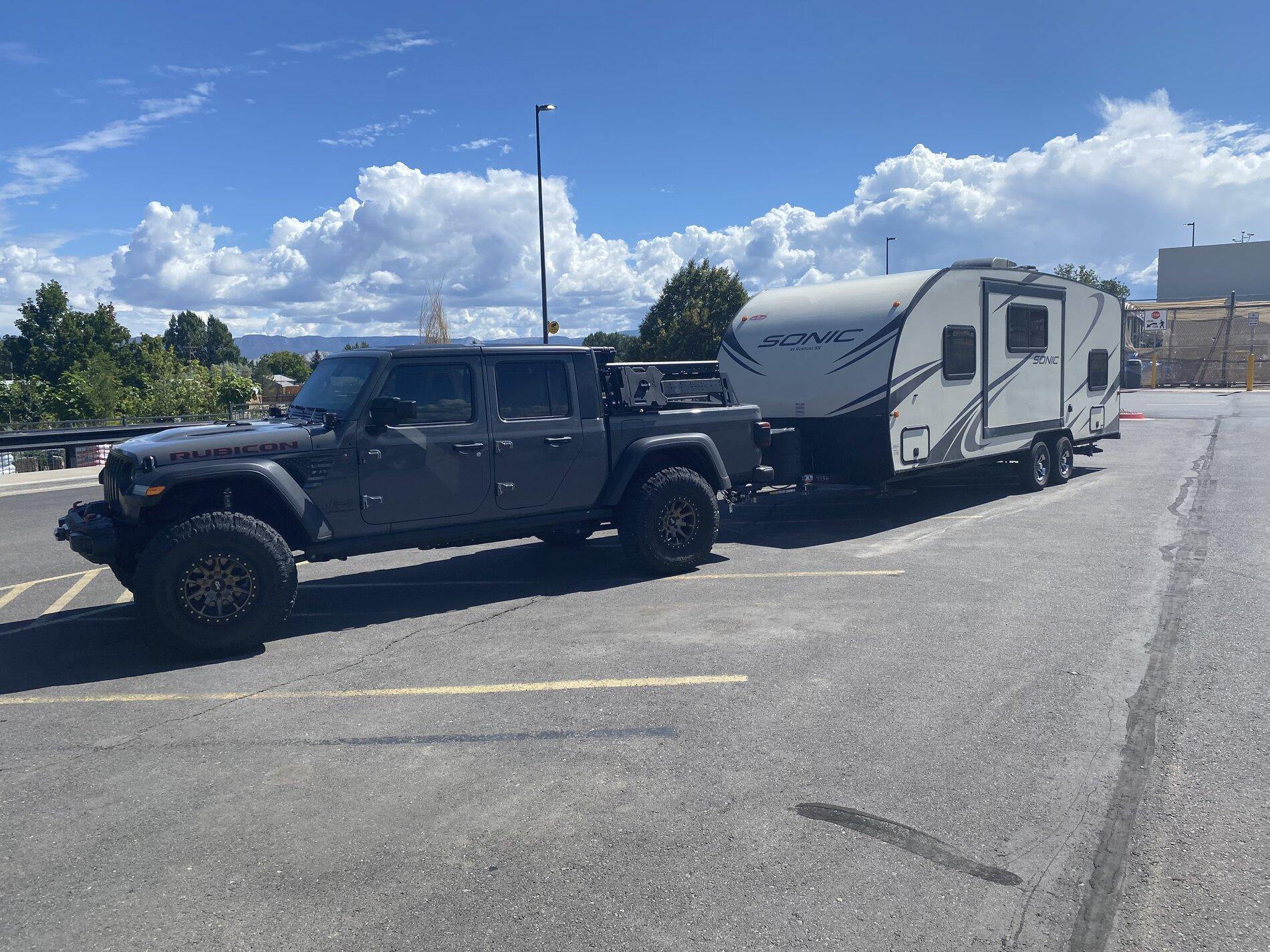

Just rolled into Montrose, four mountain passes down one more to go. I have been turning my fan on manually once oil reaches 240*. No derates today. The changes I made seem to be working, granted it’s only 75* ambient out.
How fast do you tow that on flat grounds? Maybe you could do a flat fixed speed with the fan on and off to see how much difference there is.
How fast were you towing up the grade? Also in the flats? and how are you manually turning the fan on?
