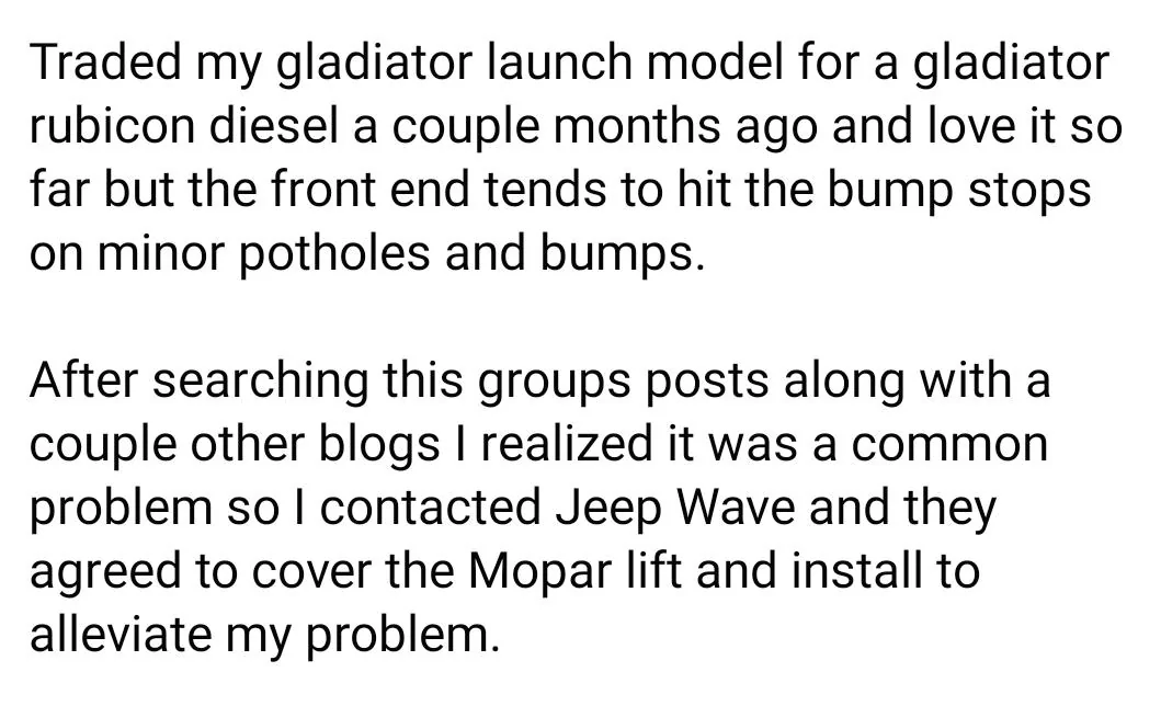

Jeep Gladiator Eco diesel Suspension bottoming out on normal roads SmartSelect_20210923-150539_Facebook
Saw this on Facebook, (who knows if he will end up getting it covered)may be worth checking into if you're having similar issues.

I wish I knew if this was true....... I went through ALL the hoops for Jeep Wave/Care and put the factory shocks on the front with no fix.. Their response to me was there is no solution case closed.... PISS POOR customer service for the TOP of the line off road vehicle.
If this so called Jeep Wave covering the Mopar 2 inch lift and install we all need to get together and request the same!!!!
Zoom call? Teams call? Need to find a person at @JeepCares who actually CARES! Not just the same bullshit case closed answer I got too. F'kd up!
