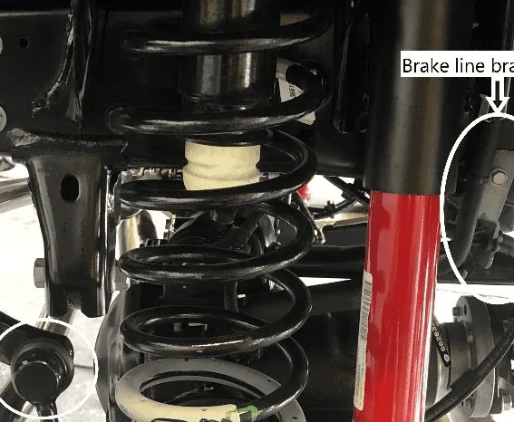

I assume you are talking about this little guy? This is what came from the factory on my JTRD. It looks like all the other pictures I have seen too. Is it possible the Teraflex instructions show a pic of their bumpstops?

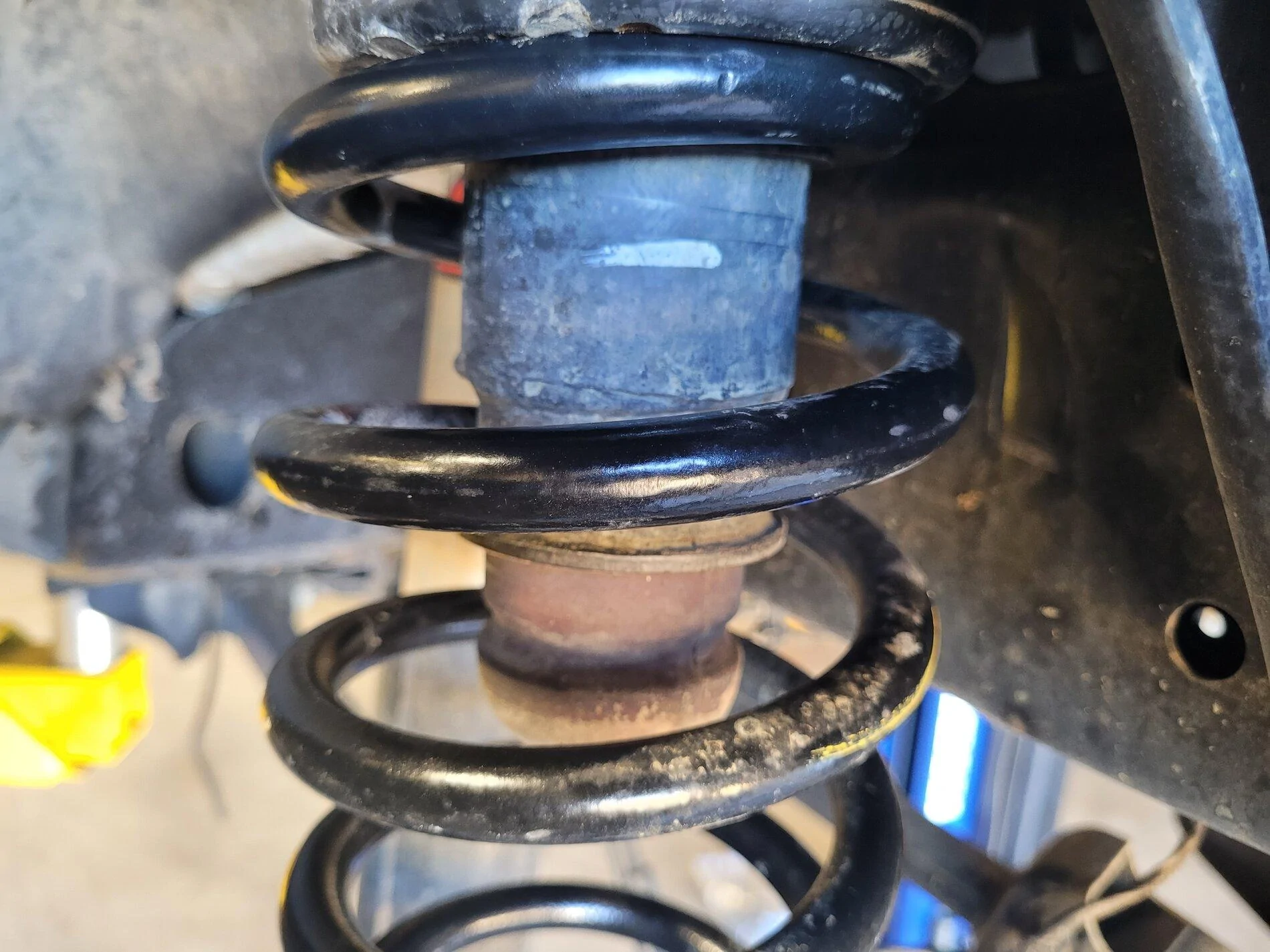

So thats what my diesel came with also, but the original JT bumpstop looks like this:
https://www.quadratec.com/p/mopar/f...zYyCVzKv5EhrmO0r8e84unsijj8x2k6EaAuRaEALw_wcB
and this is what it shows in most installation instructions i have found:
Jeep Gladiator Eco diesel Suspension bottoming out on normal roads 1633032127462
Jeep Gladiator Eco diesel Suspension bottoming out on normal roads 1633032250636
The diesel bumpstop looks to be super short before it hits the metal cup.

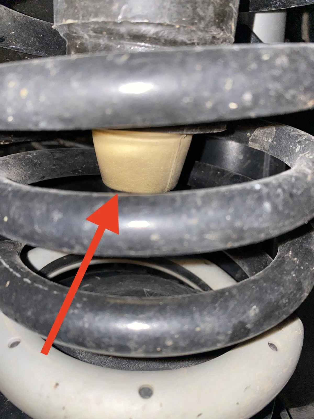

no bottoming out on my diesel. I assume you must be hitting a really big dip or bump in the road to have it bottom out.....Looking at my rig there isn't a lot of room between the bump stop and where it would bottom out....but no probs so far.

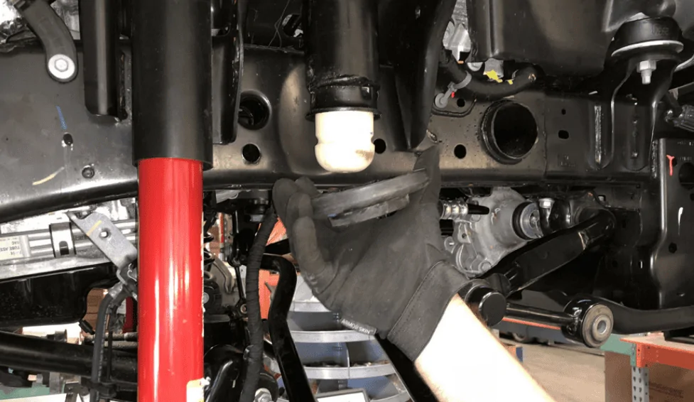

Yes, the 2020 Rubicon I have in the shop today has a much larger bump stop like pictured above. Much larger than the tiny gumdrop I had in my Eco Rubi
can you post a pic of your front bumpstop?
