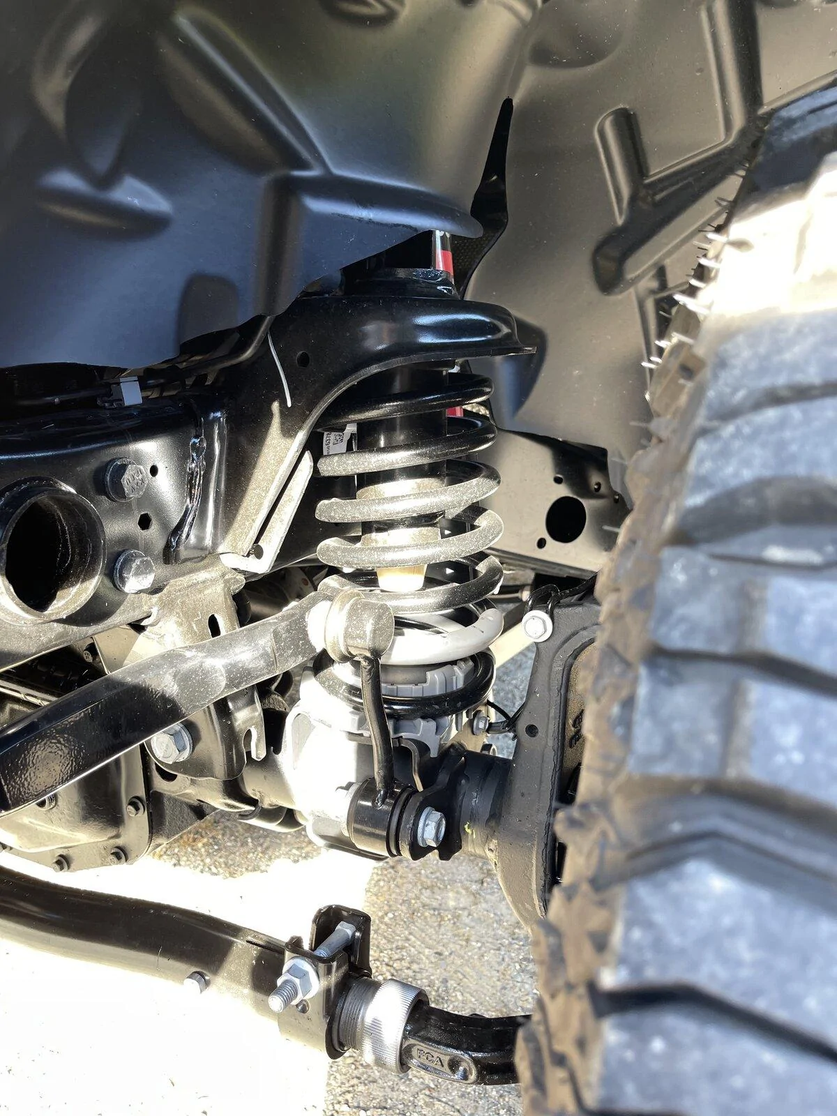

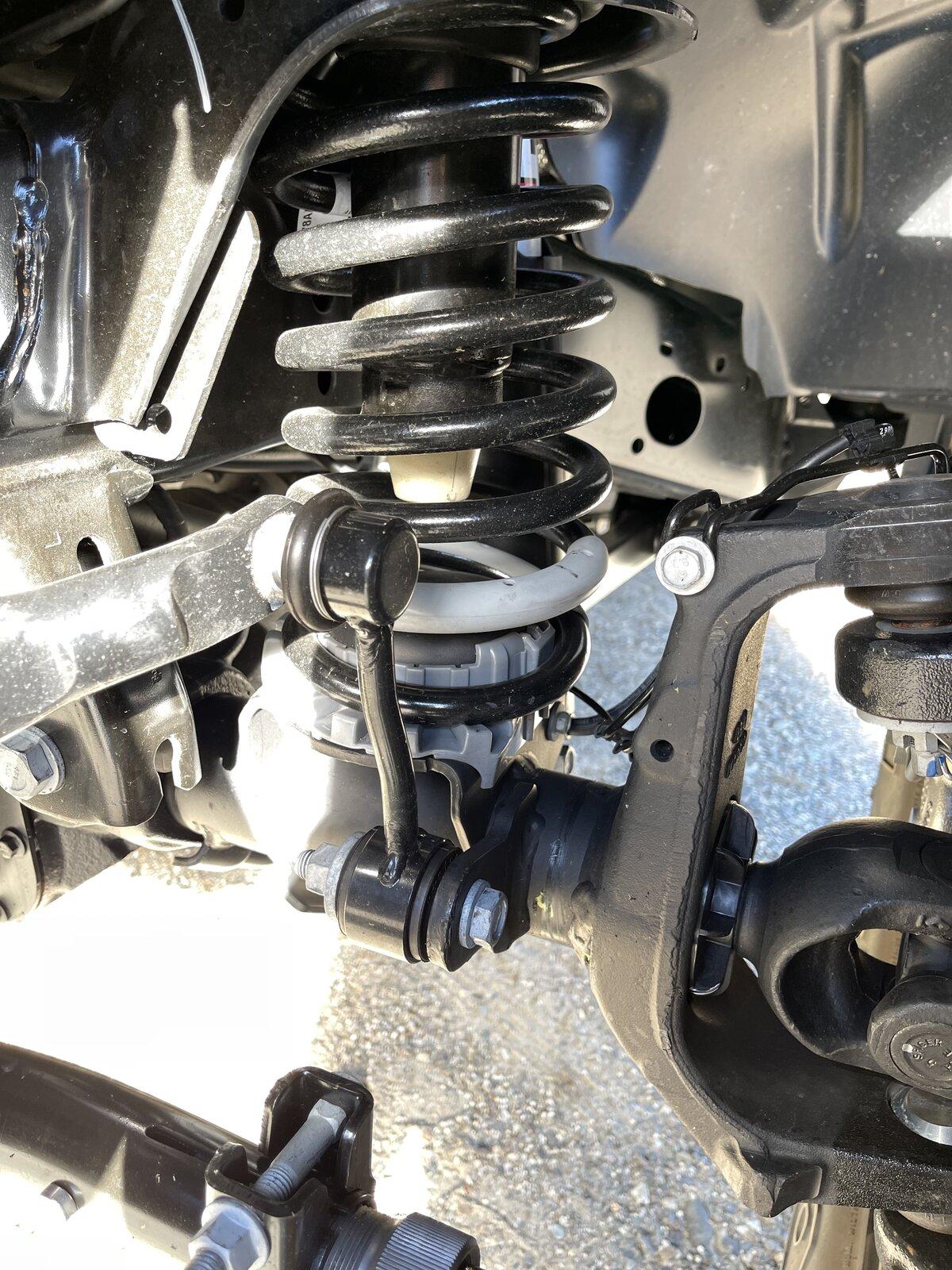

Here's a couple of pics of my JTD springs and bumpstops in the front......about 3" before hitting.

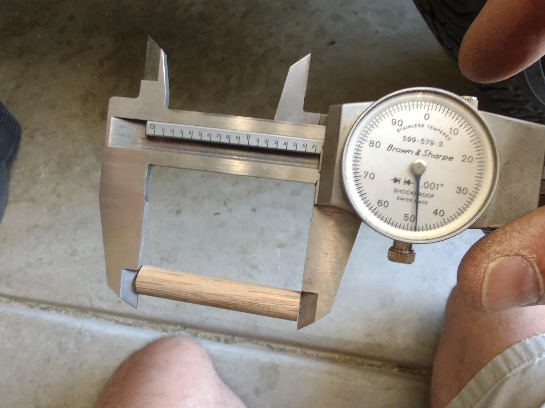

Hell I've only got 1" 3/4 on mine. I can get mine to bottom out at 7 miles an hour over a decent sized speed bump. It's just a Sport S Ecodiesel no mods except a rack on the back. That dowel was in-between the bump stop and the bottom pad
Jeep Gladiator Eco diesel Suspension bottoming out on normal roads IMG_20210614_121829291
