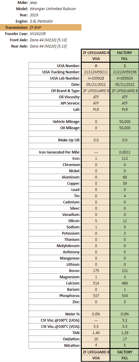

The "critical" lab results OP posted are here. 906 ppm iron, 662 ppm copper, and trace amounts of glycol which typically means we measured it but it was insignificant. That's what all this is about and for literal wear metals in every transmission, those numbers are a complete joke.
Here's a ZF 8 speed UOA that I just pulled off the JL Wrangler forum:
Jeep Gladiator FCA Canada voids transmission warranty for using AMSOIL. ZF8_VOA + UOA
112ppm iron and 39ppm copper at 50,000mi on a healthy transmission. Kinda seems like the lab got it right and you are making baseless claims here.
Those numbers you want to see. That’s now the 3rd other lab report I’ve seen for the ZF transmission. My copper and iron levels prior to doing a flush (yes, this is my mistake I’m fully responsible for) are death numbers…did I mention, prior to the flush.
