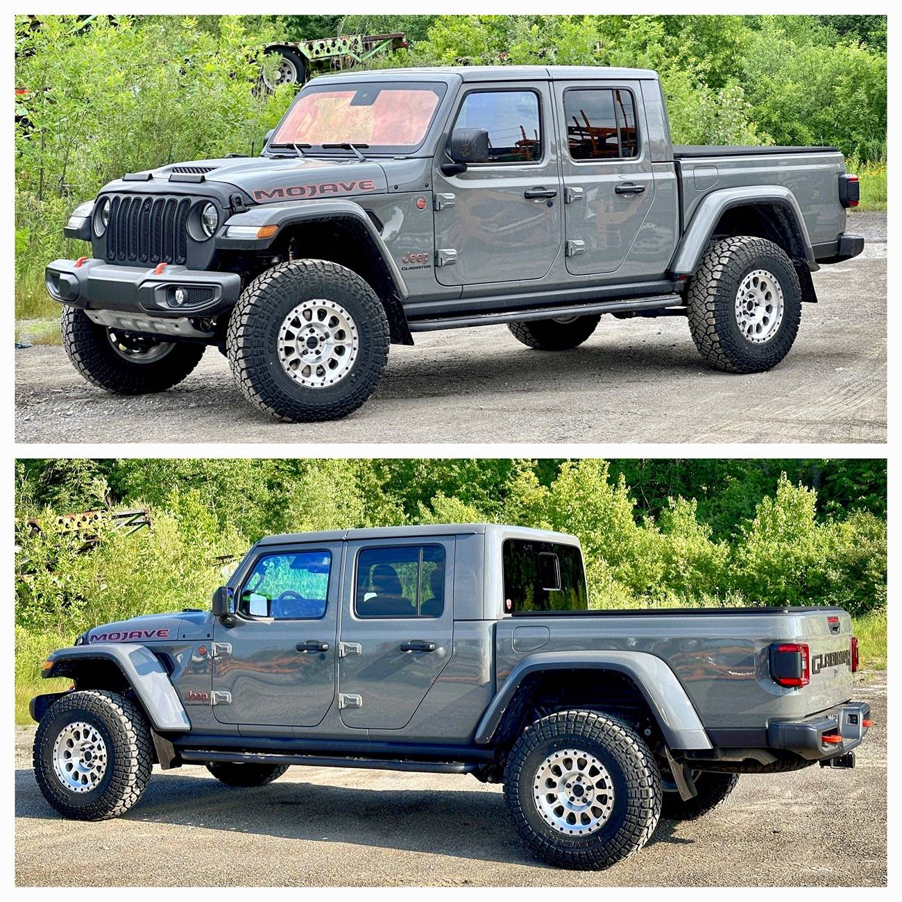

I wholeheartedly agree on the 4.56 gearing.
I put 35x10.5x17 Kenda Klever R/Ts on 17x8.5” and 0 offset Method 315s (wheels - 27.82 lbs.) the day after I brought home my self-ordered 2022 Mojave.
I have no actual Jeep comparison (first Jeep).
I also run 255/85R17 Mickey Thompson Baja Boss A/Ts on base/OEM wheels (winter).
35K miles and I still have not re-geared and probably will not here in S.E. Michigan.
