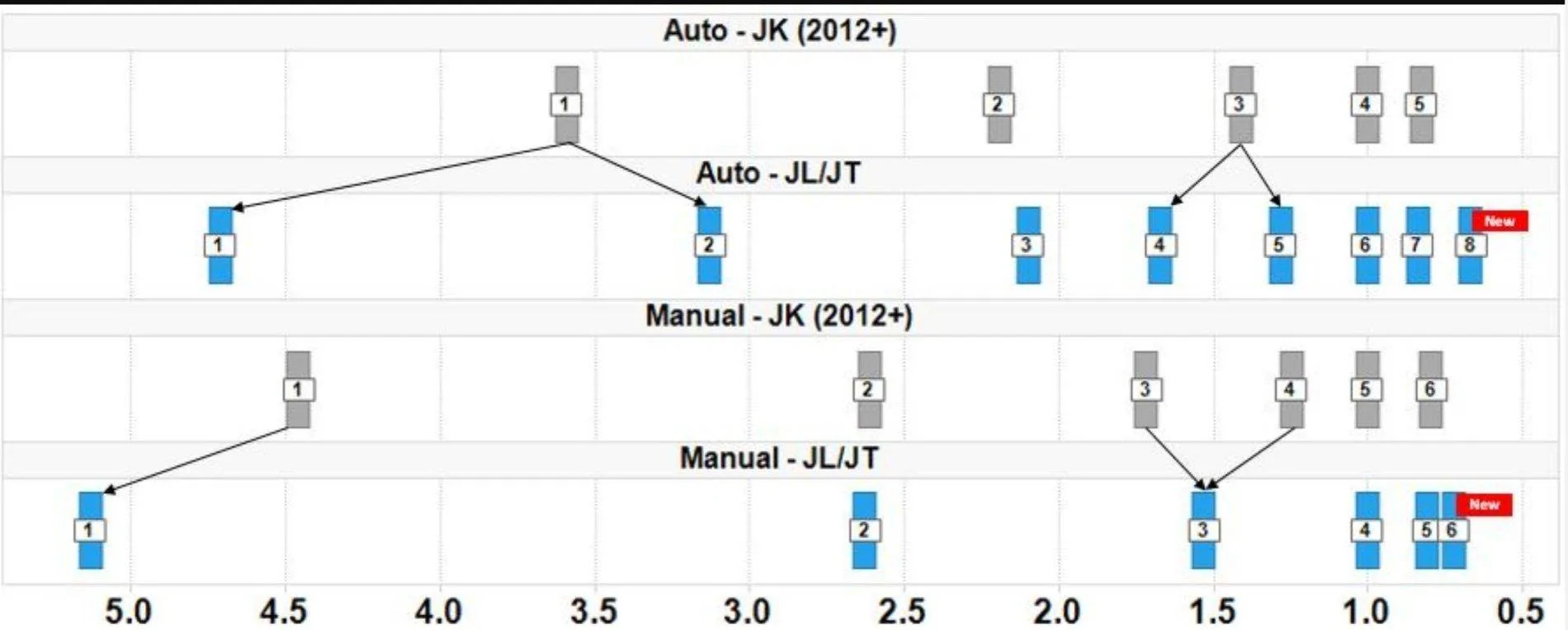

Going through this thread, seeing a lot of people gear hunting while on larger tires.
Jeep Gladiator Mojave should come with 4.56 gears 4.10s dont cut it 1737963876248-zj
This is an image I pulled from another thread.
For the JT, 6th gear sits at a 1:1 ratio. Has anybody thought about even locking the TC at 6th gear instead of letting it hunt to 7th and 8th without even being able to hold it?
Reason I asked is on my Tundra, with 4.30, I locked the TC in 4th since it was a 1:1 gear ratio. Sure the revs were sitting a little higher, but this at least allowed me to not feel as sluggish sitting on larger tires.
Thoughts?
