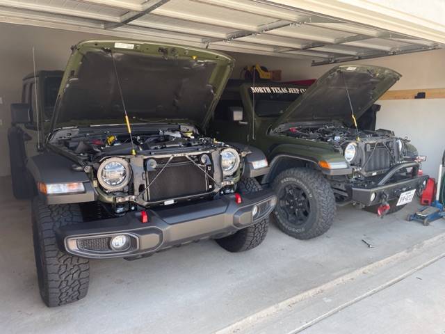

Add me to the list.
Threw a fuel system lean code today which is a precursor to the pump failure. The code cleared itself but the pressures aren’t right. I swapped for a 2023 Rubicon gasser. Less headaches and wondering if today is the day.
The dealer paid full rate for mine and knocked $14k off the 2023. I’m swapping over all my goodies tomorrow and will drop the other off on Saturday.
