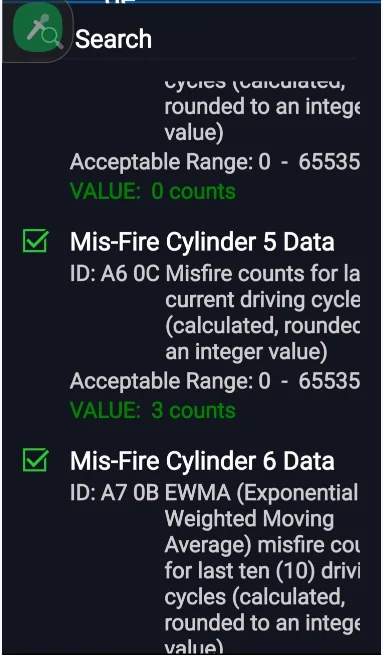

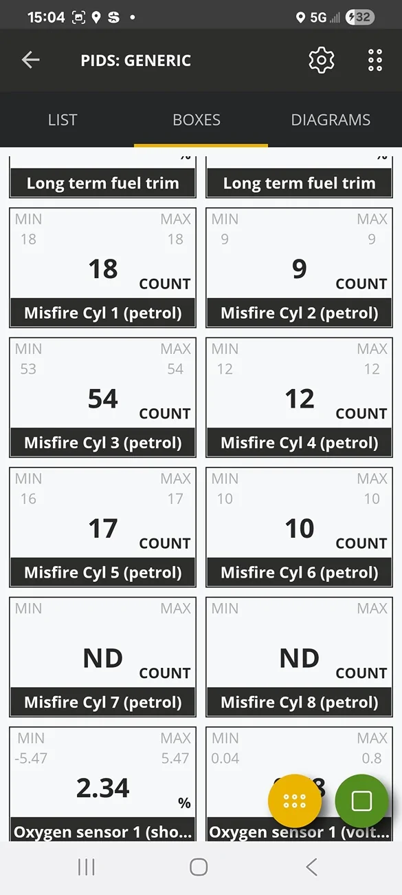

What do you consider excessive? This is not a case where we're saying 2+2=5. 1200 misfires in Cyl 1 in less than 10 seconds is excessive. 20 misfires in 30 minutes isn't.
If it doesn't throw a code, no one can help you at the dealership, basically.
There are many things that can cause misfires, ranging from bad gas to valvetrain failure. People here told you which solutions to go through systematically. I gave you a very easy diagnostic test to perform that would ID if the issue was "the big one" for the 3.6L and you've ignored it.
