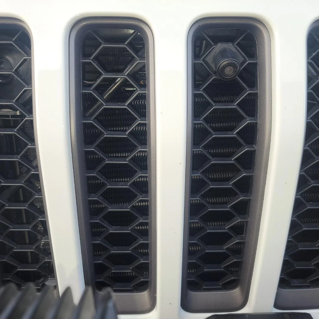

It's been a while since I posted in this thread. I went and used insane diesel oil filter kit and tied in an oil cooler and place it in front of the radiator. It added 2 qt of oil for total capacity to the system. Since I'm on 40" tires and on 4.88 gears at 85 miles per hour on the highway It frequently climbs oil temperatures to 246ďľź. However after Installing the oil cooler and filter, I have not seen oil temperatures go beyond 234ďľź and that is under heavy load. Therefore I have seen a temperature decrease on EOT of at least 12ďľź by using a bypass filter.

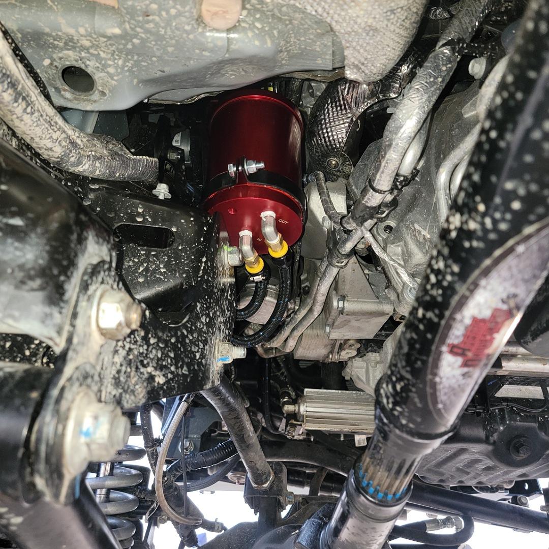

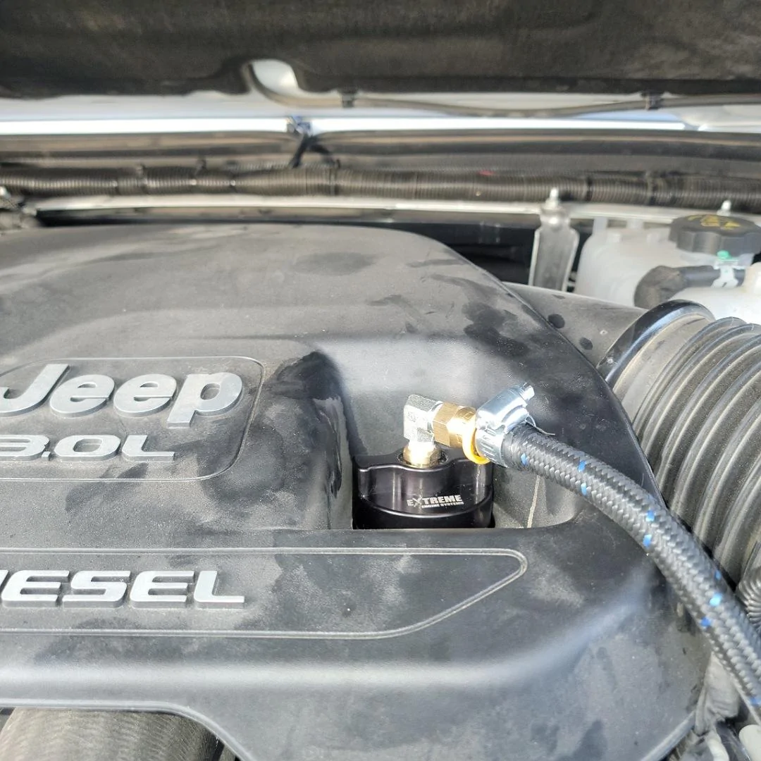

I'm not going to do a detailed write-up because unless you're comfortable with fabrication and if you know nothing about working on your own truck, then you shouldn't do this.
For the DIY crowd, I'll write some notes and give some links to how we did this. Overall, for the DIY crowd (you are DIY if you are willing to install your own lift kit, drill and modify brackets, etc), this is a minor project and should take you no more than 3 hours.
Main part of the kit and installation is here:
https://insanediesel.com/pages/ecodiesel-3-0l-bypass-oil-filter-installation
This is a kit by Insane Diesel, which is generic and meant to apply to all 3.0L EcoDiesel vehicles (GC, Ram, JT, JL). For the other vehicles, there is a bracket that provides an easy bolt on solution. However, due to space constraints, there is no direct-mount option in the Gladiator.
If you decide to tackle this project, I suggest you have a vice, hammer, drill, and have experience with mild fabrication, and some patience.
  1. Buy this kit:
    https://insanediesel.com/collection...gler-3-0l-ecodiesel-bypass-oil-filtration-kit
    Add the Filter Cap and an extra roll of hose. They can provide all of that.
    Also, purchase this generic bracket:
    https://insanediesel.com/collections/brackets/products/cummins-uth-bracket-only-1999-2013
  2. The instructions I posted above document the MOPAR part # of the oil filter you need. Order it online.
  3. Buy this cooler or something similar. I chose this to fit between the grill and radiator.
    https://www.amazon.com/gp/product/B08KGJQDZ6/ref=ppx_yo_dt_b_search_asin_title?ie=UTF8&psc=1
  4. Once the equipment is in, open your hood and look down the driver's side towards the motormount. The motormount has 2 bolts. Now, look at the bracket. You're going to have to drill a new hole in that mount to fit the spacing of the bolts in the motormount, but also "clock" it a few degrees towards the fender.
    Now, crawl under the vehicle and lift the mount in place and have a helper mark where the holes will go from the top. Then, drill through the mount.
  5. Pull your motormount bolts, go to the hardware store and buy Grade 8 hardware that's 1" longer so you have room for a nut, washer on top & bottom, and you will sandwich in the bracket on top of the motormount with this new hardware.
  6. Mount the bracket. Wait on the filter, you'll want to run all of your hoses to it, then mount it as per Insane Diesel's instructions and then route them to the Filter Cap, Oil Cooler and Oil Cap that come with their kit.
  7. If you followed their instructions you are now done with the installation. 70% of the install is their standard install. The only thing you did is plumb in the additional cooler in front of your grill with an extra length of hose and you mounted the can in your own way.
  8. Now, I suggest you pour 1 qt of oil in to the engine, run it for 3 minutes, then turn it off. Wait 5 minute and then check oil level. You are likely ~1 qt low and adjust accordingly. Don't pull the oil cap off while running as this is a return line now and so it'll dump everywhere.

We lightly dusted the silver oil cooler with black spraypaint so it blends in behind the grill more without affecting its ability to cool.
Also, removing the filter is actually very easy. We left enough slack on it so you can remove the 1 bolt, raise it up and down and it's ready to unscrew.
Since the filter lasts 15-25k miles, that's every 2-3 oil changes, so for most people it's a once a year pull and swap. We did a mock swap and it took 3.5 minutes.
