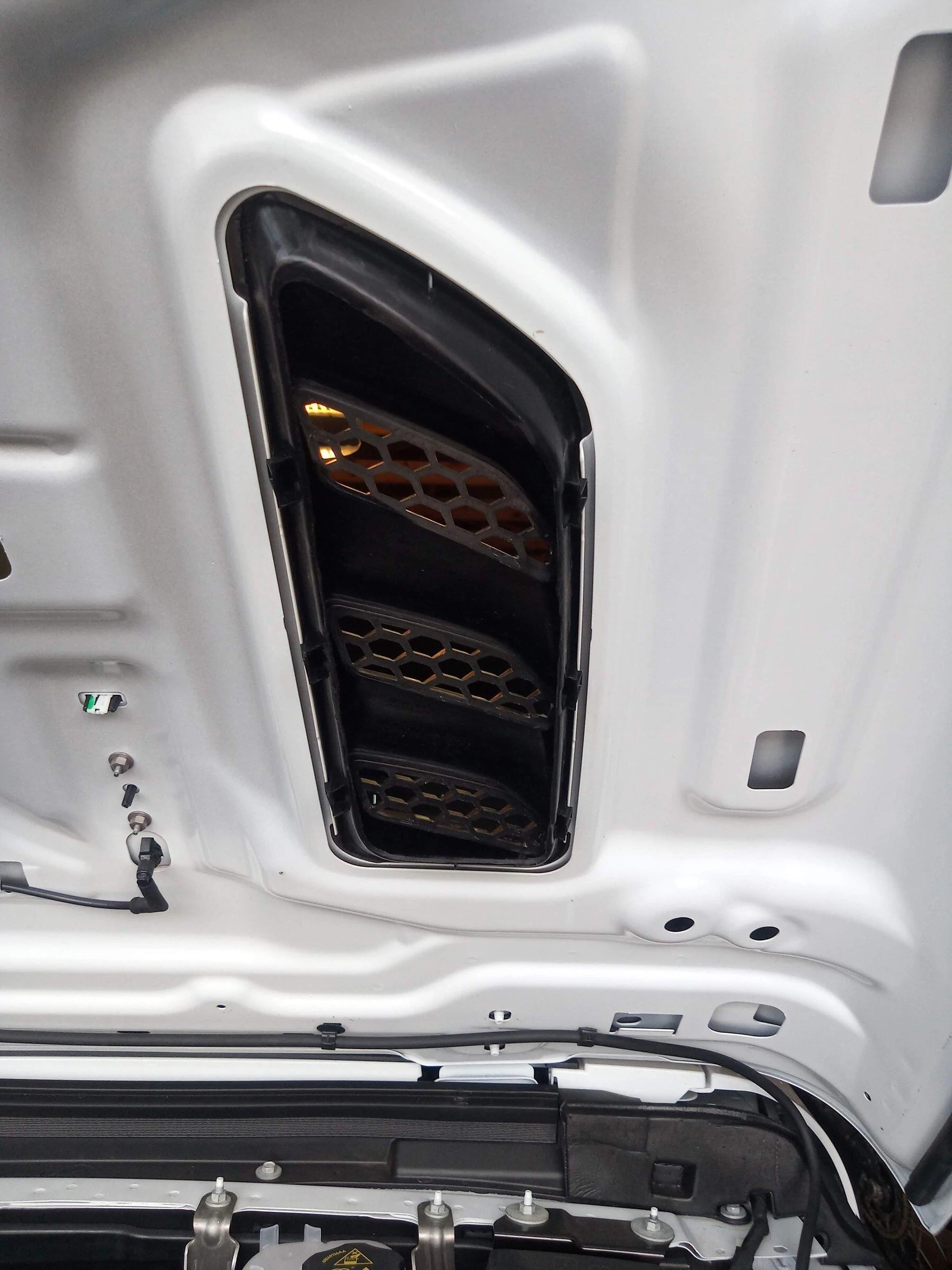

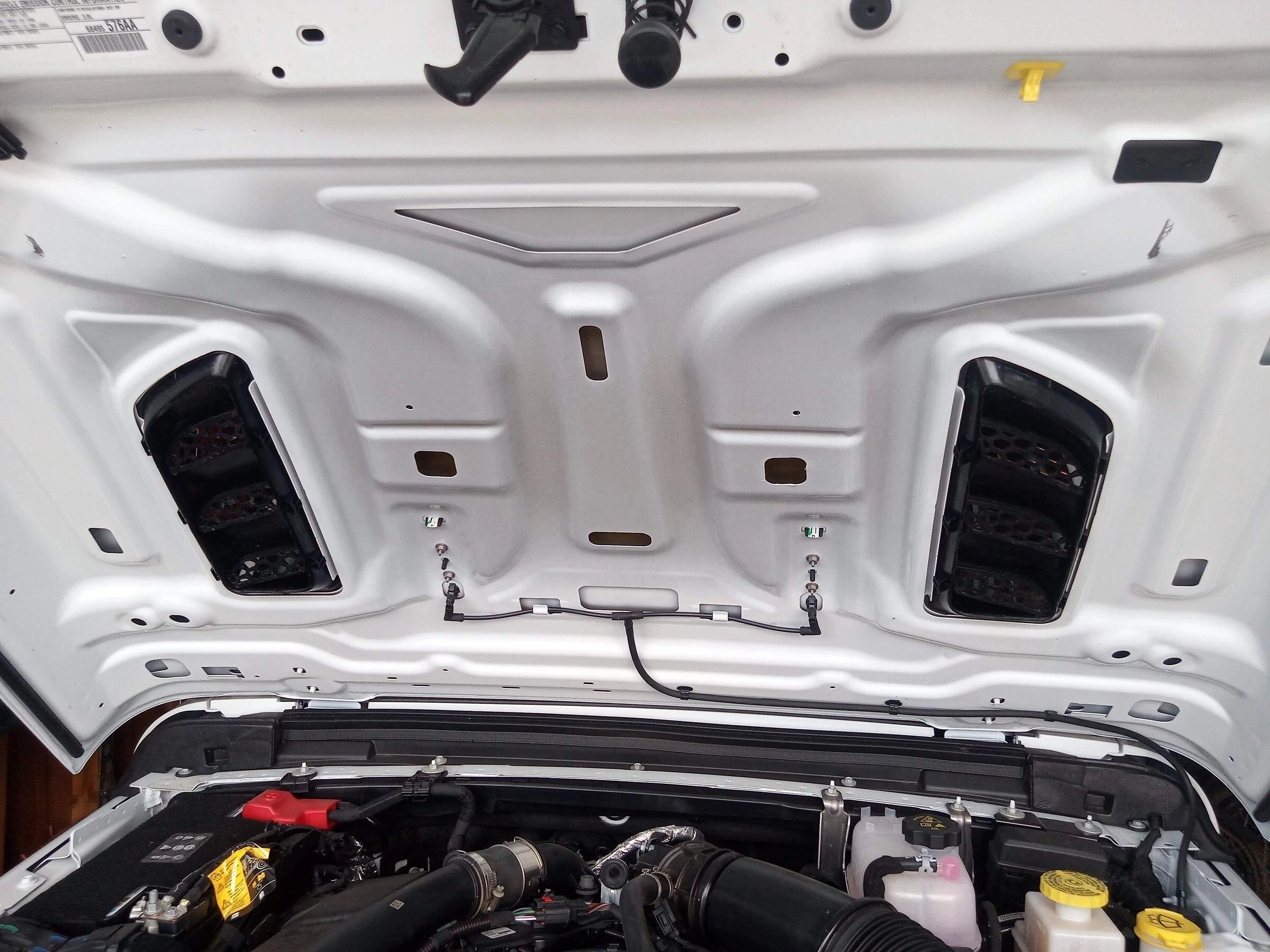

I was at the dealer for a test drive and lifted the hood on a new JL 392, the hood vent is large and active with intricate duct work that delivers air to the engine intake. That hood was extremely heavy! Wondering if we could use that hood on the JTRD with a underhood mounted oil cooler right where the air comes in, directed through the cooler?
-Also could mount and plumb an auxiliary cooler.
-Could we 3d print active vents to replace the Rubicon fake vents? We could print ducting if there is space for it.
-How much room is there between the hood and engine cover with the hood shut?
I haven't taken delivery of my truck yet, so its hard for me to figure some of the clearances out.
Deleted member 22728
Yes, that hood is EXCEPTIONALLY HEAVY...thus the "prop rod as a third hand" technique will produce an unsatisfactory result. In any case, the last 392 I built had my brain-case juices flowing...as to a cooling retro for the EcoD.

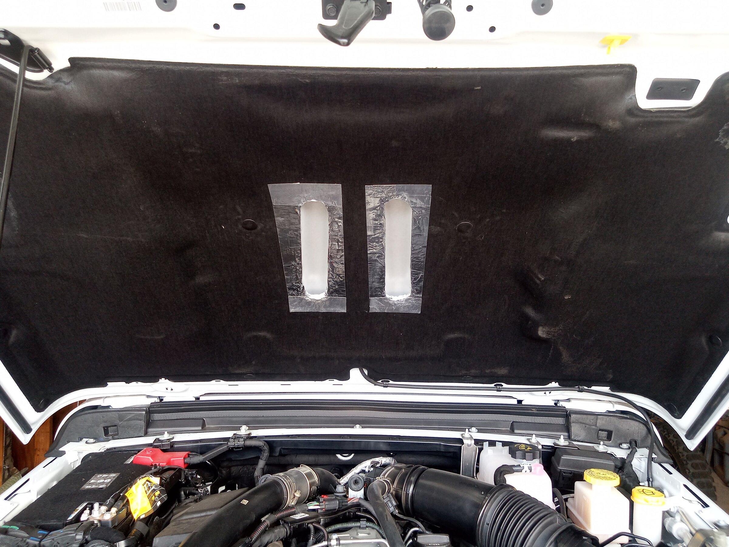

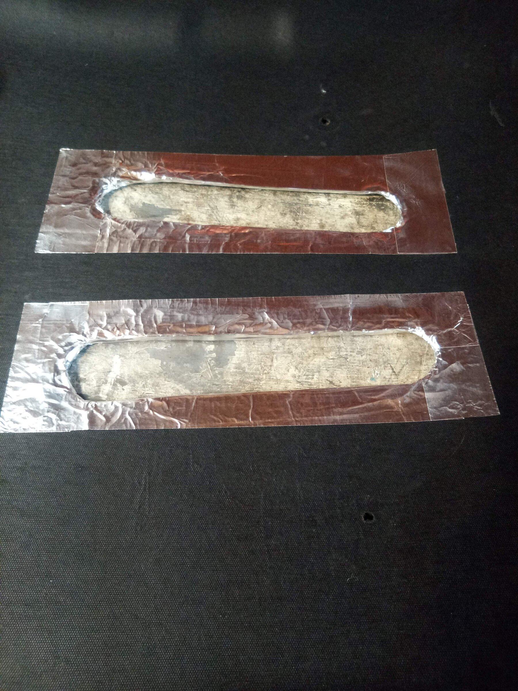

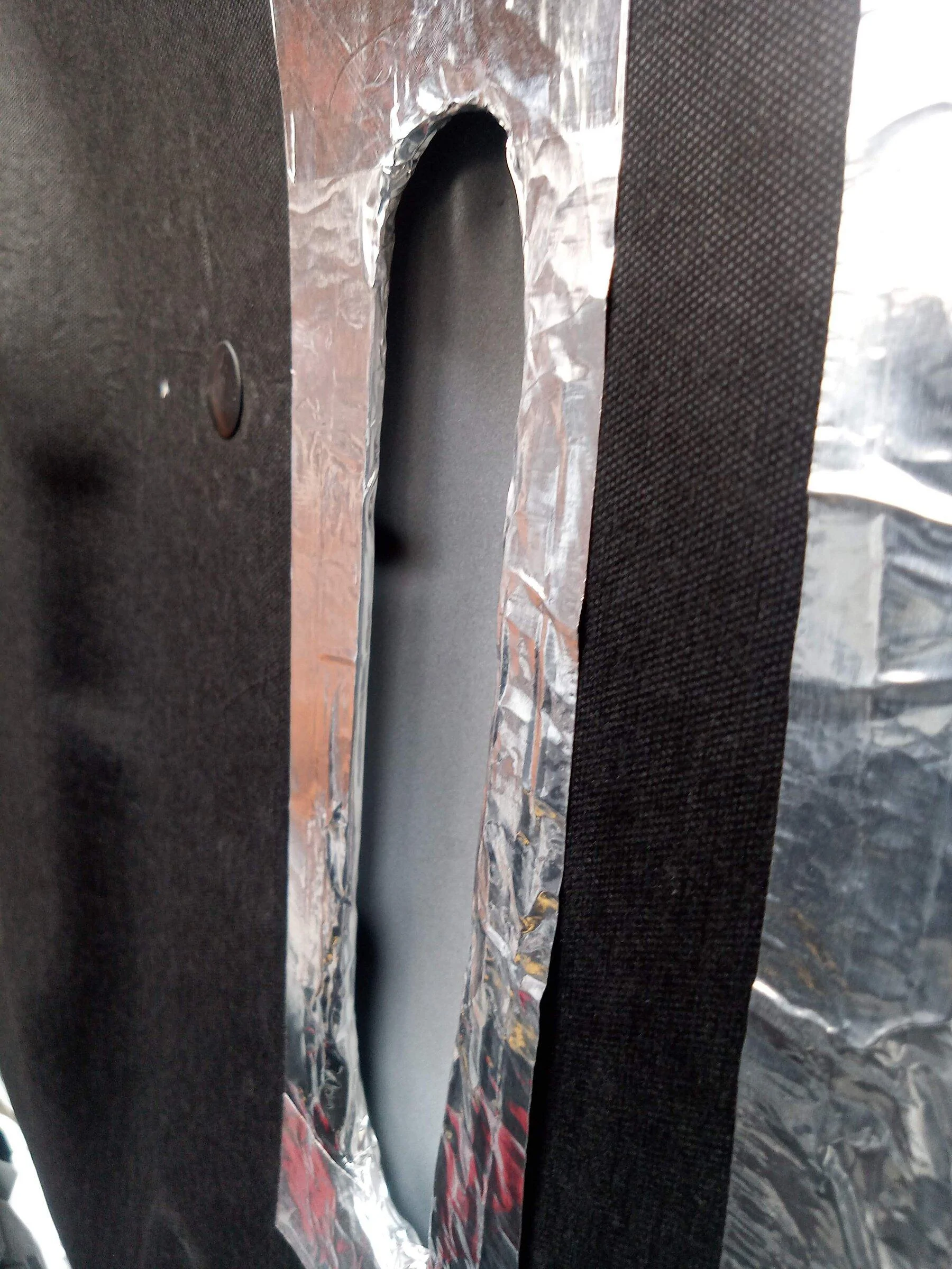

rharr
May 6, 2021
29
2,025
2,772
Tucson, AZ
my thought was to cut out the bottom of the hood vents fully you get full grill access, and cut a 3" wide by like 18" opening into the center of the insulation in the middle of the hood.
My thinking, was any water that runs though the vents will dump on the insulation and run off to the side, and any heat in the bay will rise up and get pulled out the gap between the insulation and the hood through the now open vents.
there seems to be enough gaps and channels on the underside of the hood to allow air to flow while insulation is in place.
Jeep Gladiator Diesel cooling options and ideas IMG_20210627_141616
Jeep Gladiator Diesel cooling options and ideas IMG_20210627_141607
Jeep Gladiator Diesel cooling options and ideas IMG_20210627_140831
Jeep Gladiator Diesel cooling options and ideas IMG_20210627_140818
Jeep Gladiator Diesel cooling options and ideas IMG_20210627_140813
https://www.jeepgladiatorforum.com/...rating-as-temps-rise.45447/page-2#post-739384
