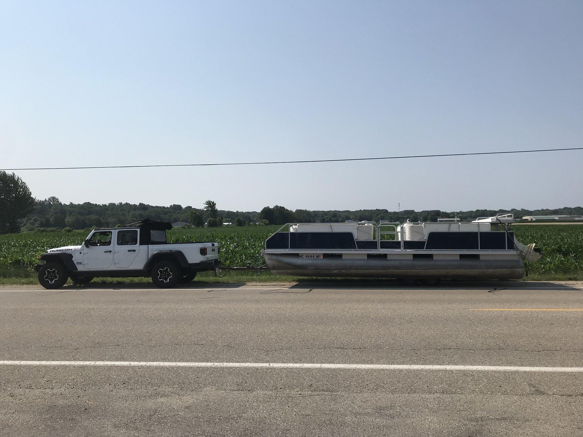

I love my diesel.
I’ve had (4) 3.6L - great engine, I just don’t like driving around at 4000 rpm.
I tow 4,000lb all the time with no issues. I love the 3.0.
Be SURE you drive both the gas & the diesel.
