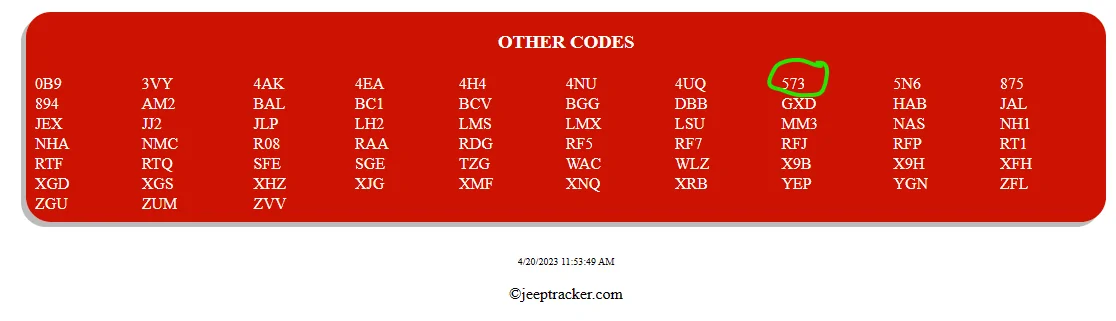

Just got notification of a 573 code. Anyone know what that is? ha
I was just going to ask you the same thing. Same code. Something is happening.

Sorry, vehicle build codes for our orders. Something is happening because we both have manual trans trucks on order (ordered the same day, same story and dates of regression and all). But the jeeptracker.com app just alerted both of us that a new build/sales code was added.
The only thing I have been able to find other than people just wondering what that code means
https://hdrams.com/forum/index.php?...order-tracking-waiting-room.11481/post-223837
"573 is Sales Distribution Tracking" whatever that means... maybe we get a new build date or something soon? Sounds like someone is at least looking at our orders or something is progressing. Hopefully we get a build date soon because our orders should be some indication of a fix becoming available for this recall.
