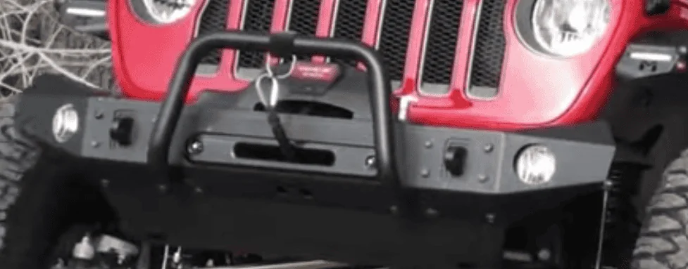

@fourfa I'm going to have a MetalCloak frame-built bumper, essentially, this:

When I was looking at bumpers, I wanted something that I liked the looks of, would let me keep the factory fog lights, and still be solid, and frankly, the MetalCloak just seemed like the best bet for the price.

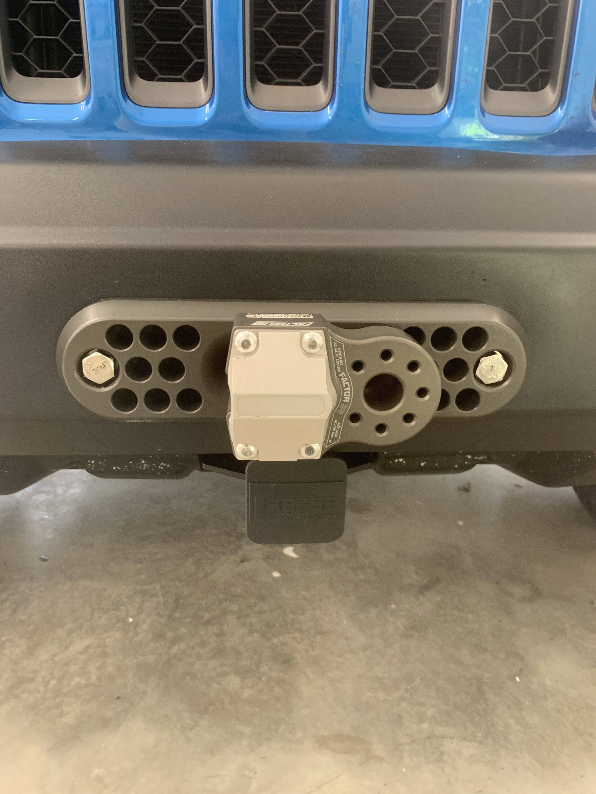

The UV on synthetic line was a major reason for mounting my winch inside the bumper, I went as far as to get the line protector from Factor 55 to protect the line at the attachment point from dirt and sunlight. There are a lot of winch attachment products that cover that little piece of line bent around the thimble at the end of the line ……Jack
